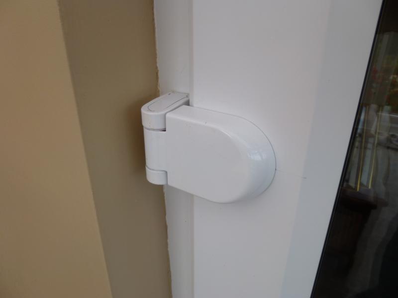

Does anyone know where I can buy some 'offset' upvc door hinges?
My French door opens to 90 degrees then comes up against the wall end to which it is attached. Is it possible to get an offset hinge so that I can open it to the 180 degree position.
A pic of the current hinge leaf(s) would help identify the most suitable match, as there are so many to choose from.
Do you want brass, steel or s/s, pvc coated or other?...pinenot :)
Hi, I am looking for white Coated hinges.
The current hinges are shown in this photo:- [GALLERY=media, 62560][/GALLERY].
But as you can see in this photo :- [GALLERY=media, 62561][/GALLERY] ] , when the door opens 90 degrees it comes up against the wall.
There fore I am looking for an offset hinge that will allow the door to open 180 degrees. I know they are available for wooden doors but would like to know if they are available for upvc doors and where I might get them.
Hope someone can help.
Thanks for that, now I can say fairly confidently you'll struggle to cranks matching those, so it's now time to look at the alternatives.
Are those plastic covers on the door leaf (you can normally lever them off with a chisel or similar)
Is the wall return that the hinge cover touches when the door is opened, possibly capable of being reduced? would you consider local reduction i.e. at each hinge position?? Is the wall plasterboard or plastered to the hard???
It may be possible to get hinges to work, but I think it will required a fair bit of fine work, would this suit you???? ...pinenot :)

You'd need a hinge with the hinge pin about 4" away from the door somewhere near the corner of the plaster in order for the door to open out around the wall, in 23 years i haven't seen such a hinge for a pvc door
