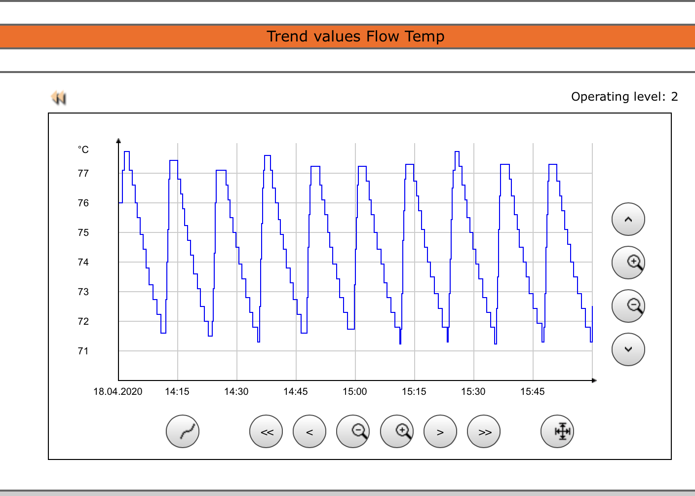

Hi,

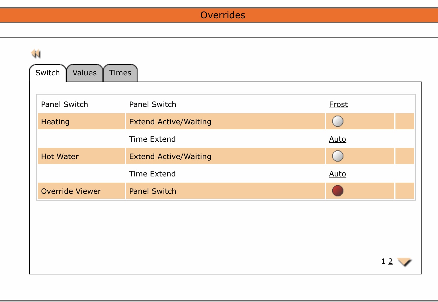

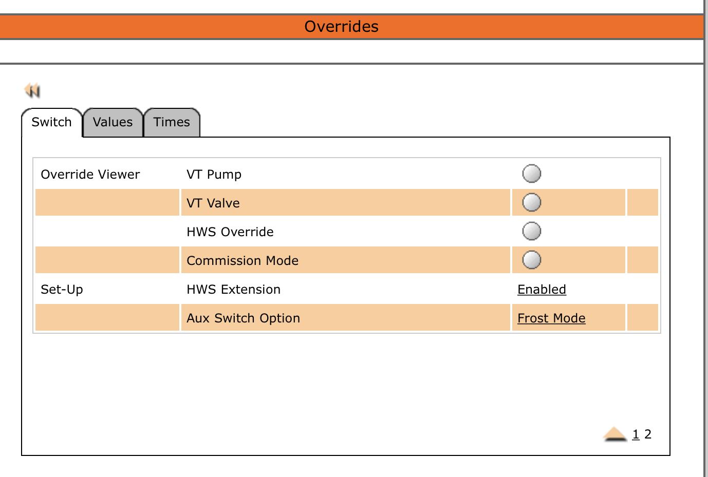

We've relatively recently bought a house with a DDC420 controller and are struggling to understand some of it's behaviour and wondered if anyone could help. The main problem at the moment is that the boilers seem to fire even when there shouldn't be any demand on them. An example from today, we've had the system on frost mode override to try and have things off but we still keep seeing the boilers running and you can see from the flow temp graph attached that it keeps turning on to keep the flow temp at target despite no demand for hot water or heating (system in frost mode and it isn't anywhere near freezing).

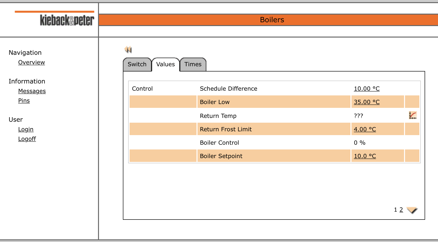

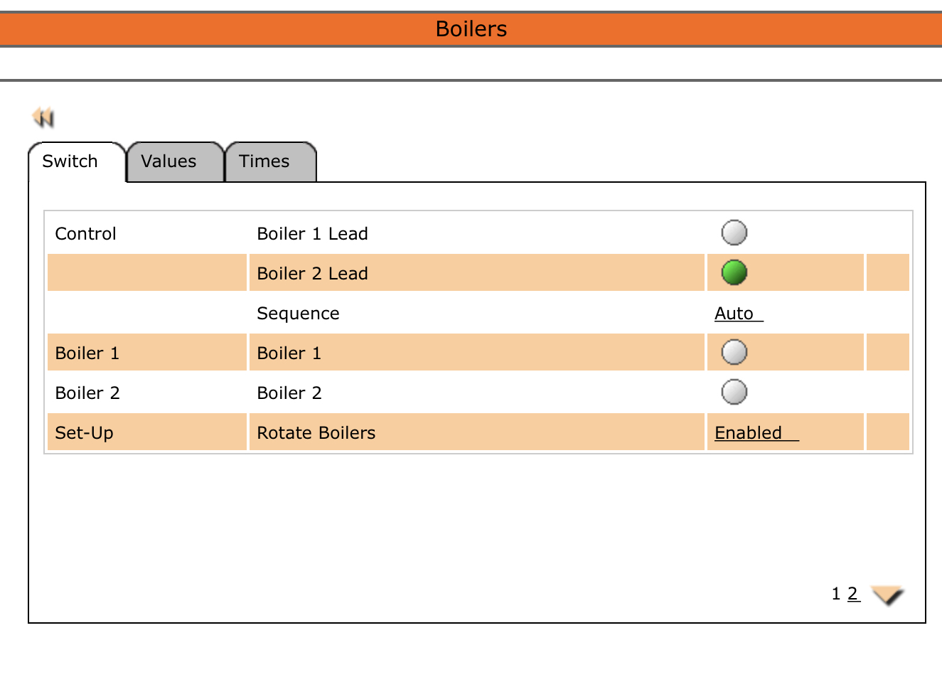

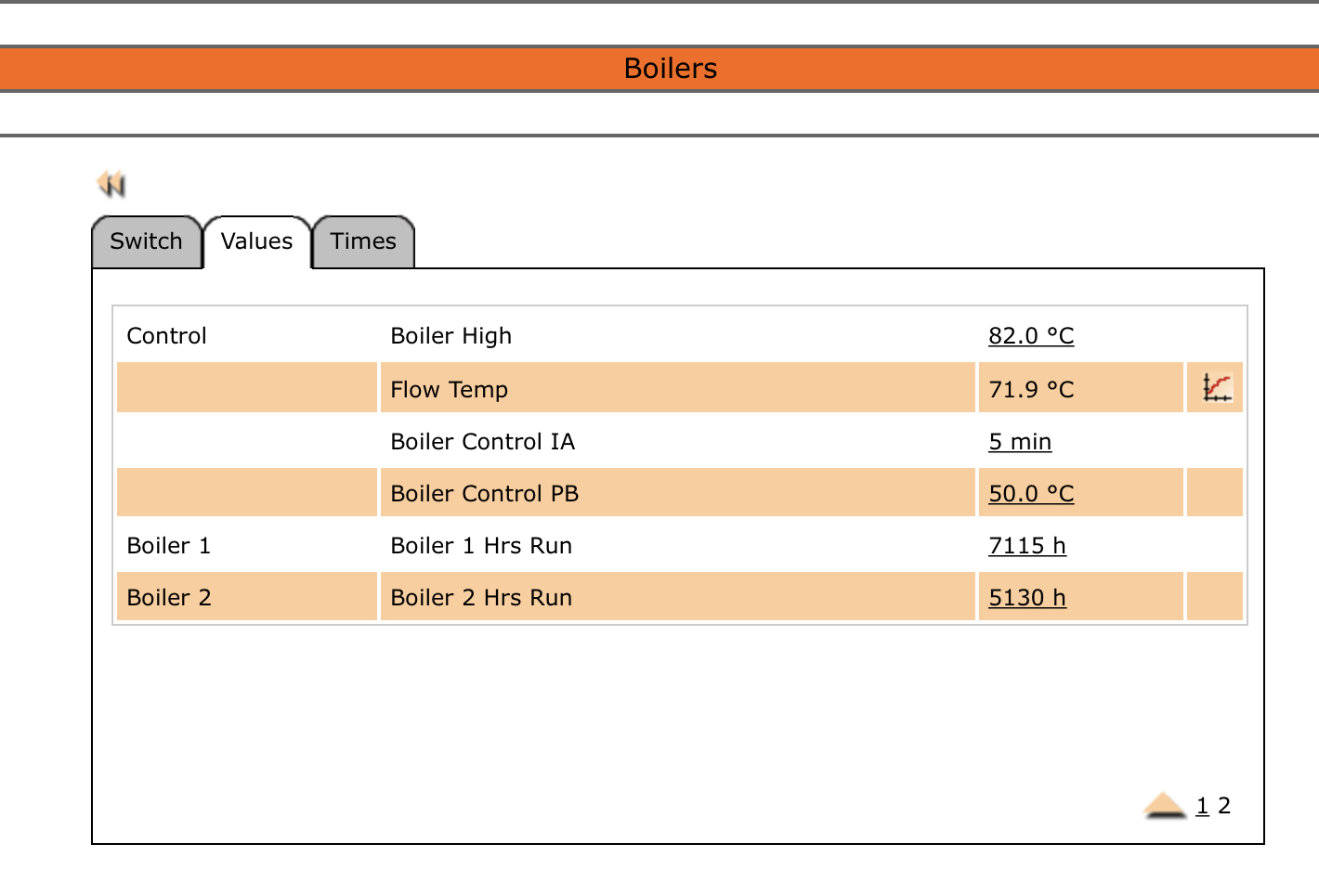

It feels like we are wasting a lot of oil, we've ended up turning off a lot of the 'smart' adaptive features to try and figure out what is going on (there are other mystery behaviours...) and then possibly build up back from there but the first priority is to figure out how not to waste oil when there is no demand at all... Could this be something wrong with the boiler and not the controller? Sometimes (like in this afternoon for the graph attached) when the boiler is on the boiler section of the web-controls doesn’t show either boiler as 'green' which I interpret to mean the controller is not currently asking for a boiler to fire.
