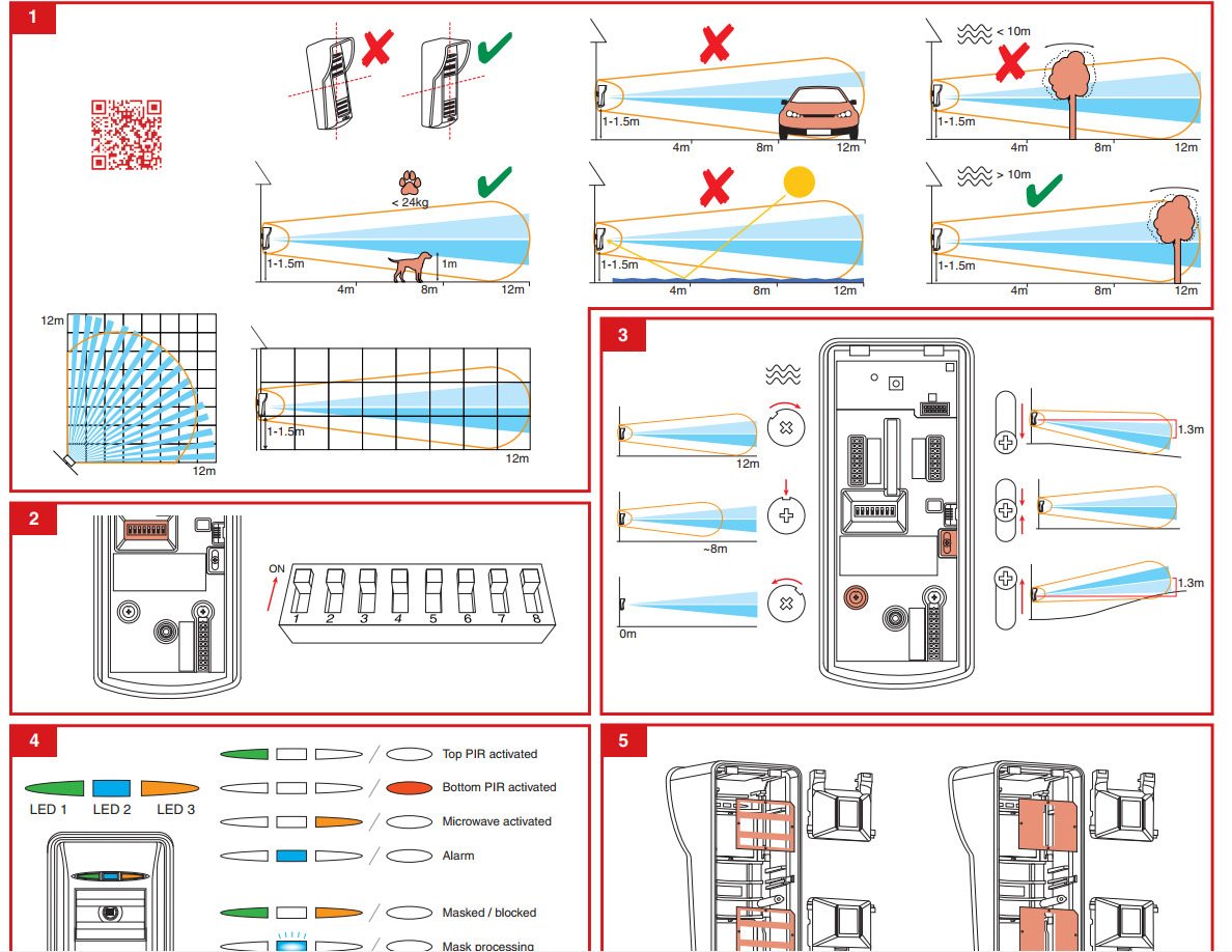

Thought I was buying the best Outdoor PIR sensor for residential purposes, the expensive Pyronix XDL12TT-AM PIR with "tri-signal" technology (IR and Microwave). They are marketed as offering up to 24Kg pet immunity. I'm getting false alarms caused by the local rascal, probably weighing 5Kg. There doesn't appear to be a pet immune adjustment setting. Only beam length and height adjustment. The sensitivity is set to Auto (instead of High) but still I get a false alarm most nights (backed up by CCTV in some cases). Yes, I can adjust the mount angle but then I won't be able to detect a crouching intruder.

Was aware of this video a year ago but relied on the wordless instructions in the end. In terms of a "sensitivty" setting there is only Auto (default) or High via dip switch. The other adjustments are beam length and angle.

All my sensors are mounted between 2 and 2.5m high. I've screwed up here, clearly. Didn't pay too much attention to where I got the builders to take out the wiring. But now I'm here, it looks like I have to play with the Elevation Angle setting?
In any case guys, even if the unit is mounted wrong, what I'm seeing is that pet immunity is failing 50% of the time thanks to an average sized cat! This shouldn't be the case based on the marketing. Logically, I shouldn't have to play around with the heights and angles to gain an advantage against a cat. The detector should "see" right through it.
The height of the device when using pet tolerant is critical.
The beam pattern will not work correctly, the microwave balloon will not work correctly.
Adjust the height of one of your devices,then setup correctly and see your issues disappear.
I can't. Adjusting the height of the installation will ruin the external walls. The cables come out of rendered walls at the front/back and lovely brick work on the side. I really can't be extending and running conduits down my house.
If it was that critical they should make it clear. The XD brackets angle down by 45 degrees, this gives the impression it's a valid config to mount high and point down. This was a thorough rebuild property. I committed to wiring/mount positions a year ago.
All I can do is fudge my way out of it now with the elevation angle angle and hope for the best.
Think it does make it clear on mounting height , whoever put the cables in got it wrong !
2m-2,5 m high,the plan /angle of the beams are wrong.These will always false alarm.

Appreciate the frustration but you’ve mounted the kit way too high. That’s what’s causing the false alarms.
