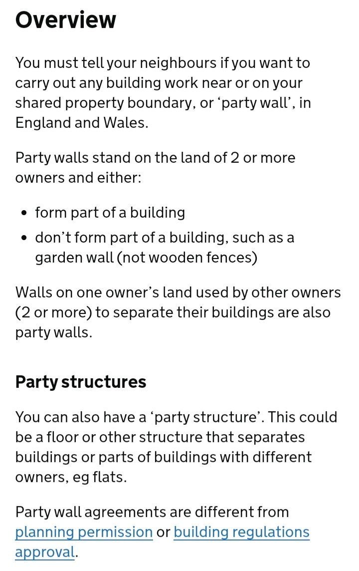

I live in a flat. My downstairs neighbour is having various work done including:
Chimney breast removal (mine would stay)
Internal wall removal (it's a supporting wall and mine is above)
Knocking down of external walls that support mine and adding extension.
He says his surveyor said this doesn't need a party wall survey because we don't share any party walls. Three surveyors I spoke to said the chimney breasts at a minimum do (party structure).
Is there specific law I can quote on this?
And if not, what do I do next?
(Flats are leasehold, he has permission from freeholder for external work, not sure about internal). He doesn't have council planning consent for the chimney or internal walls.

Express your concerns, to your local councillor, and ask him to involve the council.
In respect to the chimney I think the Party Wall Agreement is required
And be firm with your neighbour - THEY HAVE TO PAY, and it delays work so of course they are going to say it’s not needed.
Also put a call into your local building control office as they must be involved
Floors and ceilings of flats are as you say "Party structures"..
And depending on what work is carried out, would fall under the Party Wall etc. Act - the etc. is the important part here!
Thank you. I've pushed him to tell me on what exactly basis his surveyor is saying it's not a party wall act matter as he insists the surveyor says it doesn't fall under the act (whereas the two neighbours either side have been given notice as it affects their garden walls for the extension).
If not I will involve the freeholder, council and potentially appoint my own surveyor but want to avoid that due to cost if I can.
Yes sorry I mean in the event that he refuses to issue a notice and starts the work while I'm still trying to organise ny side.
You can then serve an injunction, which means all further works come to a stop, until the notice is properly served.

Are you certain the walls are structural walls? If so....
Speak to the building owners (Freeholders) and inform them structural alterations are taking place in the flat below.
Any removal of structural walls fall under Building Regulations and are subject to building inspections.
PWA will apply but it's scope may be limited in this case.
