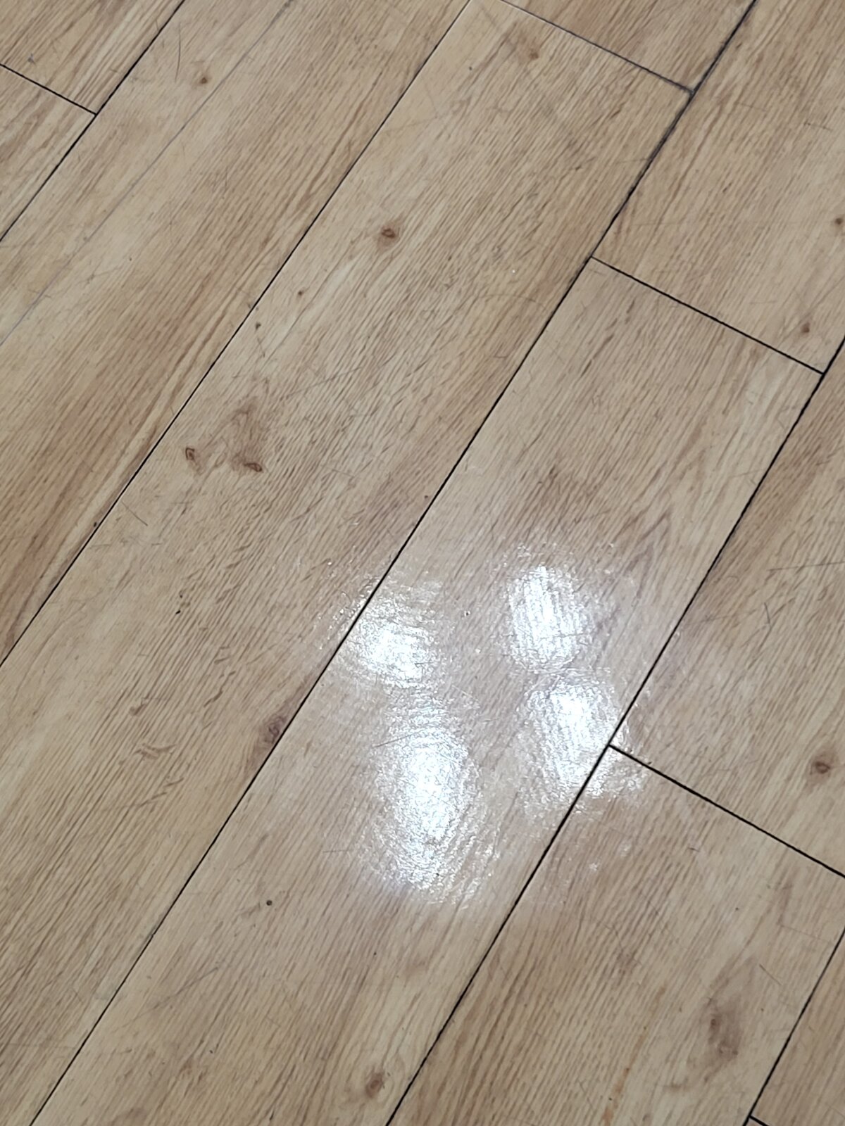

W williamglossop Joined 28 Jan 2011 Messages 517 Reaction score 44 Location Manchester Country 23 Feb 2023 #1 How do you prevent adhesive swirls coming thru LVT? Like this I mean l.....
dazlight Joined 6 Apr 2012 Messages 2,079 Reaction score 407 Location Merseyside Country 23 Feb 2023 #2 Be ripping it all up and doing it again with the correct notch trowel. A a2 notch
W williamglossop Joined 28 Jan 2011 Messages 517 Reaction score 44 Location Manchester Country 23 Feb 2023 #3 That's not my floor. That's Argos in my local town. But I've seen these swirls b4 in lvt. I assume using an A2 trowel prevents it showing thru?
dazlight Joined 6 Apr 2012 Messages 2,079 Reaction score 407 Location Merseyside Country 23 Feb 2023 #4 Yeah A a2 is more adhesive lines but smaller. Seen it a lot with vinyl sheet. another way is use F46 and trowel on then flatten with a paint roller.
