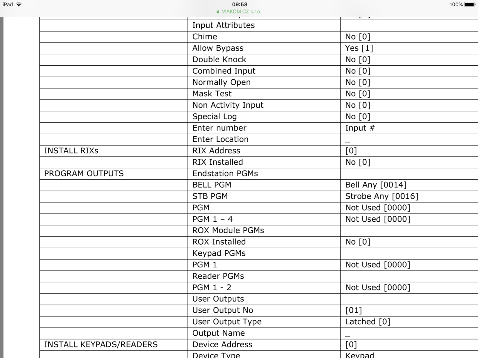

No but ! Someone else had an issue the same I think they accidentally altered the bell output
Thanks for the video Fozzy. Interesting that this shows the input type as entry delay rather than final exit. I wonder if this will make a difference...
Your programming of final exit is correct .....I can’t find the post but remembered they had accidentally altered the bell output to “set” so every time they armed the system it rang the bell
Thanks sparkymarka. If that’s the case then a full reset will probably be quicker and less painful than checking all the factory defaults.
Already looked and couldn’t find anything linked to the bell sounding when the system is unarmed. Very odd.
Just check this program output list first
Also one other last thought ...the new contact you have fitted ....make sure the screws are not shorting the underside of pcb ...
