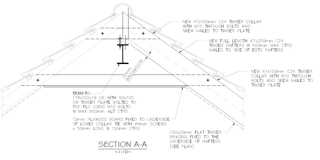

Hi, I'm having a vaulted ceiling and a Ridge Steel has been fitted. Internally, I want a triangular ceiling.
I was wondering how the rafters should be fitted on the steel. I've attached an image with two options.
1. where the rafter fits into web of steel with noggins
2. add a bolted timber in web and attach rafters to timber (I assume with some form of hanger)
Can either option work ?
(A third option would be to fit rafters on top of the ridge)
I could not find the associated building regs on this, hence my question.

I noticed there's several ways in how these are connected. My preferred option is rafter in the web (as per drawing). The carpenter had a look at it and said its wrong, hence was confused. I dont want the inspector to fail it
Either of the two is fine.
Depending on the type of joist hanger you use if you go with option 2, you may need to notch the underside of the timber for it to sit in the hanger like you've shown on the first sketch

Rafter just slotted into the web is no good. Rafter connected to a timber infill (via jiffys) that has been fixed into the web of the steel is fine.
You cannot just slot the rafter in, that cut top and bottom will reduce the structural strength , all the load will bounce on that notch cut corner and the bottom. Before you do it make sure you know where and how the finish will sit to give you the shape you want. You may have to skin up the bottom of the rafters with batten to get the angle into the void between the steel and the rafter.

The Structural Engineer designed the above steel. Collars should not be needed because the steel can support the weight of the load and is fixed on both ends.
I haven't drawn the diagram accurately, in reality, I'm putting in 7x2 rafters the rafter length either side is 2m. The bottom of the 7x2 rafter is lower than the bottom of the steel, meaning I can insulate to stop cold bridge forming and still form a triangular roof.
Insulation board added to bottom of rafters, Insulation added between rafters, Battens will be added and tiled. Is this a cold roof?
If it helps I've just rec'd detail from my structural engineer. We're only vaulting one half of an existing roof / ceiling hence only one side of rafters shown and being fixed to existing rafters - but the general concept is the same.
