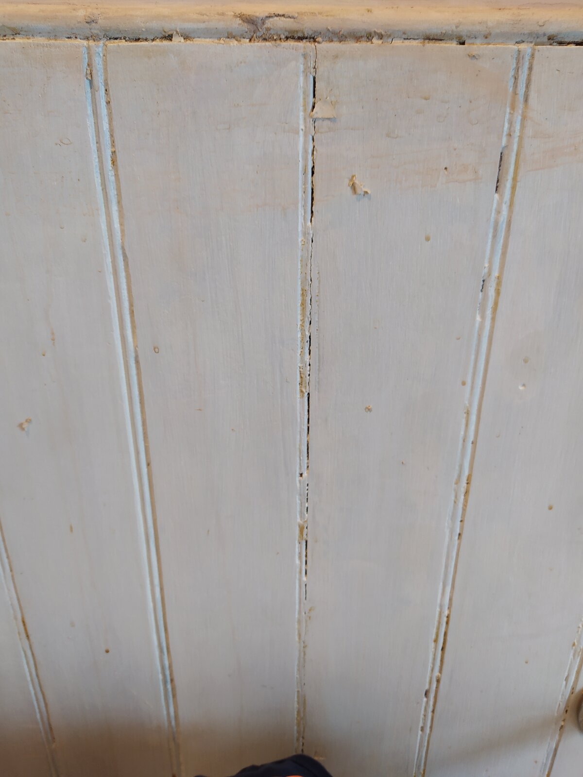

Hi team,
I've unearthed some original tongue and groove wood paneling in my bathroom. After stripping old tile adhesive, sanding and priming, I'm now needing to repair them before more priming and a top coat.
I'd like some advice on how you think I should repair gaps between the boards. I was considering completely filling and then routing back out, or maybe trying to caulk them and shape the caulk. I'd see pros and cons to both.
Any advice appreciated.

The gaps can be caulked with paintable silicone (they are the bottoms of grooves, so it won't be that noticeable under a few layers of oil-based paint), but because it's a bathroom I'd avoid filler if at all possible simply because the wood is going to move with changes in moisture levels

I'll have a shot with the caulk which was my preferred option because of the flex, I imagine despite the tight grain that the wood will move around a fair bit with moisture.
If it doesn't work, nothing lost. If it does, I'll be delighted that I've been able to preserve another bit of the original house.

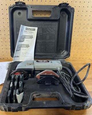

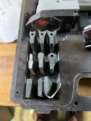

Actually, there was also a Porter-Cable model (model 444 or 444VS), but they stopped production a few years ago. Only offered in the UK for a couple of years. Terrible tool - ran hot (so hot that it would be uncomfortable to hold), very noisy and so much vibration that more than 15 minutes use and you'd feel like you were developing vibration white finger:
Fortunately, they are no longer around unless you are keen (mad) enough to import one from the USA and run it off a 110 volt transformer

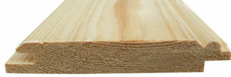

The shape you are trying to create is this:
which AFAIK cannot be reproduced with a round-over bit (these sorts of profiles were run in a 4-sider or a 3-head match planer if it really matters - and before the widespread use of machinery in the 1850/60s this fancy match boarding T&G would probably not have been used in most of the UK because it involves so much hand planing effort (which is time consuming and consequently expensive) - about 5 or so and planes: namely a matched plane "pair" (for the T&G), side bead plane with a fence, fillister rebate plane and something like a rebate plane with a bevelled fence as a minimum
