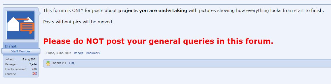

For future reference the 'Your Projects' Forum is for......
Ideally, you should really have posted your electrical queries in the 'Electrics UK' forum instead.
Sorry for posting in the wrong area and thanks for responding. New to forums and these things.

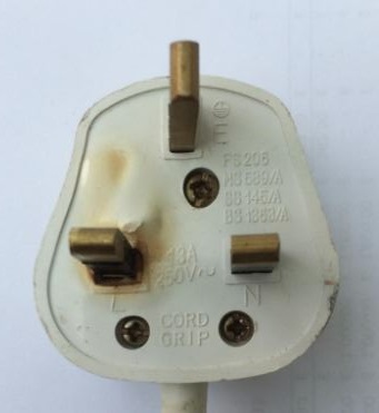

13A plugs don't take kindly to being overloaded, they often run warm at 3kW. You might get away with it, but personally I wouldn't want to risk it.
As @stem says, over loading a 13A plug is not good. A plug should be in free air to cool it, however with an oven often there are fans cooling anything within the carcase.
