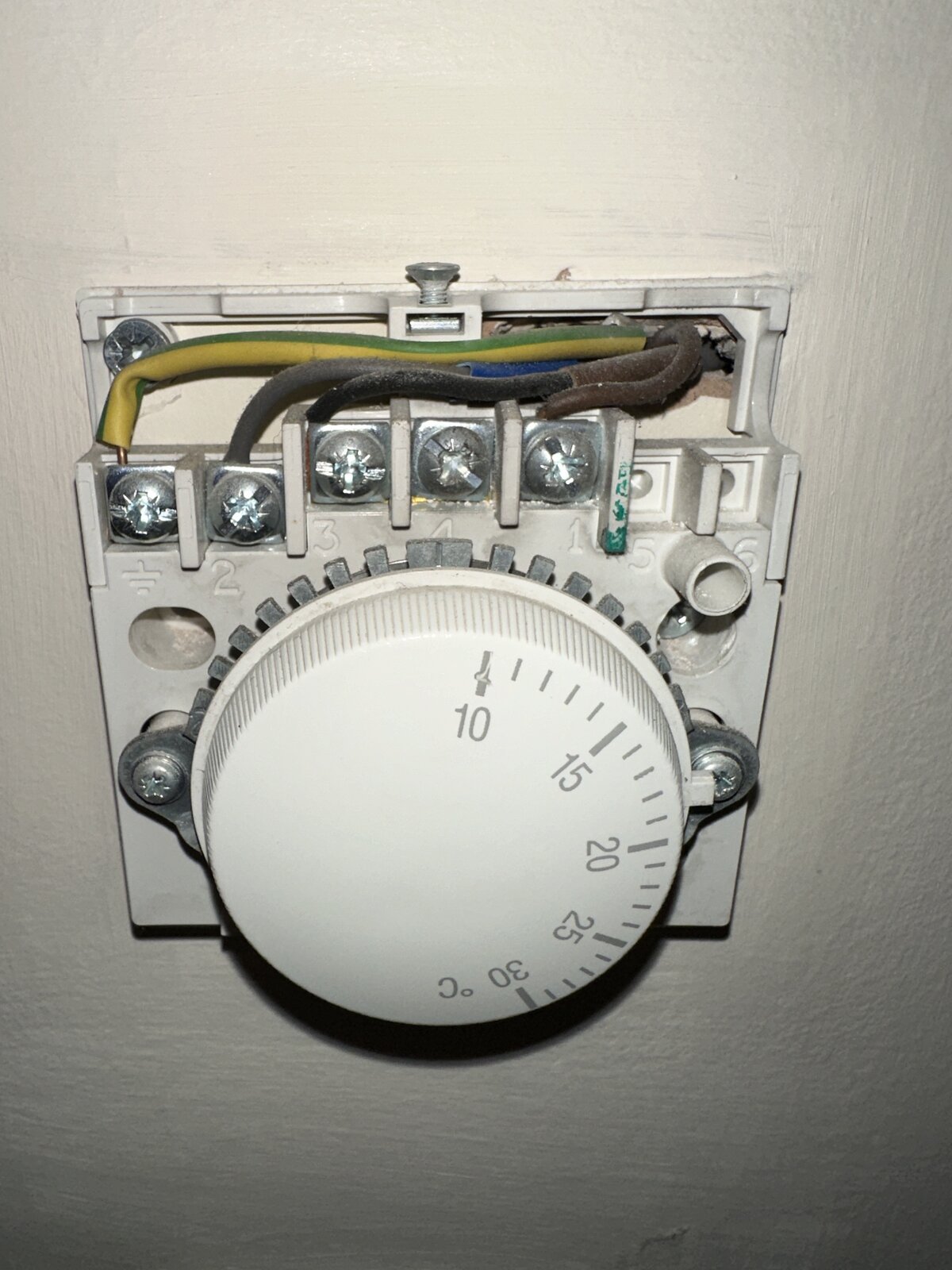

Hi,
I'm looking to replace my current Honeywell thermostat with a Hive Mini, looking at the original wiring and then the wiring guide for the Hive Mini, I'm a bit lost.
For reference, when the thermostat is turned up high, it clicks, and the combi boiler fires up and turns the heating on. (I know I just explained how a thermostat works, but I wasn't sure if this changes the way you would wire the Hive Mini)
Note: I should also mention that there is a mechanical timer module built into the boiler, but it's not used and is bypassed by having it switched to 'Fixed on' so that only the thermostat controls when the heating is on basically.

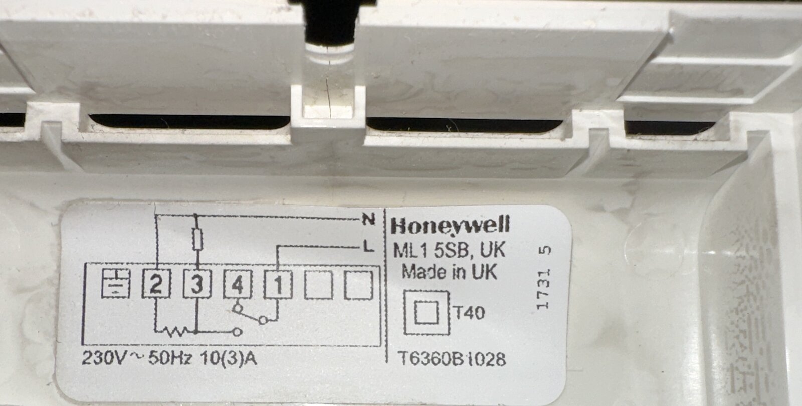

From the wiring below, I can tell that the Neutral is going to '2', and the Live is going to '1', (and of course, Earth is going to Earth) but I'm not sure about the Black wire going to '3'.
An image of the original Honeywell thermostat, with the wiring exposed.
Below is an image of the wiring diagram on the cover, which I think is what is throwing me off.
A sticker that is displaying the wiring diagram for the Honeywell thermostat

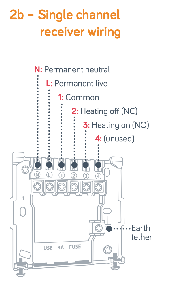

I have gathered (looking at the wiring guide for the Hive shown below) that Neutral will go to 'N', and Live will go to 'L', but my question is, where would the black wire go, and can I replace the Honeywell with a Hive mini?
Yes.
Plus green/yellow to the earth terminal.
To Hive terminal 3 (NO).
You also need to add a small link wire between L and terminal 1 (COM)
Yes! :)

Sorry to revive my post, but I've only just had a chance to recently buy the Hive Mini and attempt a replace, and unfortunately, it seems there is a problem, I don't think the wiring we all thought is correct, and I'll explain why.
First, I followed the wiring that both CBW and RandomGrinch provided (thank you again), however, when turning the power back on, I noticed nothing was happening, the Hive Receiver was off, no sign of life at all, which worried me for a moment, so I thought I would connect the previous Honeywell back again just to make sure something hadn't gone wrong, and sure enough it was fine.
Then I decided to check with a multimeter as I was wondering why the old thermostat worked, but the Hive didn't, and well, my findings are... interesting...
(I would have attached images, but taking a picture while holding a multimeter wouldn't work so I'll just describe what I did)
First, I connected the black probe to the Earth (Ground), and then I went one by one on each of the other wires with the red probe and found something interesting.
(I'm reattaching the image of the wiring so you don't have to keep scrolling up)
The 'Grey' wire ('2') (that has a bit of blue sleeving on it) displayed a voltage of 142 volts, that seems strange to me, but maybe that's right to everyone else.
The 'Black' wire ('3'), which does have a bit of brown sleeving on it, read... 243 volts? This was the wire we thought was the 'NO' for the Hive to control the heating.
However, the brown wire (going into '1') read... 0 volts... so I'm not sure what has happened here and if maybe whoever originally wired this somehow made everything confusing/complicated, but could it be that this thermostat was either wired incorrectly, or it's just that the there was a misunderstanding, because I'm assuming this is why I couldn't get the Hive to turn on?
Any advice on this would be a great help.

Ok, then try a swap - connect the black (oversleeved brown) wire to L and the brown wire to 3. It didn't really matter which way around the connections were in your old stat.
If measured correctly, this voltage is unexpected. It may suggest that your grey (oversleeved blue) wire, isn't actually connected to a neutral, or there is a fault elsewhere.
If you try swapping the wires, as above and the Hive still doesn't operate, we may need to trace the cable back to its original connection.

With the Hive receiver in place the N connection will read 0V.
With the old stat, there was an 'accelerator' resistor, internal to the stat. When you measured the voltage to N on it, you were measuring the voltage drop across this resistor.
Both of these measurements confirm (to me at least!) that the grey wire isnt connected to a neutral - it is just floating at whatever voltage we put into it; and hence why it still didn't power the Hive.
