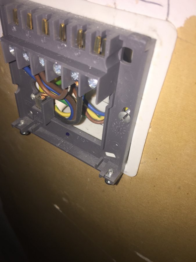

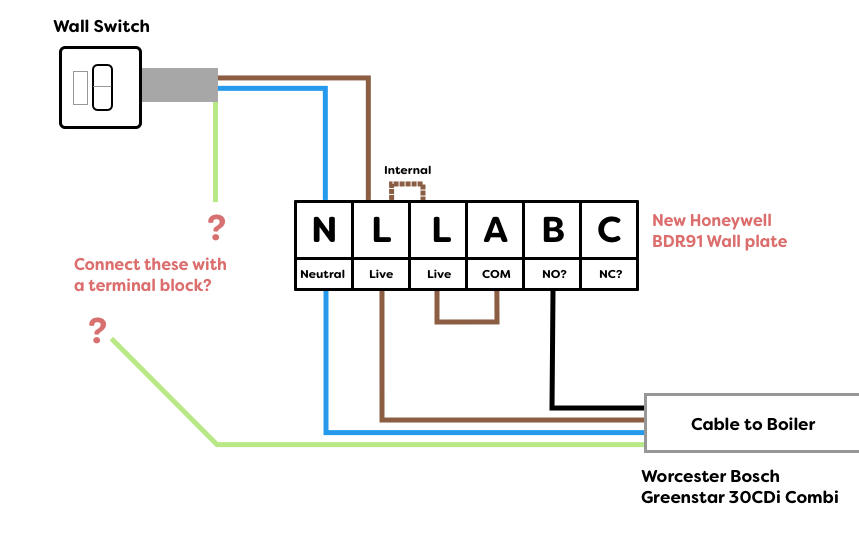

We have a Worcester Bosch Greenstar 30CDi Combi boiler, and a Danfoss RX-1 unit as relay to it.
Existing Wiring:
From what I can work out from the wiring guides for the Honeywell BDR91 and the Greenstar, I need to do the following:
I believe I've got that right, however unsure what to do with the earth wire(s) - these are currently connected to a terminal in the corner of the RX-1's mounting plate, do I:
a) Connect them each to their own separate terminal block to terminate;
b) Connect them to the same terminal block, joining them;
c) Fit a back box for the BDR-91 that has a terminal connection for earth, and connect them to that;
d) None of the above (please advise!)
Any glaring errors? I'd be really glad of your help.
