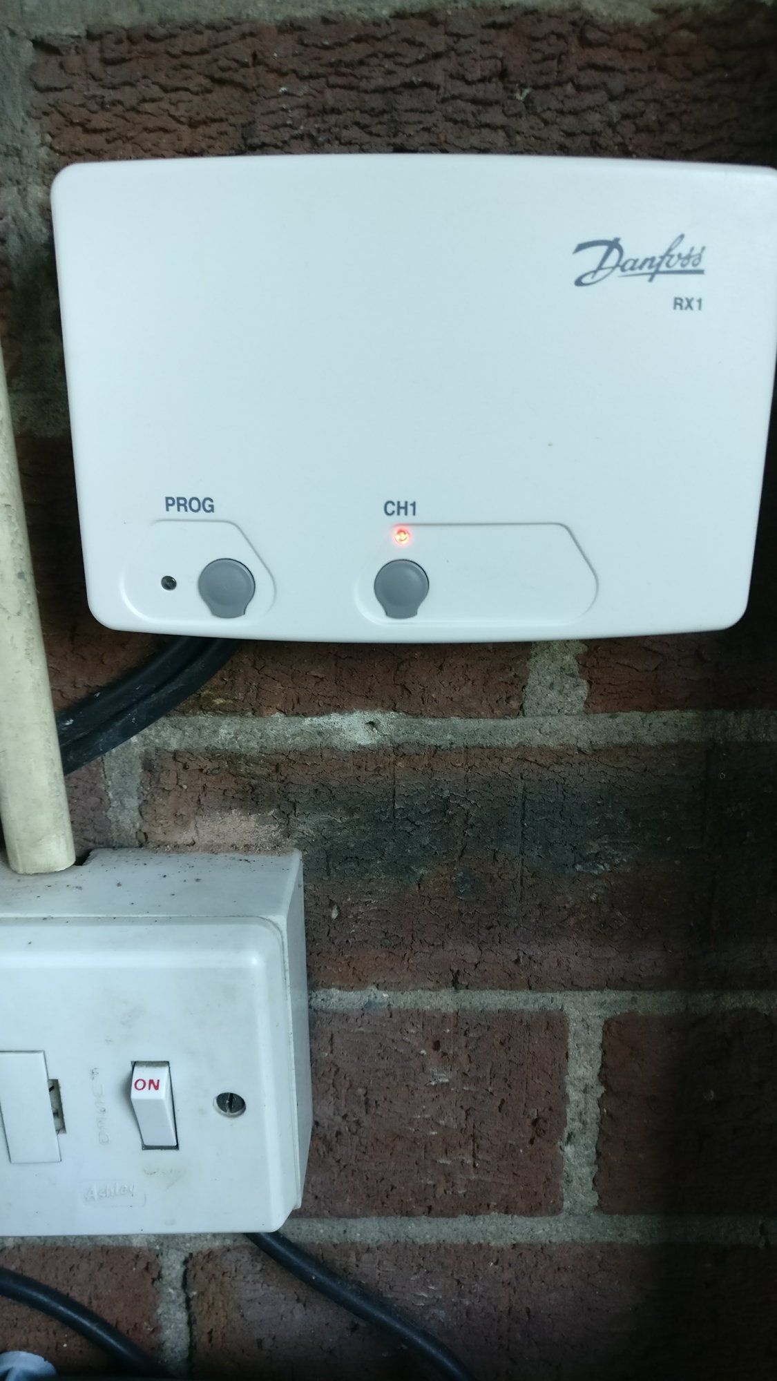

Hi
I would like to change my programmer (Danfoss TP5000si-RF / RX1) controlling my Feroli Modena 102 combi boiler to Hive 2. It seemed pretty straightforward to begin with but although the Hive receiver is working fine sending the on/off signal etc the boiler isn't firing up.
I have checked the forum but can't find the answer, I have also checked the Danfoss site to confirm the existing wiring configuration and it looks like it's not quite as expected (they show the CH-OFF in number 4 and my current setup has no wire there - and currently CH-ON is in number 2 which should be COM according to the RX1 wiring diagram.
I'm a bit baffled how my current setup is working correctly like this, or maybe it's something peculiar to the Modena 102?
Any advice on how to configure for Hive 2 receiver would be gratefully received.
NB. Do not take the CH-ON & CH-OFF labelling as "gospel" as I put these on thinking the existing wiring was as expected.
[GALLERY=media, 100544]Existing working Danfoss RX1 receiver by ChrisESP posted 7 Nov 2017 at 3:55 PM[/GALLERY][GALLERY=media, 100543]Existing working Danfoss RX1 receiver wiring plate by ChrisESP posted 7 Nov 2017 at 3:55 PM[/GALLERY][GALLERY=media, 100545]Danfoss RX1 receiver wiring instructions by ChrisESP posted 7 Nov 2017 at 3:55 PM[/GALLERY]
