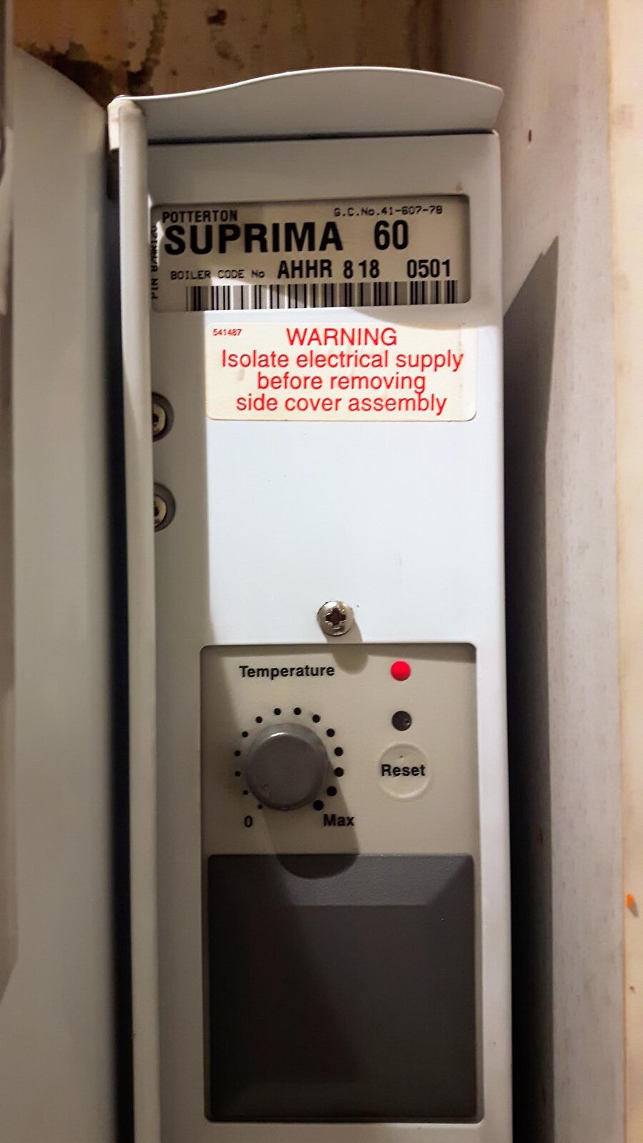

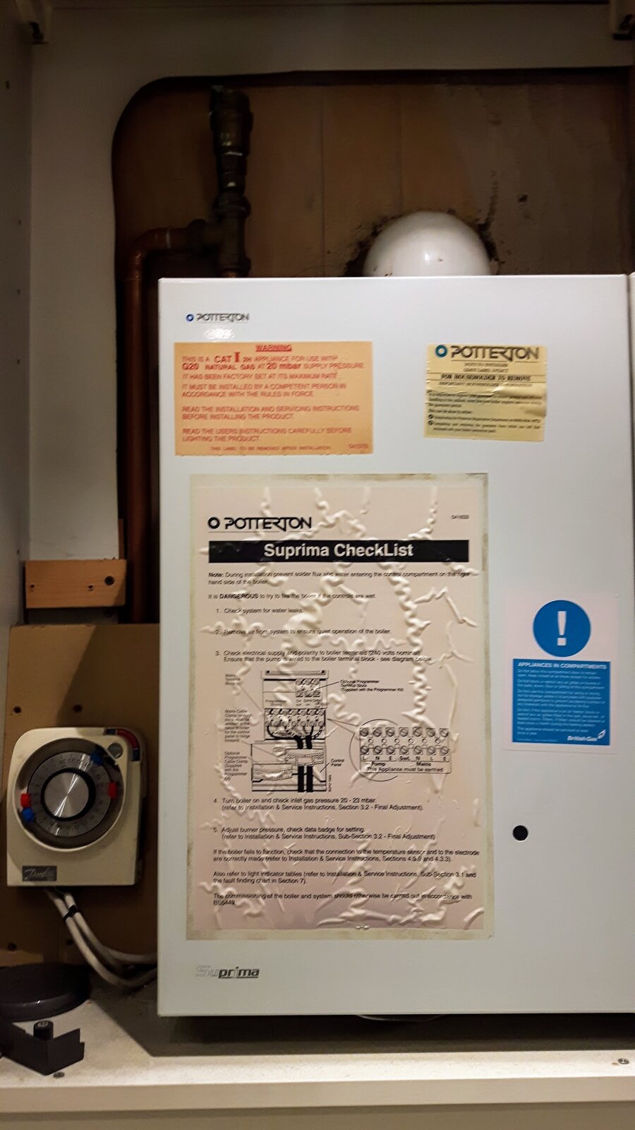

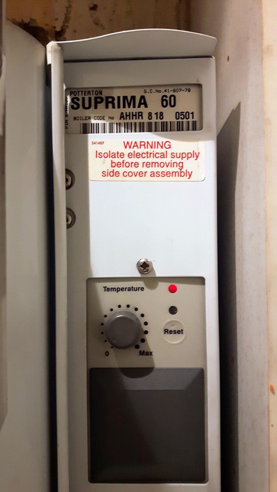

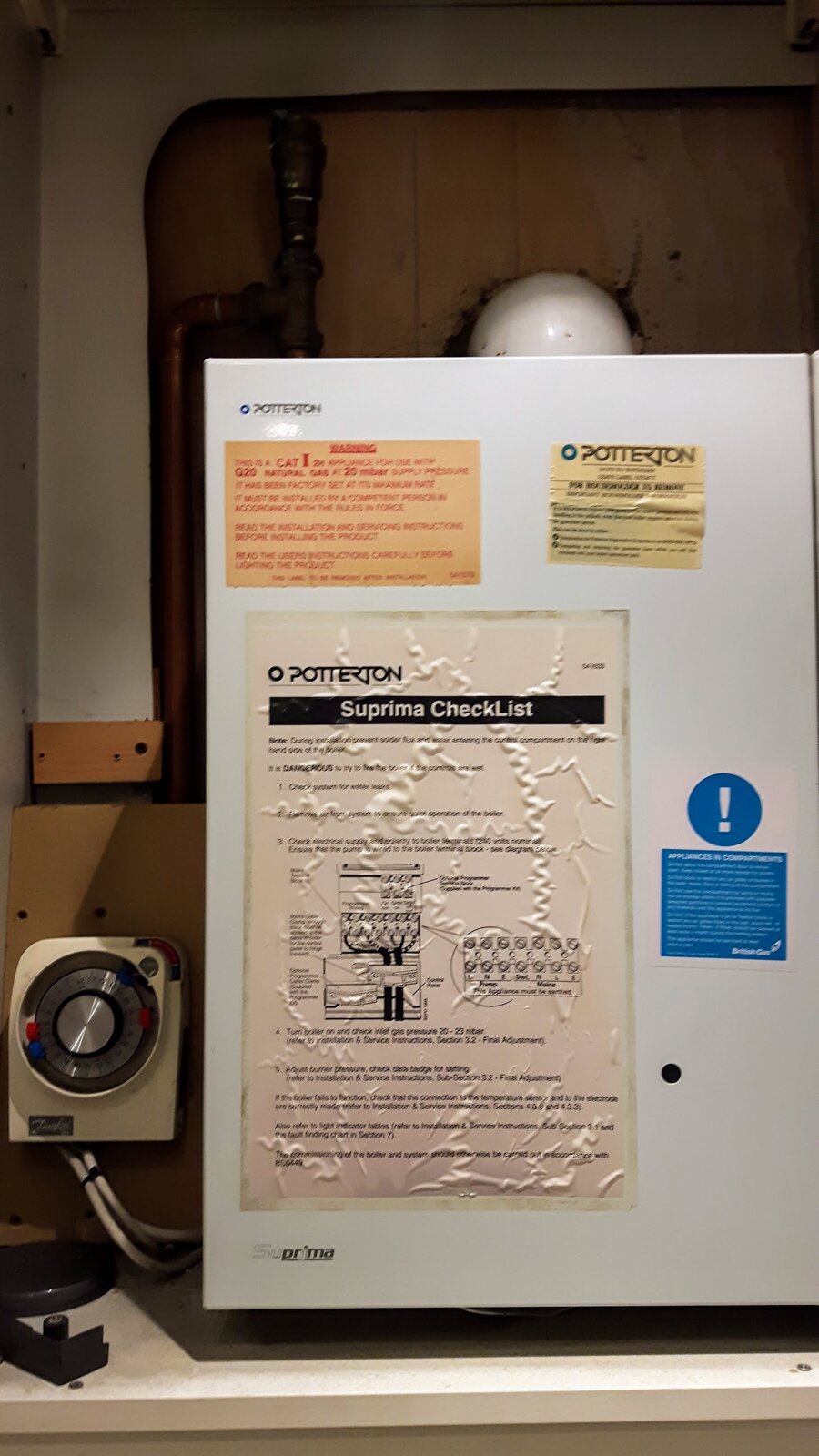

Aha! Thank you for the correction and explanation, Ian. That makes sense. However, I've just been reading about fully pumped, Y plan and S plan systems and none of them seem to match my system. It looks like they all have valves which allow HW and CH to be switched on/off independently. My system does not have that and is simply on/off for both CH and HW at the same time. Plus the only thermostat that I know of in the entire system is one that is integrated in the boiler. My understanding is that it switches boiler and pump off when the return temperature reaches the threshold set on a dial on the boiler. See pic attached.
We virtually always have the temperature set to minimum, unless it is a VERY cold day.
I guess I need to fully identify what my system is before I consider what change to make. Any further help that in doing that would be much appreciated.

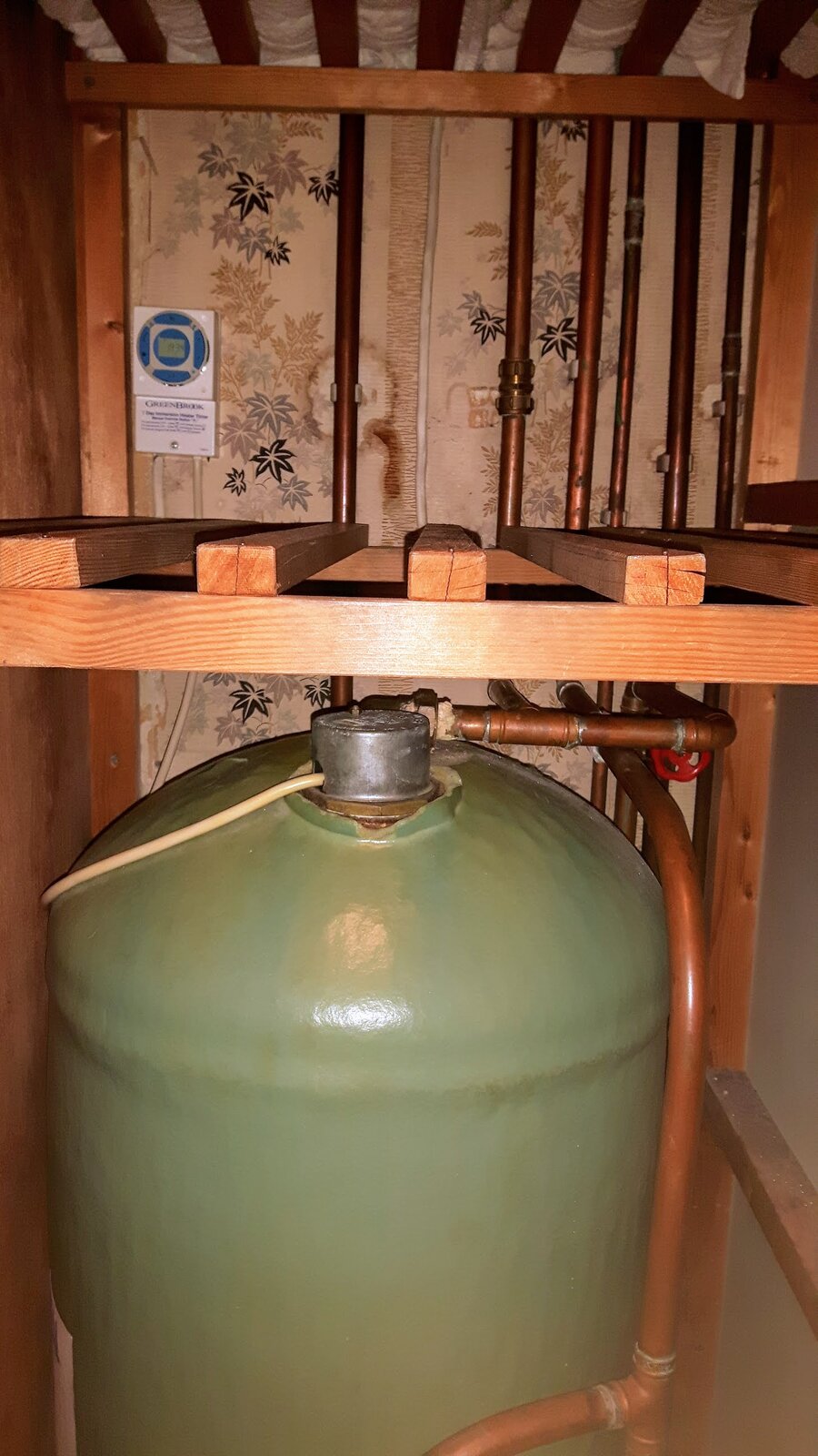

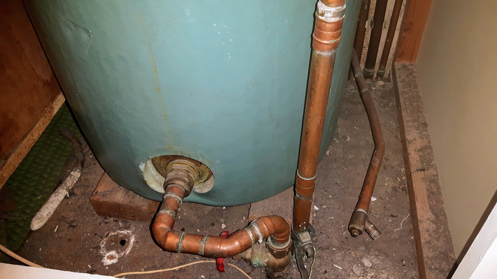

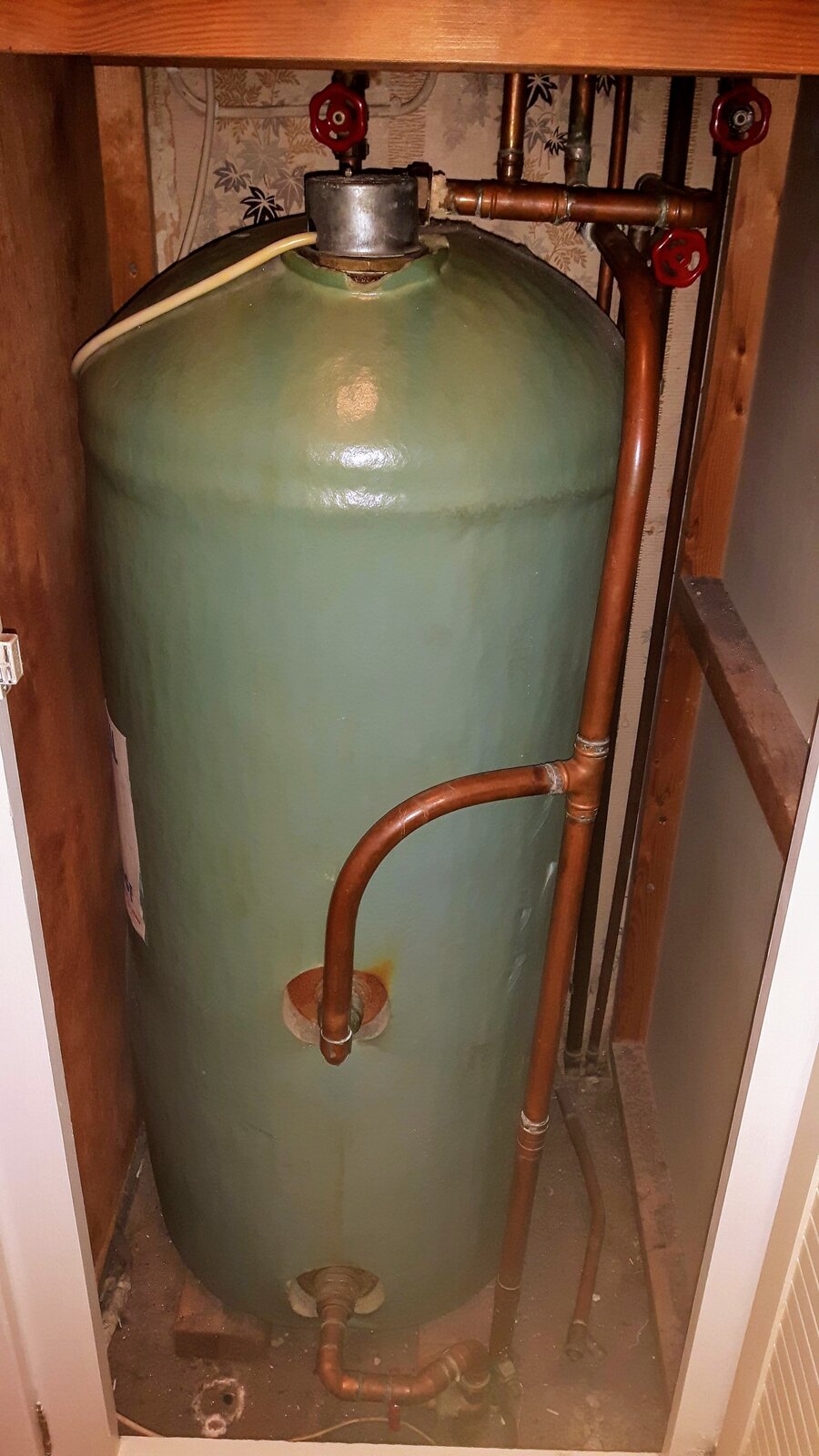

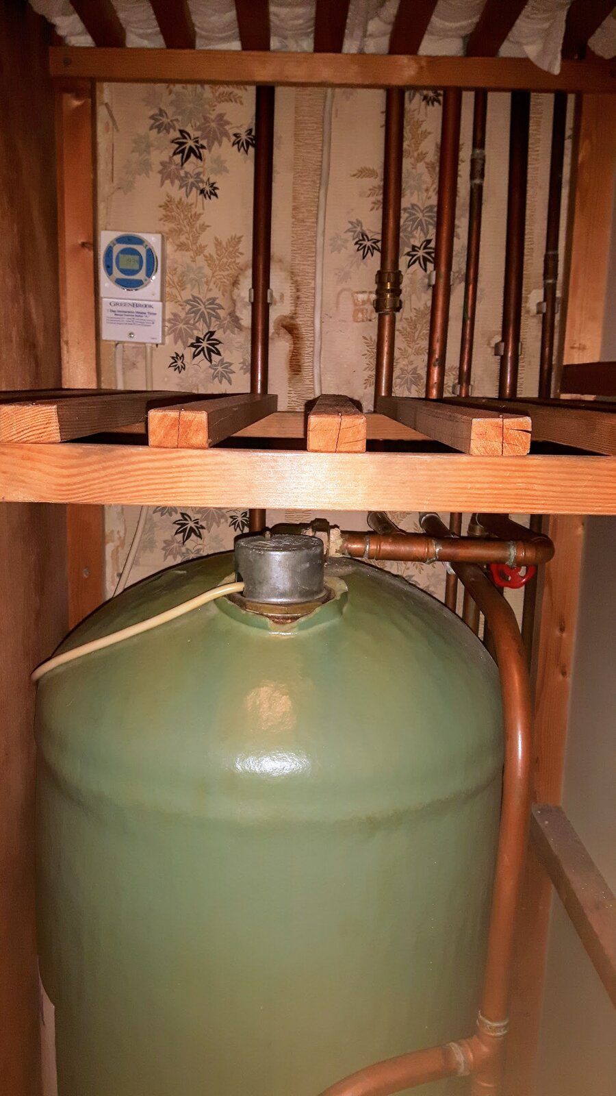

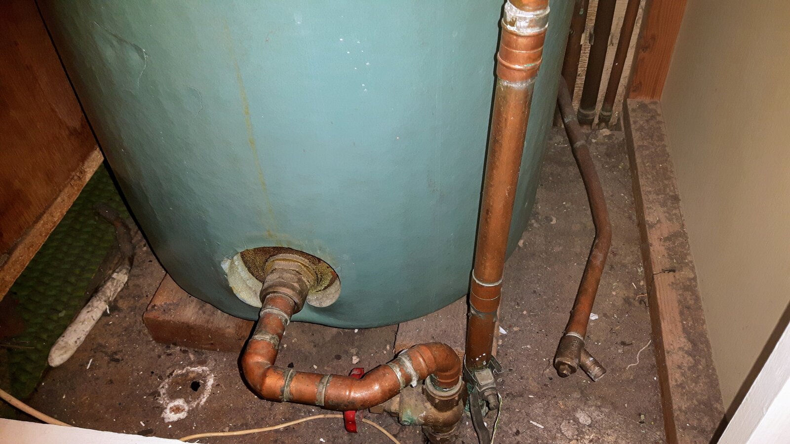

post a pic of your hw cylinder and its pipe work and anything else near it, the pics you have posted just tell us what boiler you have , nothing else, but doesnt look like gravity hw as the pipe from the top of the boiler goes down so gravity hw wouldnt work in that scenario
Nothing else around it. Just radiators, which just have simple valves on them, not thermostatic ones. Flat is on a single floor. Top floor with loft directly above.
