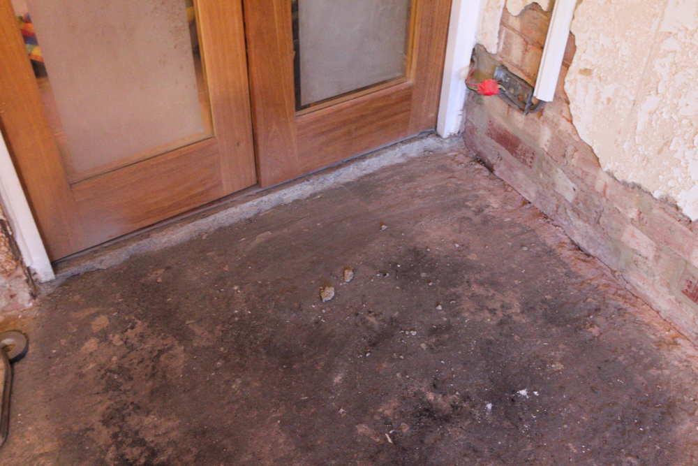

I recently pulled up the screed from my floor because it was cracked and damaged from damp.
So I need to replace the screed, the screed depth required ranges from 25-40mm (concrete floor is not entirely level).
I've taken some pics so you can get the idea:

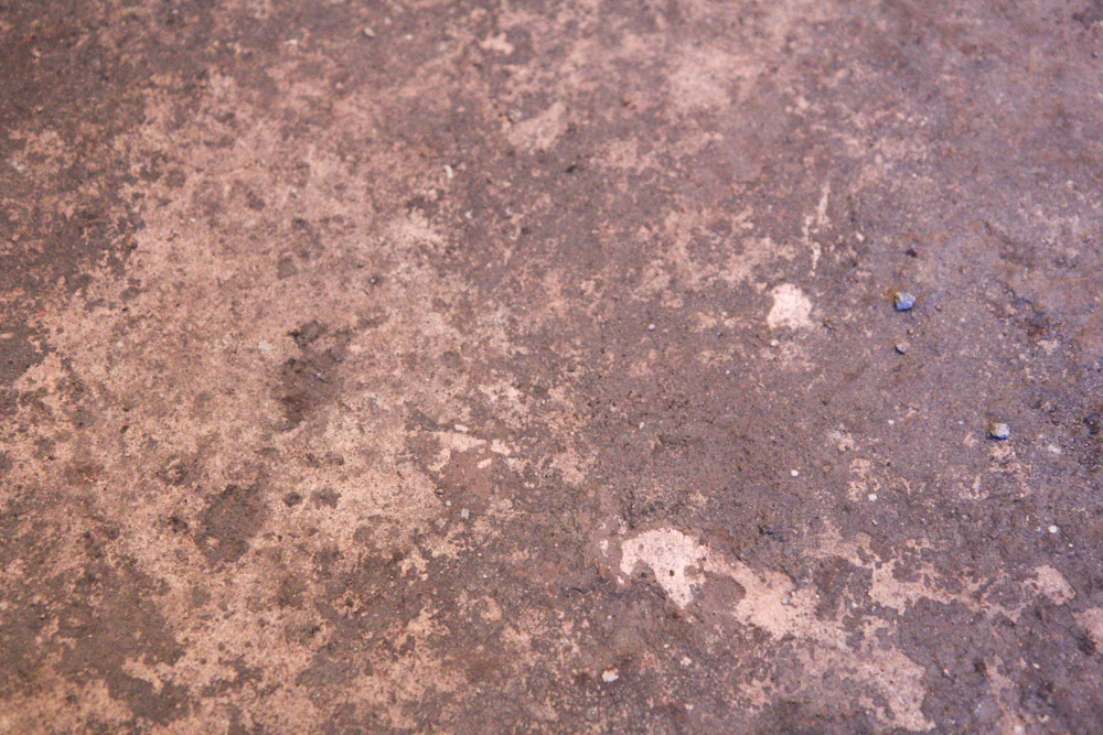

Here, you can see the depth of the old screed (around 40mm here), and the old concrete base has bitumen on the top, and is not very smooth.

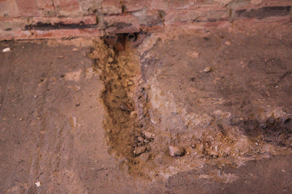

An old rusty Gase pipe has been removed here, looking for something to fill the gap with...

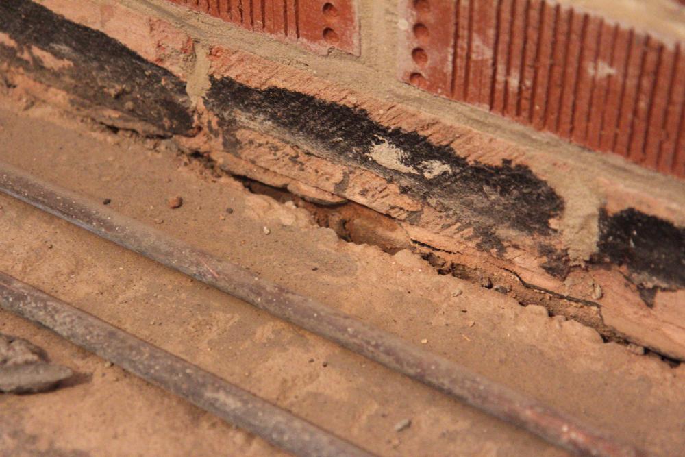

Here you can see the DPC in the wall (There is no DPM in the floor)
There is some radiator pipes that were set in the old screed floor:
There is no DPM in the concrete sub base, and given the damp problems I would like to add one.
From looking around at various threads here, the process seems to be along the lines of:
* grind floor to remove bitumen and lumps
* prime floor (seems optional but recommended)
* some self levelling screed 5-10mm?
* 2 X Dpm coats
* more self levelling screed to bring the floor level up with rest of house. 10-30mm?

4. What should I fill the gap with - where the old gas pipe was, before screeding?
I was thinking just of getting it clear and then using sharp sand/cement 3:1? Was also thinking of just emptying a tube of cheap silicon in the gas pipe should some water find its way in.
