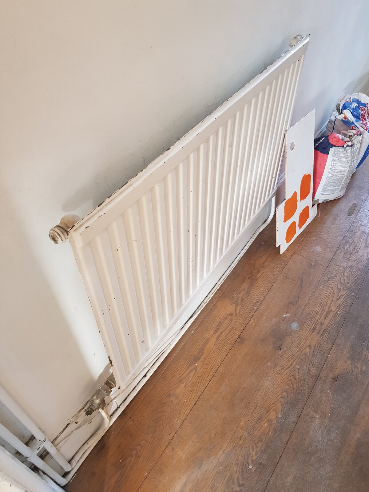

I'm planning to replace all my old and broken TRVs, 5 in total.
I then wondered if I should be replacing my radiators? See the photo, these must be 20 years old I imagine, are there more efficient ones these days?
If so, any reccomendations?
Advice would be great thanks

What do you mean by more efficient? If the old rad is partly gunged up the new one might give more heat output for a given water temperature, and possibly keep the room warmer if the old rad is struggling, but the only way it might save any gas is by enabling lower temperature hence more condensation (if it's a condensing boiler).

I can’t tell if yours is a finned radiator but if not, a finned one will pump out more heat. Also, the box design I think you are referring to is basically the same under the 'box' as the one you have. The top and sides of the 'box' are fitted once the radiator is mounted on the wall, if you want. If not, leave them off and they will look the same as the one you have.

Well I just read that radiators have become more efficient in the last 20 years, but I wasn't sure how. I can't imagine how exactly they would be more efficient!
They wouldn't be. They may give out more heat for a given size which means you can use a smaller one. But the amount of gas used to produce that heat would not change.
I suppose it's reasonable for rad makers to claim higher efficiency if it gives more kW/m2, (for given water flow and temp).
As you say, efficiency as heat out/heat in doesn't apply to a rad.
