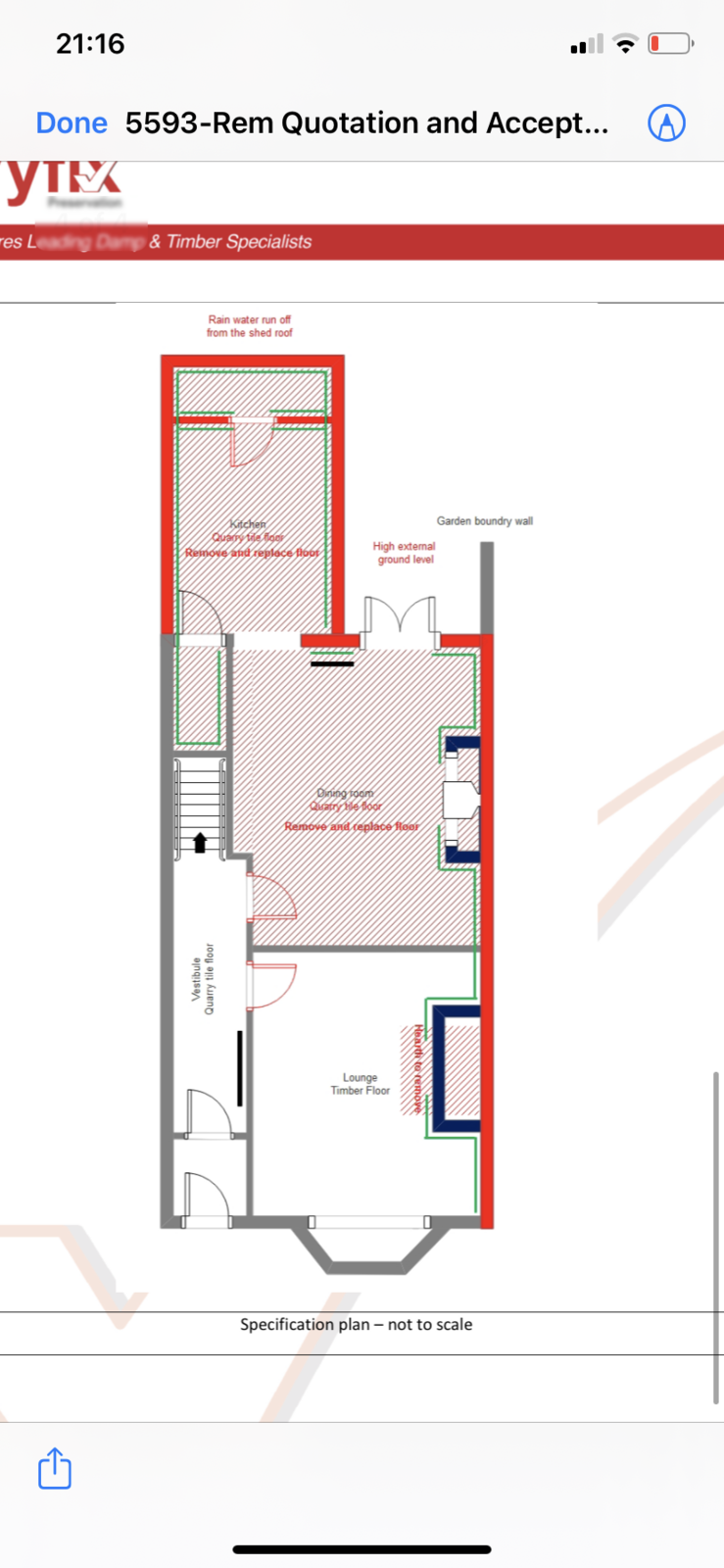

On instruction of the surveyor we paid for a specialist damp report from a company with very good reviews. The survey came back with £20k - £23k to inject a damp proof course and take up the old quarry tiles and replace flooring. Also opening up of the chimney breast.
They have also us to get a landscaper quote to reduce outside ground level which makes complete sense. However I cannot understand why the damp repairs quote is so expensive and whether the repairs are completely necessary.
Do you think these costs can be justified? How easy would it be to replaster and do new flooring ourselves? And then just ensure the property is sufficiently heated and ventilated.

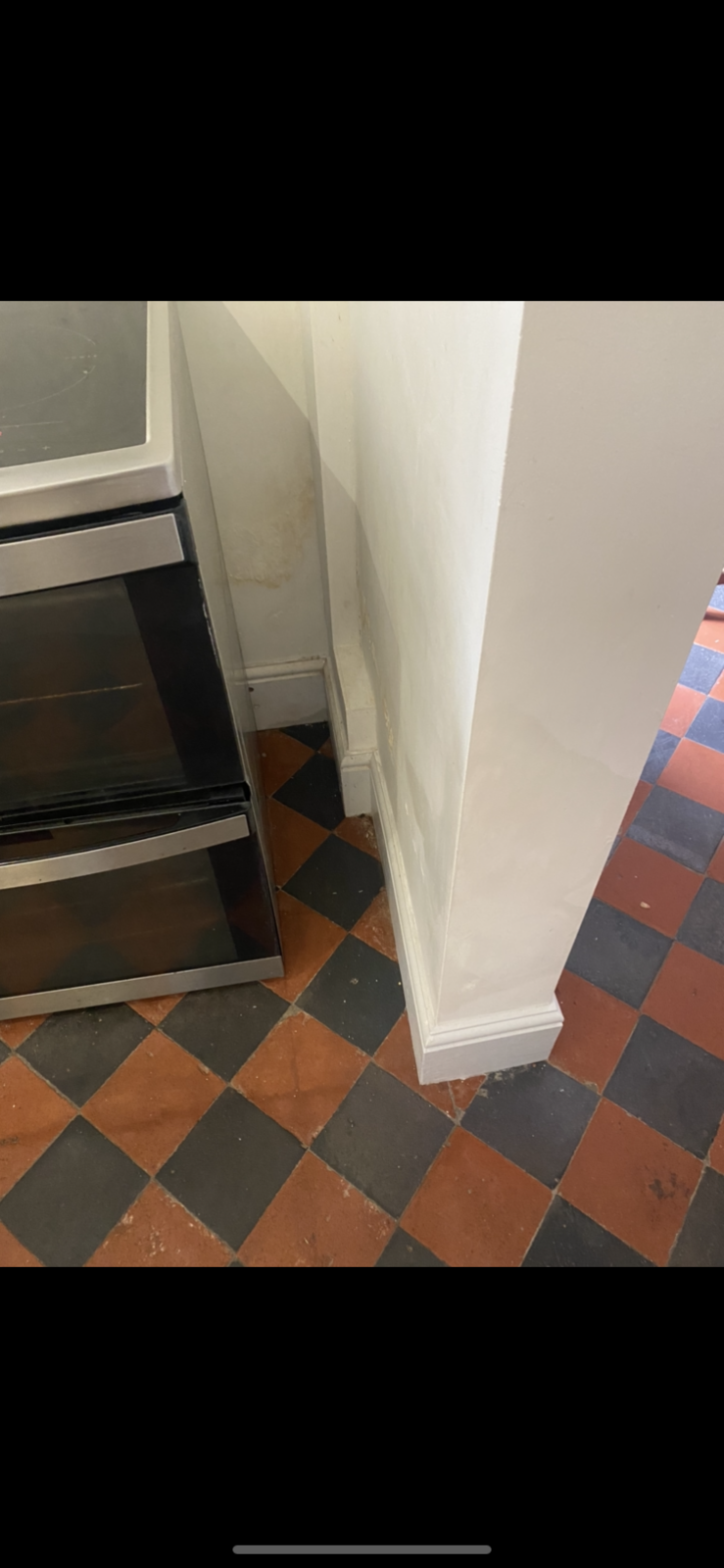

All of the things you have said, and the position of the damp patches leads me to believe that it's condensation.
However, getting a dpc in the floor, dropping the external ground level and improving ventilation are all good ideas.
I'm pretty skeptical of injected damp proofing in walls.
I'd do the easy/cheap things first, and see if it improves
That efflorescence is deffo damp and not condensation. Whether it's rising, penetrating or leaks is another matter.

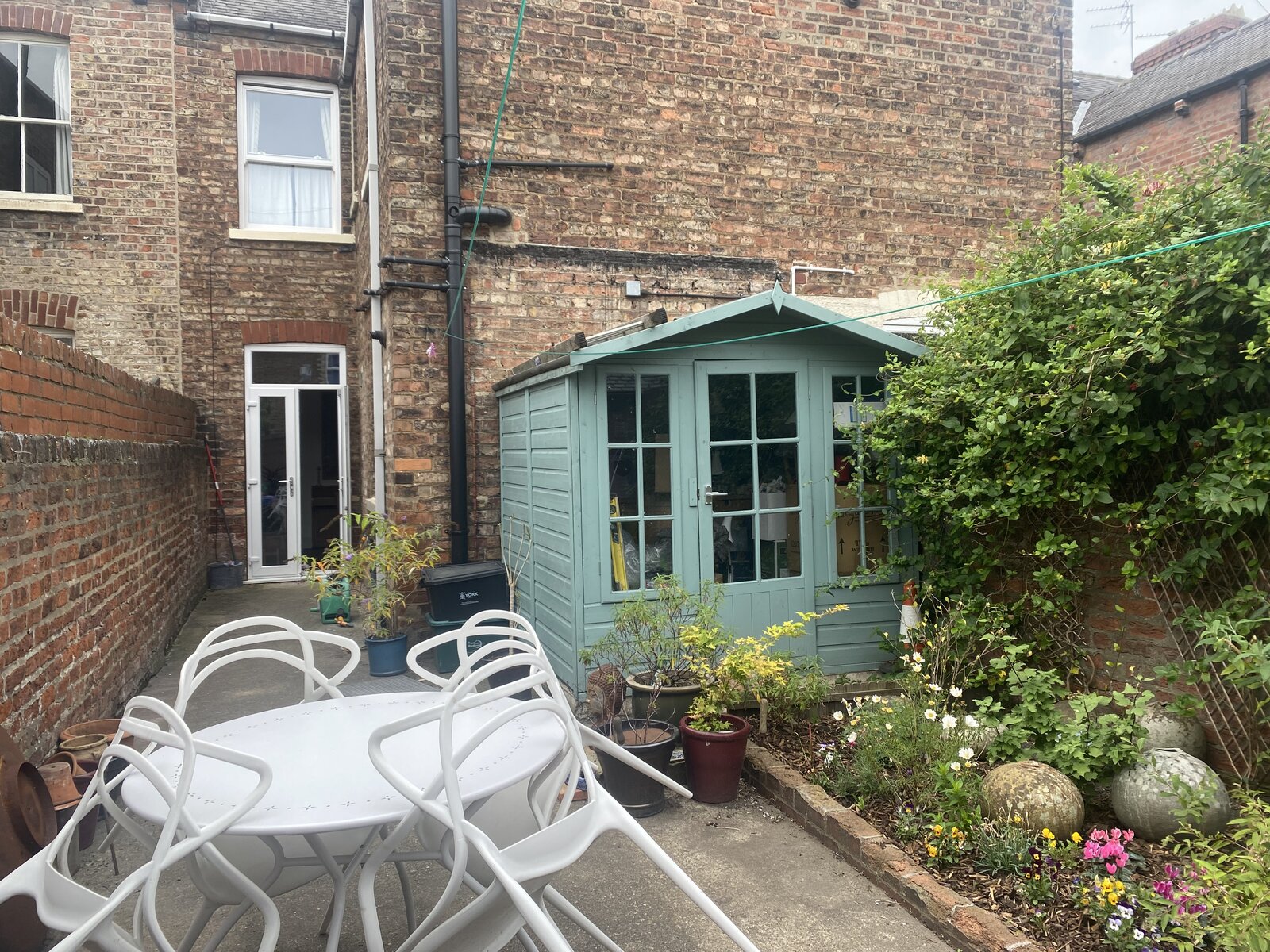

Hmmm interesting. The external ground level is quite high and a shed is very close to the other side of the wall with the efflorescence. Perhaps that is exacerbating the problem?
They may have also used a gypsum plaster which is stopping the wall from breathing? Really hard to know what’s causing it and whether it can be easier solved.

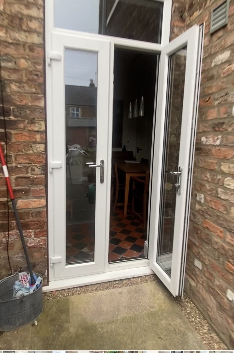

see pics of external ground level
Would prolonged condensation from the lack of heating and poor ventilation not cause effervescence?
Unlikely. Condensation is primarily a surface issue resulting in black spot mould. It's also fickle. You could move a sofa and the issue could disappear. Damp will not behave that way.

you had better scrape away the gravel outside until you find where the DPC is. Mark it with chalk and follow it round the house. Unless you are on a considerable hill, it will be at the same height all round.

It is in a few places mainly along the rear facade (see plan below). It’s also around the living room chimney but only minor here and probably due to not vent in the closed off chimney.
The wall with the shed is where the utility wall is (pics with clothes drying). There used to be an old shed attached but it was removed 4 years ago and replaced with a shed.
