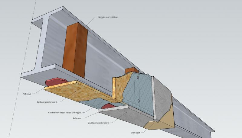

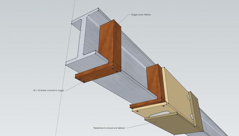

A allanandr Joined 8 Aug 2009 Messages 8 Reaction score 0 Location Kent Country 21 Aug 2009 #1 hi can anybody tell how to box in rsj's for building regs cheers
Shytalkz Joined 22 Feb 2008 Messages 4,864 Reaction score 15 Location Norfolk Country 21 Aug 2009 #2 Domestic? 12 plasterboard and skim coat.
A allanandr Joined 8 Aug 2009 Messages 8 Reaction score 0 Location Kent Country 21 Aug 2009 #3 what about the timber work, sizes spacings etc cheers
noseall Joined 2 Feb 2006 Messages 55,552 Reaction score 4,751 Location Staffordshire Country 21 Aug 2009 #4 allanandr said: what about the timber work, sizes spacings etc cheers Click to expand... 400, 450, 600mm you choose. I prefer 400 or 450 dependant upon whether i'm using 2.4m or 1.8m boards. P.S. it is 12.5mm.

^woody^ Joined 3 Sep 2006 Messages 40,146 Reaction score 6,580 Location West Mids Country 24 Aug 2009 #6 [GALLERY=media, 11419][/GALLERY] [GALLERY=media, 11420][/GALLERY] And here http://www.diynot.com/forums/viewtopic.php?p=1223511#1223511
