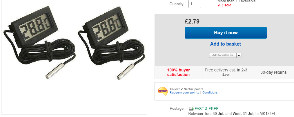

... so wanted to measure the temperature inside the freezer, I tried all local shops, nothing, ...
I don't know about 'local shops', but if you look on eBay you'll find any number of electronic thermometers that can measure down to -50°C, in many cases for under £3 (with free postage).
Kind Regards, John
Kind Regards, John
And I did by the parts from the internet, however the freezer was essential and I wanted it fixed now, not a week latter. I really did not expect to have a problem buying a simple thermometer to read -18°C, every shop with freezers has to test the freezers are within limits, but it seems the items are not sold in normal retail outlets.
... however the freezer was essential and I wanted it fixed now, not a week latter. I really did not expect to have a problem buying a simple thermometer to read -18°C, every shop with freezers has to test the freezers are within limits, but it seems the items are not sold in normal retail outlets.
I suppose it depends upon how impatient you were but, looking a moment ago (Sunday evening), I could order this item (which works down to -50°C), or thousands like it, now from eBay for £2.79 (with free P&P) and expect to get it on Tuesday or Wednesday ...

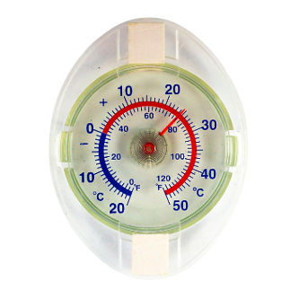

... or, if you have Homebase nearby, you could have one of these (again, down to -50°C) for £3 ...
... or, if B&Q is closer, and -20°C is low enough for you, then for £3.30 ...
... or even this standard liquid-in-glass one, at £3.27, which again goes down to -20°C.
I'm not convinced that you looked all that hard :)
Kind Regards, John

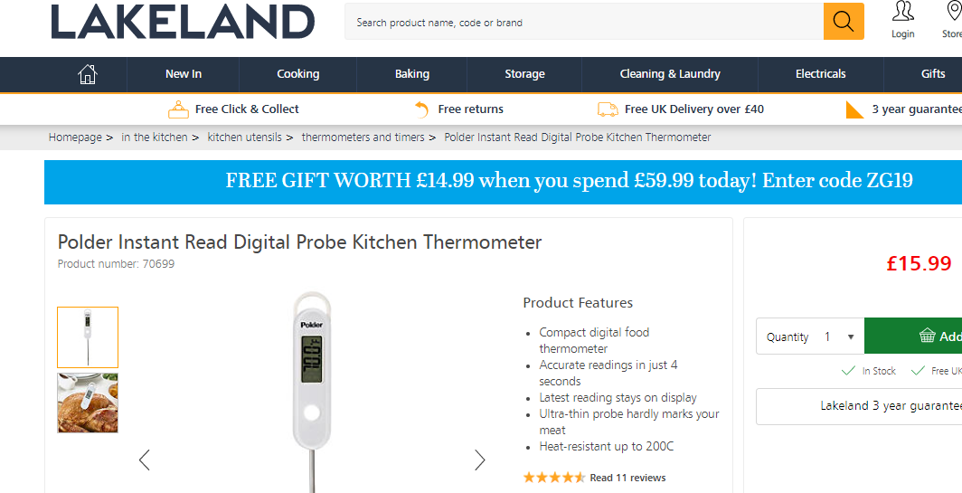

I was trying places like Lakeland and other cooking appliance shops, as said I did get things from the internet which cured the problem, however three days without food is a long time, until fixed I had to take food daily to my mother, for carers to heat up in microwave, I could buy meals which needed just water adding and heating on a hot plate, but typical time was 35 minutes, and carers had 25 minutes total, so needed meals which could be heated in max 15 minutes.
My mother was complaining about meals at the time, hind sight is easy, at -25°C the meals would have needed extra cooking time to -18°C but at the time, didn't know meals were being cooled to -25°C.
