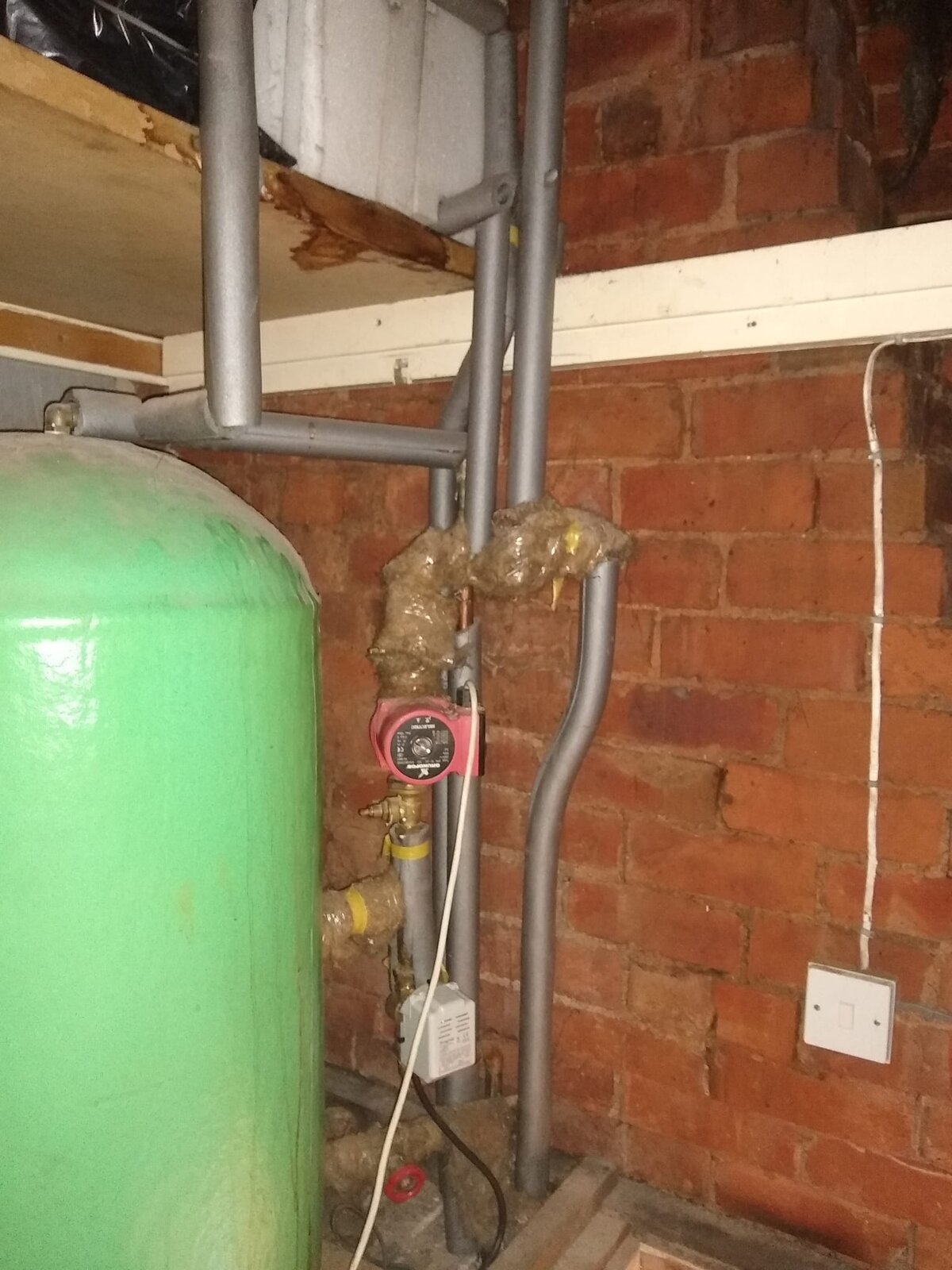

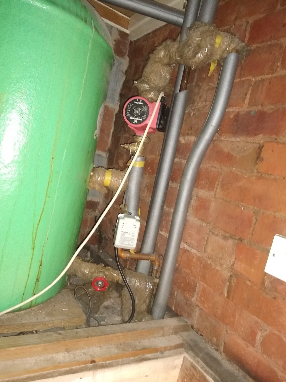

I have some more works in mind but I wanted to get a second opinion before I started cutting into any pipework. The loft setup is below:
The damp bit of MDF below the expansion tank seems to just staining, it's not actually wet.
My plans are as follows:
-Replace the red manual valve on the outlet of the cylinder heat exchanger with a motorised valve so we can independently control hot water and heating. The manual valve has been useful for balancing the heat exchanger with the heating circuit when they've needed to be on together, but we only really use hot water for washing up so it shouldn't be running at the same time as the heating that often. I'd prefer to put the valve before the cylinder and leave the manual valve for balancing but it's a tight gap on the inlet and I could just replace the valve rather than needing to put in any new pipework.
-Install a cylinder thermostat and put it in line with the hot water valve control so it doesn't just run until the water is scalding.

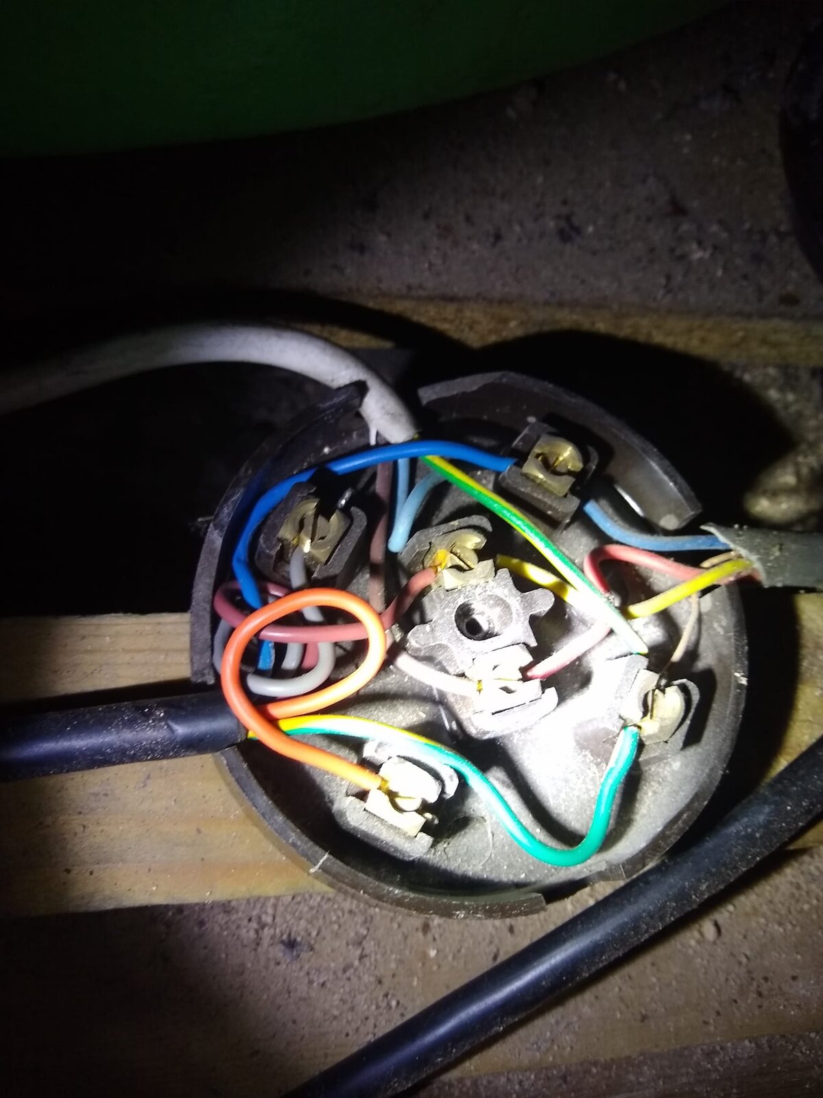

-Run at least three extra wires from the boiler control panel to the cylinder so I can have heating valve control, HW valve control/cylinder stat, permanent live and return valve switch control for the boiler. Currently I only have N/E, heating valve and pump wires.
-I may install a Magnaclean or similar which should help to regulate the black goop buildup. I can't see a good accessible spot that's out of the way so I think the only option may be the return pipe directly above the boiler, which may look a bit fugly in the kitchen.
Questions on the above:
-Have I missed anything obvious? Am I building a pressurised bomb?
-Am I OK to replace the red manual valve as planned?
-Do I need to fit a pressure relief valve anywhere? There isn't a separate one in place currently and I'm not sure where the best location is if needed. I'm guessing after the pump but before the motorised valves, though I don't know where it should drain to. There is a PRV on the boiler itself and I'd be wiring it so the boiler/pump would be controlled by the valve switches. Currently the HW is always open so even if the motorised valve is faulty there's always a path for water after the pump.
Any advice is welcome, even if it's just "you're an idiot, call a professional before you hurt yourself".
Thanks!
