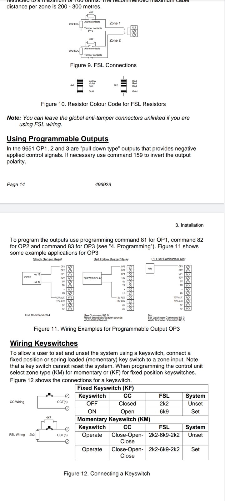

Hi, due to a knackered keypad, I’ve tried to transfer an old 9800 system over to a newer 9651 system, for my parents.
I’ve taken a global tamper approach and things are going OKish.
I’ve powered up the system (linking the kick start pins etc) and I’ve assigned names to the 7 Zones (I’ve linked out the 8th Zone).
There are no errors or warning lights on the keypad but when I go to set the system it says ‘Zone 5 open’.
I’m not sure how the Zones were previously set up (and no cables were labelled!) but it looks like Zone 5 are windows with shock sensors. I’m pretty sure in the 9800 system the shock sensors were set up to ‘OP1’ and 0V Aux (??) – does this sound feasible?
I’ve tried to replicate this approach on the 9651 system. However, on P.20 of the 9651 manual it shows the control unit panel outputs being wired up to the +12V Aux terminal. (I’ve put the shock sensor on OP3 as OP1 and 2 are taken up by the bell and strobe from the bell box).
Before switching wires over and just trying the +12V approach, could this be what’s giving me an open Zone?
Shocks require a 12v aux feed, so should have a pair wired into the zone and a 12v feed from AUX

Probably no surprise, but your comment is in-line with what the manual says! I will try re-wiring into 12V AUX. Would wiring into the 0V Aux give an 'open' Zone when trying to set the system?
Maybe I mis-labelled when I disconnected the 9800 system but is there any reason why on the 9800 system the shocks would have been wired into the OV Aux (and not the 12V)? If not, then I probably did just mis-label.
The 12v would have been through a relay to reset the vipers when the system is armed so you know which one has activated in the case of an alarm
Thank you, Bigsoij. Sounds like I should re-wire into 12V (like the manual said!). I was just wondering if wiring into 0V would give an 'open' Zone.
This is how it should be set up

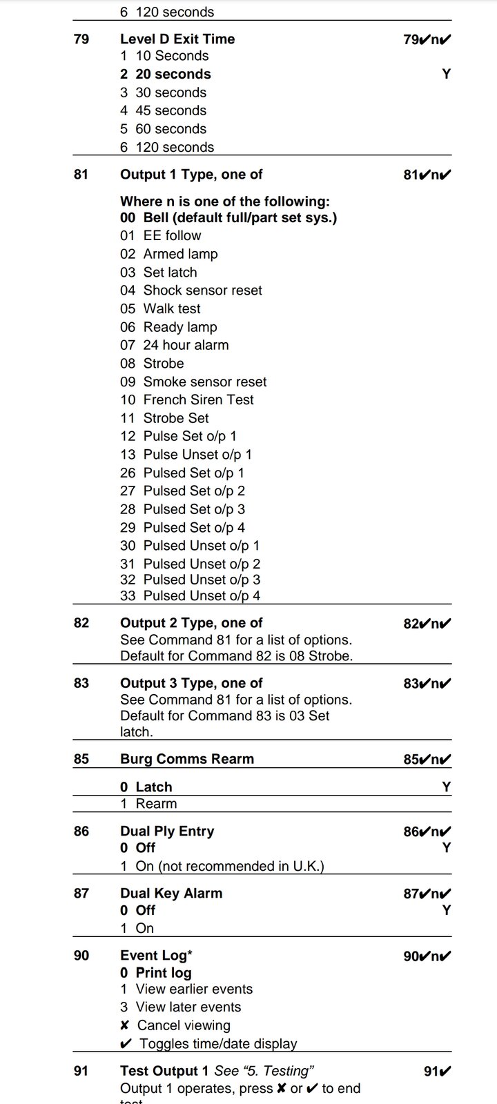

The plan was to swap the black wire to 12V AUX HOWEVER, following the schematic in the manual I wired
+ve VIPER terminal (red wire) to 12V AUX in the control panel and
-ve VIPER terminal (black wire) to OP3 in the control panel.
I can now set the system (yeah!) but as soon as the exit timer finishes the alarm triggers and points to this zone.
Any idea what I'm doing wrong?
