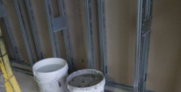

Do they honestly make party walls in stud partition form?
Yes.
That was taken on a recent visit to a new build block and shows one side of a half completed stud party wall. The walls will get plywood pattresses to carry various things like TVs, media centres, heaters, kitcheen cabinets, etc plus the wiring and some mineral wool sound insulation, but other than that they are just double boarded each side with 15mm PB (not even sound block - even the last one I worked on was better than that. This is why I for one am not keen on new build apartments (leaves to sound of song, "Little boxes, little boxes, And they're all made out of ticky-tacky...")

I thought they would at least use blockwork with sound deadening qualities. Can just imagine newly-weds having their fun curtailed when they move into their brand-new home!
I've worked on a couple of refurbs now, and I can tell you that they don't. Best you can hope for is something like four layers of 15mm soundbloc and some mineral wool between you and next door. We are building tomorrow's slums with these things
