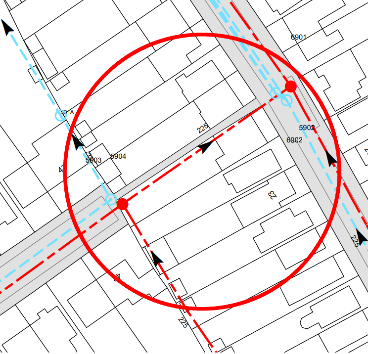

We are close to exchange on a house constructed in the 1930s and the searches indicated that a 225mm foul sewer is within the property boundary running longitudinally underneath the house. There is another sewer at the end of the garden.
Search also revealed a water main (in blue, size unknown) running down the alleyway adjacent to the house but out of the property boundary. The alleyway is quite thin so I estimate the distance to be around 1/1.5m to the wall of the house.
There is a question mark on whether the house has already been extended to the rear over the sewer. Surveyor thinks that it might be an extension due to different construction materials but he cannot be certain. Sellers soc says there is no build over agreement in place and no indemnity insurance will be provided.

The main house was built in 1930, would they have built the property over a sewer that time? I’m wondering if the sewer map is incorrect and it is actually positioned down the alleyway at the same location as the water main. The man hole position indicated on the map also appears to be incorrect and there doesn't appear to be any manholes on the property. Can a CCTV survey accurately determine if the sewer runs underneath or down the alleyway?

If you look at Thames Water website the criteria for build-overs the criteria is usually pretty clear as to what they will and will not permit, the drainage maps can be notoriously inacurate sometimes by tens of meters. But that map suggests there are manholes in the road in front and to the rear of your property? Drains can be accurately surveyed to find their location, a CCTV and possibly an above ground tracing survey would be wise to find out the size, depth, condition and exact location if you plan on developing the property further. You would have to do that anyway if you were to extend.
It was only in the past 10 years or so that the water boards adopted public sewers, so if the house was extended well before that time, then a build over agreement with Thames wouldn't have been necessary as they'd have not been the owner.
If the house ticks all of the right boxes, it wouldn't put me off. You can get an agreement now for building within 3 meters, I did so and it was with Thames.

TW will expect you to pay to survey their pipes / drains and tell them where they are
