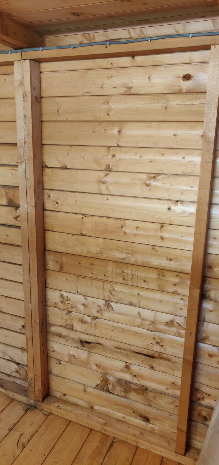

Im looking to insulate my shed using celotex and just have a couple of questions in the hope of clearing up some contradictions I have discovered during research.
My shed is pretty heavy duty, constructed out of 3x2 framing and 25mm T&G cladding. Ive read conflicting views about the placement of the celotex, that being to fit it tight up to the cladding so no air gap, or to leave an air gap.
Unfortunately the shed was constructed off site and assembled on site by the supplier and no membrane was installed. I do have a little water ingress poss due to a knot or shrinkage in a joint which I will remedy.
I was going to fit the 75mm celotex right up to the cladding, then board the inside with OSB or other. I assumed that the foil backing on the celotex would act as a vapour barrier, along with the OSB (which I would also paint/treat). In my head, the warm air would be contained within the shed and the insulation would prevent the internal warm and cold outer surfaces from forming moisture.
I dont really understand the need for an air gap between the inside of the cladding and the celotex, as this will also be a sealed space with no airflow.
Would appreciate some clarification before I commit!
Cheers

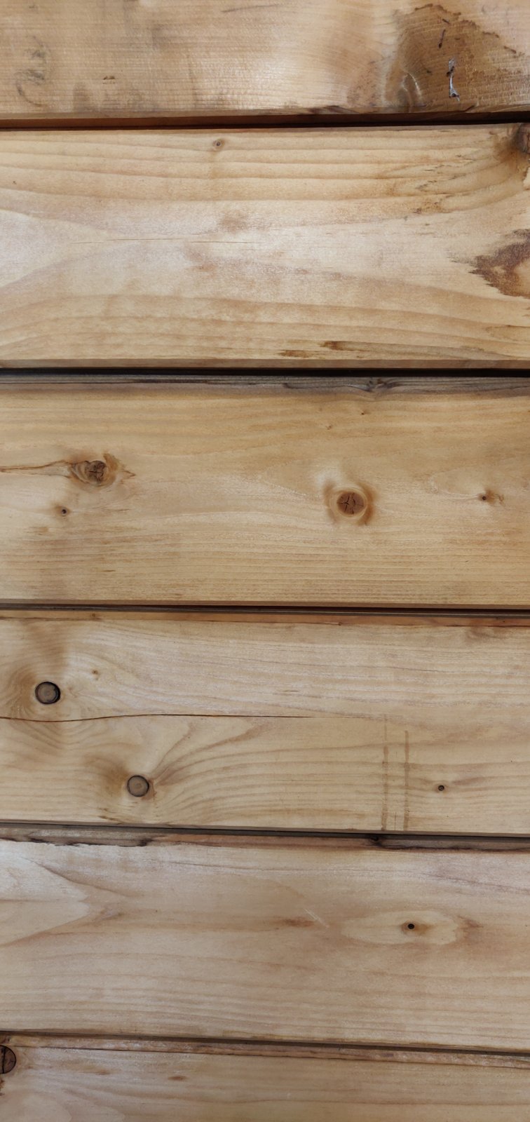

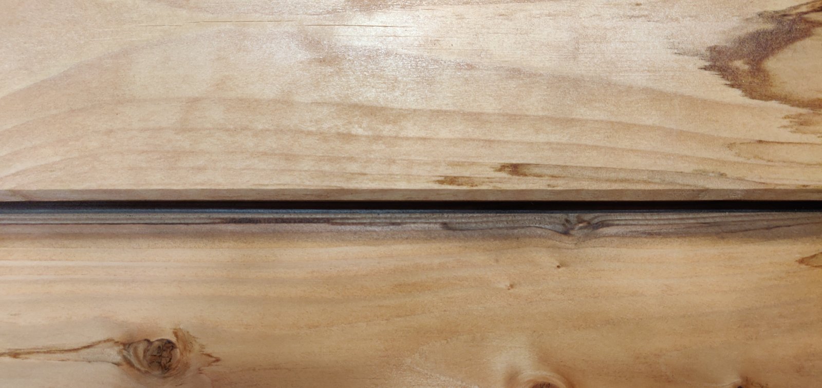

Would it be advisable to inject a flexible sealant between T&G timbers that have shrunk a little as some do let in a little water. I don't know how else to remedy this.
You don't need a moisture barrier the foil backing is fine, you just pack it in and plasterboard. Built my own garden room this way and never had any problems. I can heat mine in the winter with a very small fan heater. It only needs to be on for 10 or 15 mins or so..
The reason is because a timber frame structure is designed to be completely weathertight before any cladding is fitted. Once fitted the cladding is a decorative covering thst protects the structure from sun, wind and rain. The cladding doesnt have to be fully watertight, any water that gets through just runs down the cavity and out. The cavity allows air movement so the cladding dries out again.
A shed is a bit of a compromise, it has the cladding fitted directly to the framework, sheds arent airtight so water or moisture thst gets in will dissapate.
If you push the celetex tight to the cladding you might increase the risk of damp building up. It would be best if the cladding did have a few gaps to allow air flow a bit. Some people leave a 1/2" gap to help.
Thanks for the additional advice, I understand a lot better now.
Two of the sides of my shed are difficult to maintain and are actually out of view so I was thinking of covering these with corrugated pvc, EPDM or other such material to minimise water ingress. I think I'll go with a 50 or 60mm celotex with a 15 or 25mm air gap.
Should I at least seal some of the gaps I have seen between the t&g?
