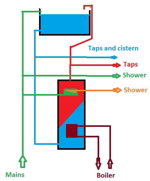

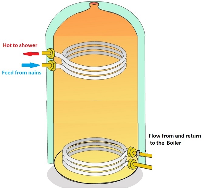

My solution was a bespoke vented hot water cylinder with a second coil in the top of the cylinder. This coil is fed with mains pressure water to be heated to feed the shower. Cold feed to the shower is also main pressure.
The cost of this bespoke cylinder in 2011 was under £200

Any links to product. Is it basically an unvented cylinder in a vented cylinder. Will this set up need an expansion vessel? What volume is the hot cylinders? Thanks
The green/orange in the diagram is a coil inside the tank. No requirement for expansion tank as the voulme in the coil is less then 15 ltr.
The nominal capacity of the cylinder is 117 ltr It is a standard 900 X 450 with the second coil added to order.
Rereading. It is a coil heating element near to a mains cold supply water pipe passing through hot water cylinder. I'm surprised the water will heat up enough once it flows to shower.

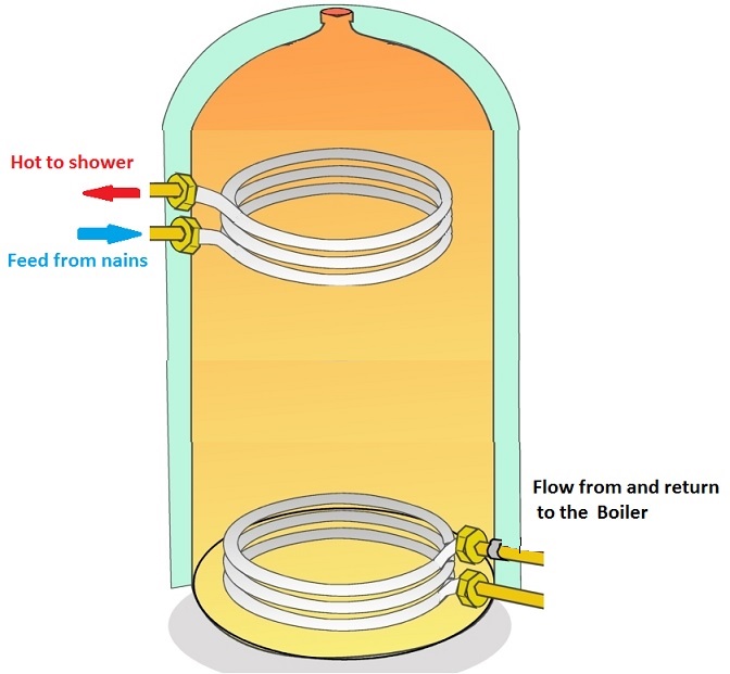

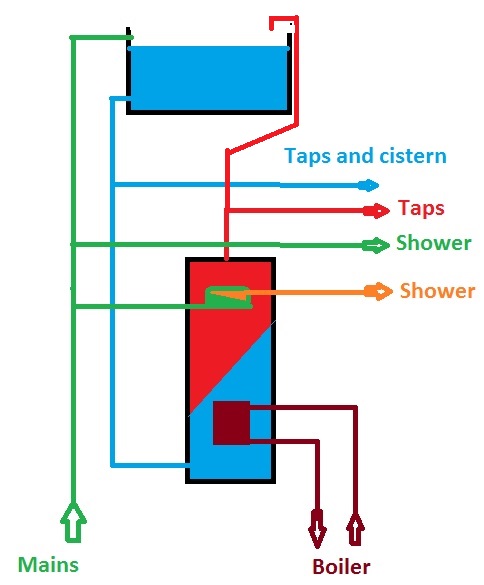

I'm interested in this coil set up. WonderING if the cold mains pipe 15mm? Goes above the heating coil?
