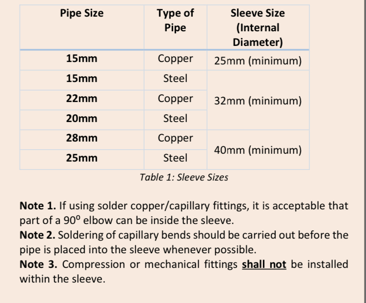

I came across this bulletin which is published in Ireland:
Sleeving Discussion - alternative approaches
It discusses the different materials suitable for sleeving. But leans on a recommended material for the sleeve. I have often seen plastic pipe being used here in London. I am curious as to why its not the go to recommendation in the bulletin. Looks like theres a discussion to be had.
It also includes a table detailing sizing, length and a discussion of joint types within the sleeve.
It qualifies that a fire retardant mastic sealant needs to be used too. But I imagine there are differences in the quality of different brands. I'd rather have a high quality product from a reputable brand that will last, over whatever is in the back of the van at the time. I'm willing to pay the difference.

C) ANNULAR SPACE - each gas engineer did not know if there is a required sleeve diameter for 22mm gaspipe. As you can see, the Irish Bulletin has a table specifying the diameters of the sleeve vs the gaspipework. It is clear and specific.
All three (and I mean all three) engineers could not confirm the recommended specific sleeve diameters in England. They said (summarised) '...as long as it protects the pipe and gives some clearance'.
However : this table from the Irish bulletin DOES specifically give recommended diameters:
Again, these standards are not written for where I live, but for ireland.
And because three separate gas engineers could not help me with this aspect either - I felt It's fair to ask for assistance here, from the community.

The sleeve doesn’t matter too much as long as it doesn’t cause any electrolytic corrosion and can is suitable of being able to carry gas. Annual space should be just one size higher. The sealant should be a non setting type, so your 3rd engineer is correct.

The sleeve is to protect the pipe from mechanical and chemical damage from the wall fabric and to prevent gas entering the cavity or other void in the event of a leak. It is not to protect the pipe from fire and/or heat. Remember that the pipe will be subject to the same or greater heat either side of the sleeve.

BS 6891 Regulations 8.7 sets out the requirements.
