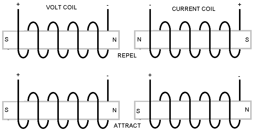

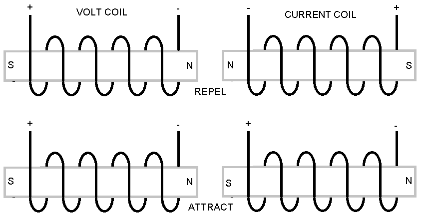

There are various types of motor.
Permanent magnet DC motors have a permanent magnet creating the field, and moving coils supplied by a commutator, this which keeps the field created by the coil at an angle to the field from the permanent magnet producing a rotation moment. To reverse them you reverse the supply polariy.
Universal motors have both moving and static coils, but are otherwise similar to the permanent magnet DC motor. To reverse them you reverse the supply to one of the two coils, if you reverse the supply to both coils then the motor keeps turning in the same direction. This allows them to run off both DC and AC.
It strikes me that if you built something along the lines of a universal motor, and powered one coil from the voltage and the other coil from the current, then it's rotation direction would depend on the direction of power flow.

Good question, one has to start by taking a snapshot at a moment in time, there are 2 options:
That explains the reversing action.
As a DC motor turns the commutator will cause the current in the armature to reverse as the magnetic poles are in the matching position.
That same motor should work on AC too as the current direction is always in the same direction in both coils but the commutator still reverses the armature current as appropriate.
Exactly- that's how I've always understood that such things work. Sunray was, I suppose, fairly close in what he suggested, but he did not make the crucial point that there were two coils, powered in different ways.
With what you and I are talking about, it's essentially the phase difference between the currents in the two coils which achieves the desired result(even in the one 'powered by voltage', it is the resultant current through the coil that matters).
Kind Regards, John
