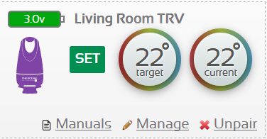

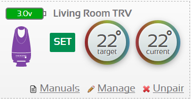

So the sequence of events, each radiator has the lock shield valve set so around 15°C difference between incoming and outgoing water. It takes a TRV around 10 minutes to close, so you don't want radiator heating up too quickly, or the TRV can't react fast enough, and the temperature overshoots. My TRV showed target and current and once it had been running for around 2 hours the two should be the same, if the current was over target I closed the lock shield and if under opened lock shield by a very small amount.
As the TRV closes the water is first pushed though the TRV's still open and then the by-pass valve opens, which returns hot water to boiler, and boiler reduces output, so the radiators are only just warm enough to keep room at set temperature. So heat from other source like the sun, the radiators have not got a lot of stored energy, so can adjust output quickly.
So I used the report from the TRV
to set the lock shield valve. The problem is a mechanical TRV does not have °C on its scale, so I moved the electronic one around to set the lock shield valve. Once lock shield valve set, could put mechanical TRV back, the problem was with a mechanical TRV and lock shield you don't know which one to adjust. So using an electronic with °C you know which to adjust.
