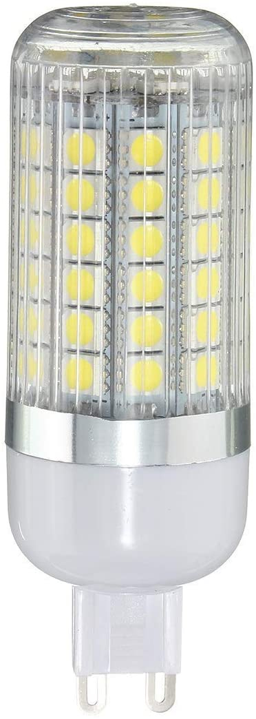

I used Energenie smart light switches, with large bulbs OK, but with small G9 LED been a problem. They don't use a neutral but clearly there must be a small current through bulb when off, has to get power from some where.
So can flash when off, cured using a load capacitor, and can shimmer when on, this bulb G9-small.jpg was a problem this one G9-big.jpg worked OK, one of the larger bulbs failed so I took apart, found dry joint, fixed and now back in use, but while apart realised it has a smoothing capacitor after the bridge rectifier, current control also a capacitor.
The problem is no one says how an LED works, so it is suck it and see, ordered spares when the one failed and also quartz with 4 of the G9-small.jpg and 1 quartz they worked OK, but not all 5 LED of that type, and this type G9-big.jpg was much whiter and looks odd if you mix, so now have 5 small spares, 10 quartz spares and 4 large spares and only 6 bulbs of that type in whole house. Can't see I will ever run out of G9 bulbs.
