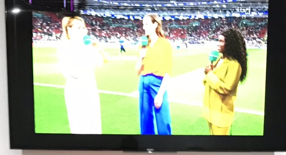

I have a Sony 55" 4K TV (Model No: KD-55X9305C) which I got a few years back. The screen is damaged at the top left where it looks like pressure was applied by the previous owner (forgot to take a picture before I took it down but there is a picture where the TV was in the background - see below). I have some downtime and decided I should try and repair the TV if possible.

TV image broken in the top left corner and lines going across

If your hobby is one of carrying out such repairs, and you can pick up a replacement screen really cheap from a scrapped TV, then it is maybe worth you tackling it - keeping in mind something may well go wrong. Otherwise, TV's are so very cheap, they are simply not worth the effort of a major repair, based on the cost of major replacement parts, and the difficulty of sourcing the parts, especially for an older TV. There is a good reason why so many of the one time TV repair businesses went out of business.
Google found me https://www.tvparts.co.uk/lcd-tv-sp.../yd5s550htu01-lcd-panels-for-sony-kd-55x9305c no stock but £300 mark when they were.
Panel availability will be the biggest challenge on a 7-year old set (2014/15 release?).
Screen faults usually result in too expensive to repair on most TVs.

I repair everything, but replacing the lcd panel is not cost effective.

My cousins an ex Sony service engineer , he said he has never changed a screen as it’s not a viable repair , easier to damage during the process than repair .

Thanks both, the posts above seem to agree with your views. I couldn't find the part so I couldn't really assess the cost/benefit. I'll make do with it for now but keep a lookout for another TV :)
