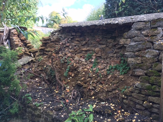

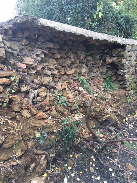

I have a stone and mortar garden wall (not a retaining wall) that has partially collapsed. It is approx 1.8m high in places and there is a length about 3.5m that needs rebuilding and repair. It has only collapsed on one side (double thickness stone). I have been struggling to find tradespeople to quote, and the 2 quotes I have received (c£4.5k) I do not have the budget for (I do not know if that is the going rate). I think it is beyond my capabilities to DIY, certainly safely. Any ideas what else I could do to repair the boundary on a smaller budget? I don't think fencing would be an option. Any advice gratefully received!
The going rate is the price in the quotes you have received as those quotes represent costs from traders willing to do the job. Alternatives would be blockwork or brick if a fence won't cut it. All you can do is try to get more quotes.
If you don't fancy doing the stone repair yourself, is there sufficient wall left to fix shuttering and infill with concrete. It'll look pants, and you'll have to do it in careful stages so as not to overload the remaining wall, and shuttering. The shuttering will need some substantial bracing from the ground along its length, and you'll need to be sure the remaining leaf is in good enough repair to hold the wet concrete.
If the concrete bursts the remaining leaf or the shuttering you'll be in a worse state than before.
Alternatively, place some timber lathes along the gap as a guide and repair the fallen stone and mortar. Are you sure it's cement mortar?

Pat ex - I had thought about infilling with concrete but I'm not convinced it is the way to go as it is likely to cause more problems.

Here are some photos...
if 4.5k restores this wall to its former glory. then its excellent valuel. It wouldnt suprise me if doing it in horrible looking concrete blocks could be 4.5. And how good is the rest of the wall, probably needs pointed up.
If you don't have deep pockets that wall is a problem. Even in filling with a fence (I know you don't want that) will not be cheap, there is a lot of material to get off site, then stabilise the open two ends, then do the fencing!
