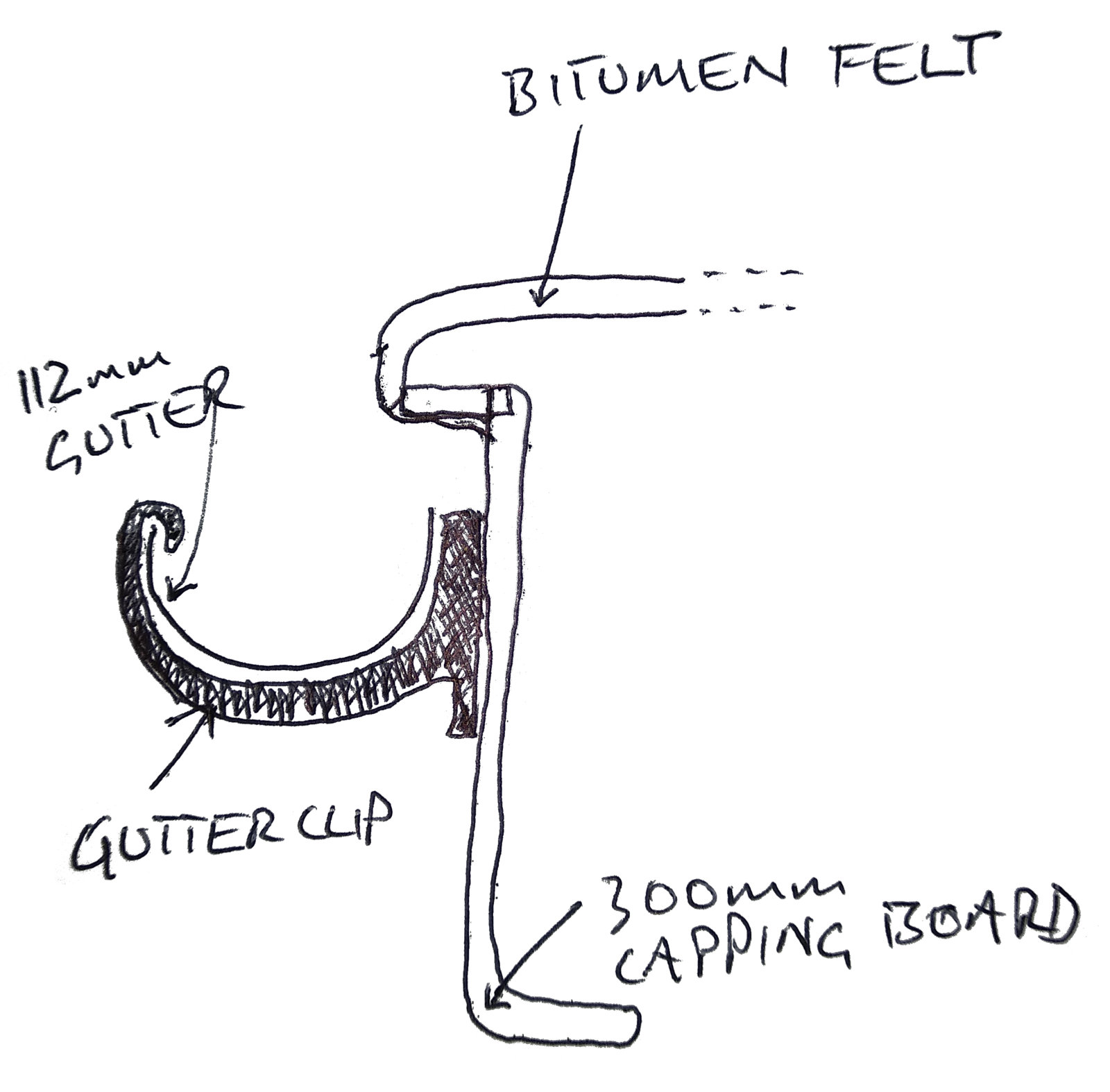

Get a felt roofer to correctly form new drips.
bodge it up with a load of ****e then as below.... or do it properlyI thought this Forum was supposed to be a DIY Forum
wtfStick self adhesive Flashbanding on the roof edge ( the wider the better) and guide the flash banding into the gutter length ways , then paint the flash banding edge with flat roof repair sealant .
