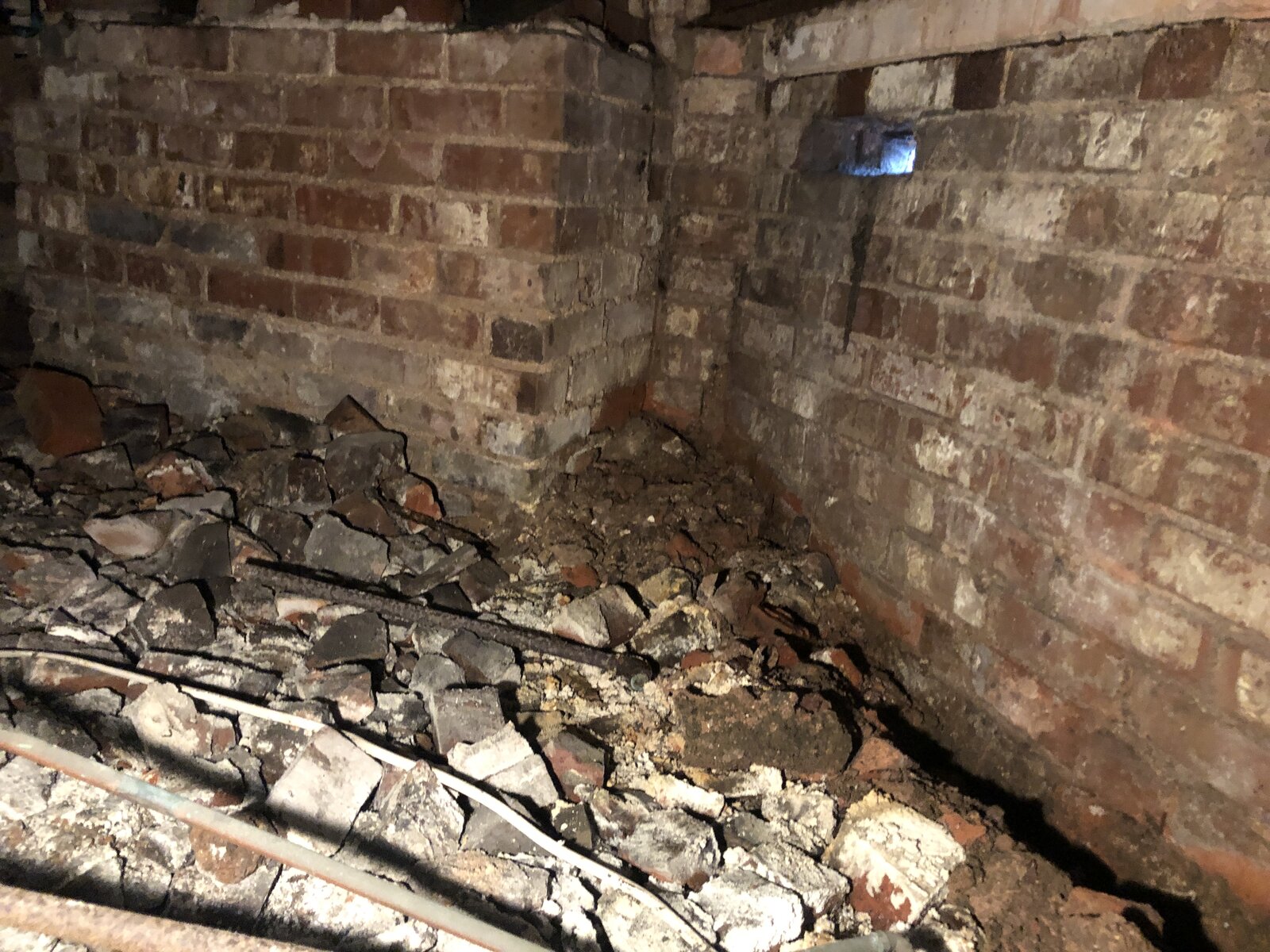

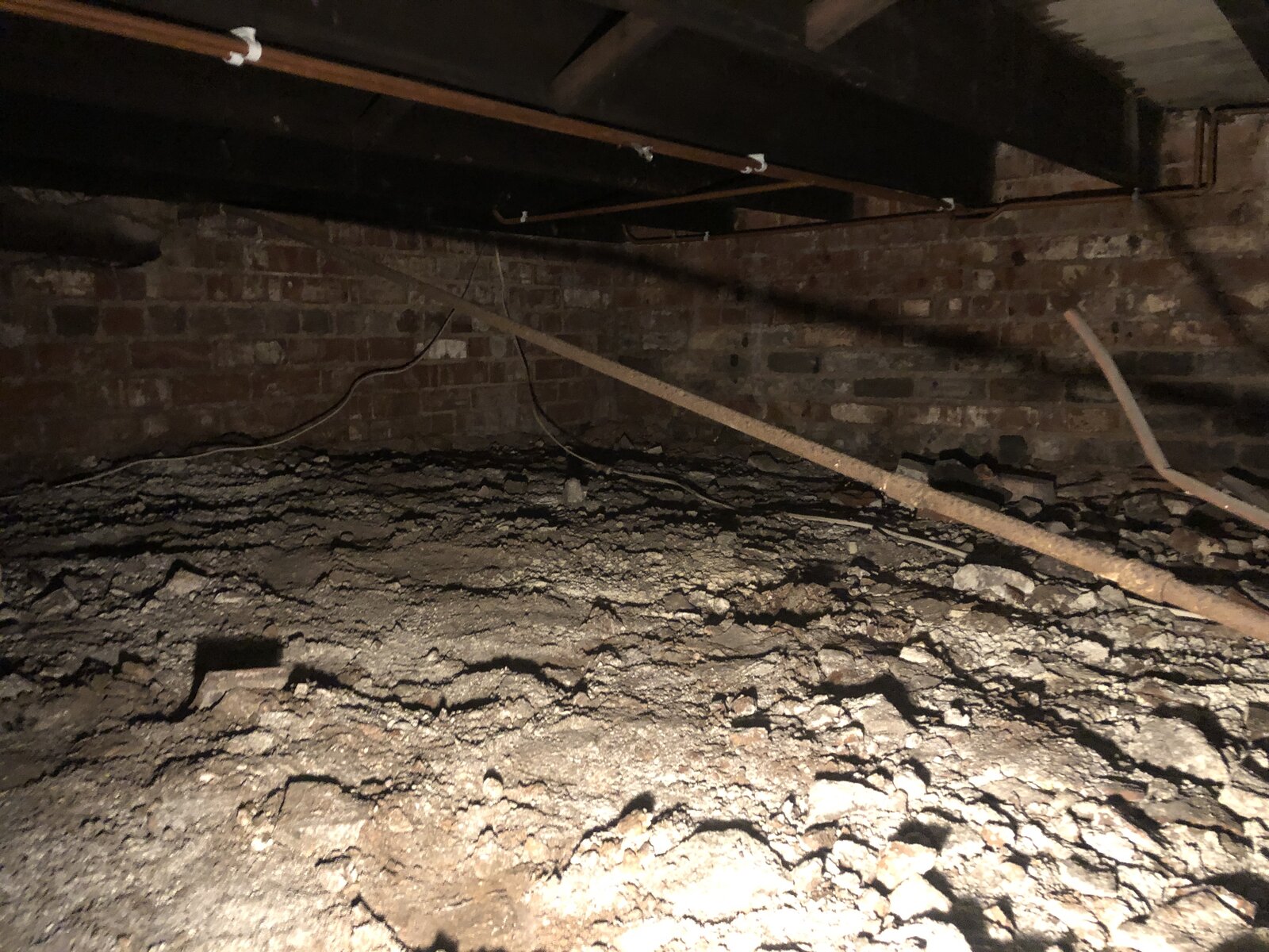

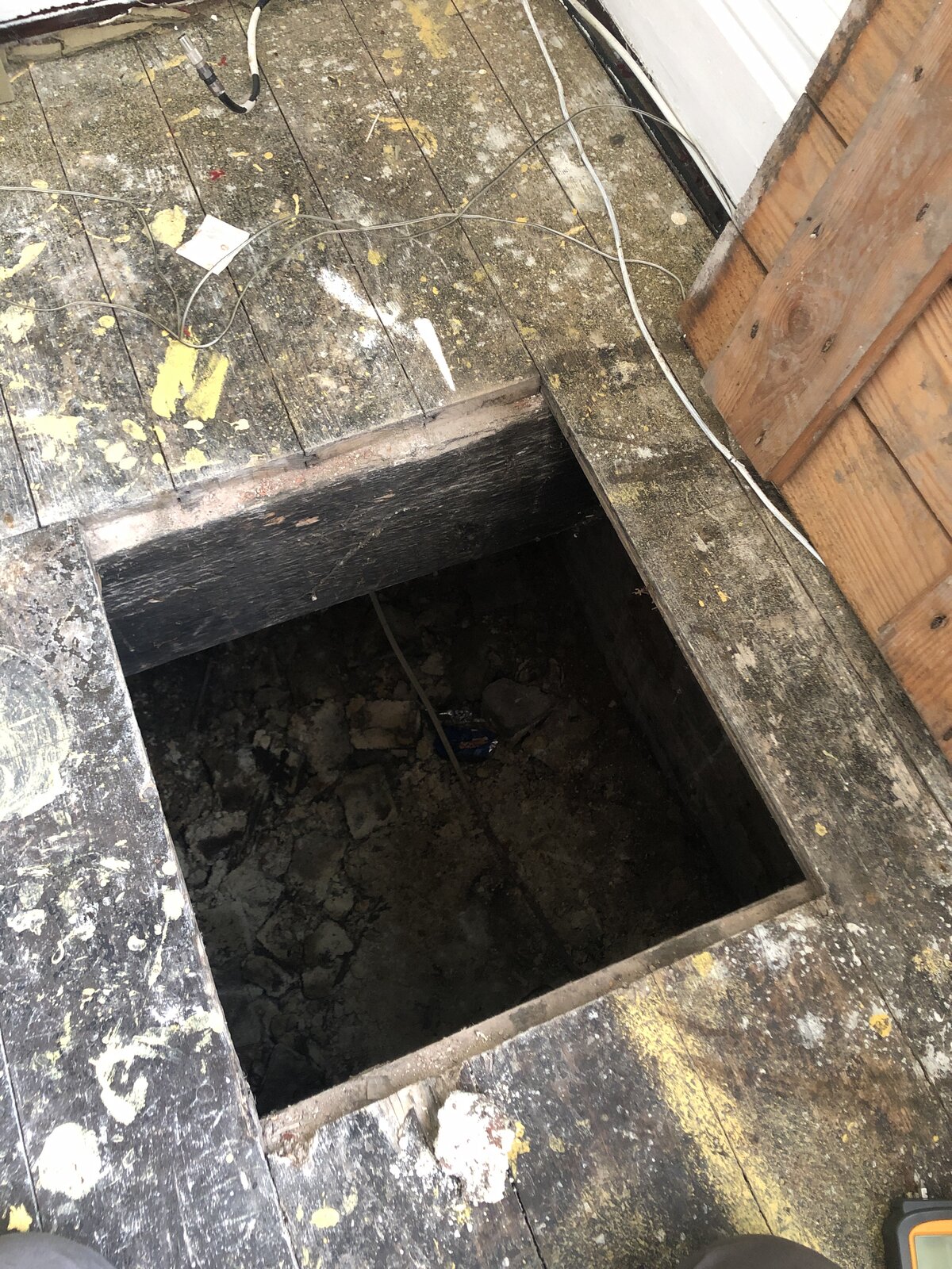

I am insulating my suspended wooden floor in my 1910 built house, I have gained access to the sub floor which has about 5 ft of space at its deepest.

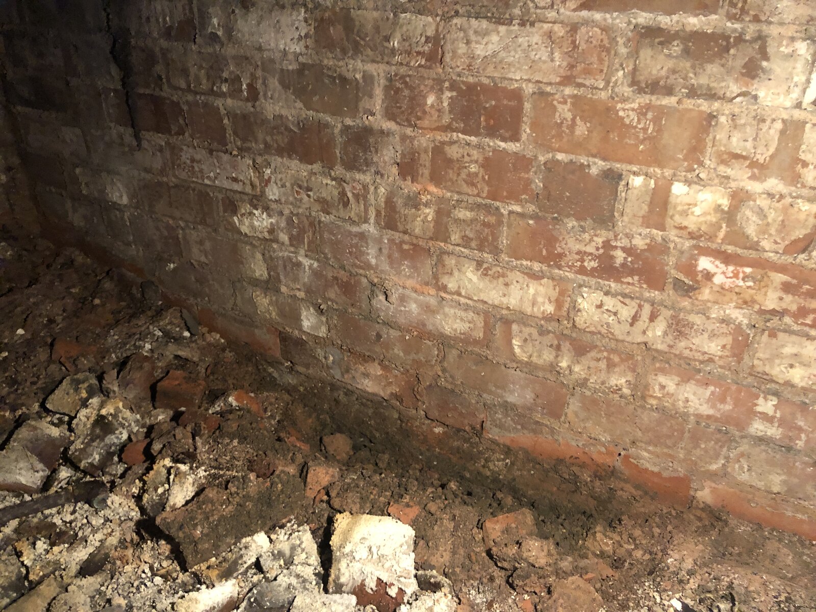

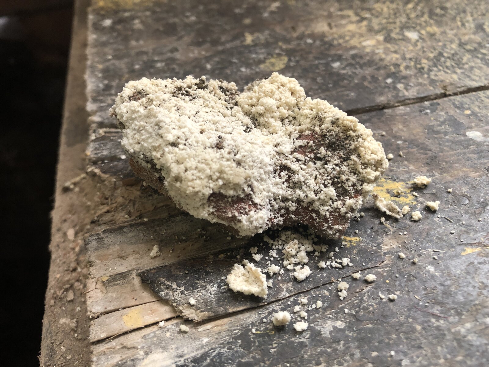

The sub floor soil and rubble is covered in white efflorescence/salts and is rather damp about 37% on the moisture meter.
The walls about 12% and 17% moisture with no signs of any rot or decay at all. I have semi adequate ventilation bricks at 90degrees as its only sub floor in the house.
The room itself in winter is very cold and damp and my suspicions is this is rising from the sub floor soil.
Question 1 - Should I to leave the subfloor/rubble as is or should I place a large plastic damp proof sheet down and seal this around the edges the best I can?

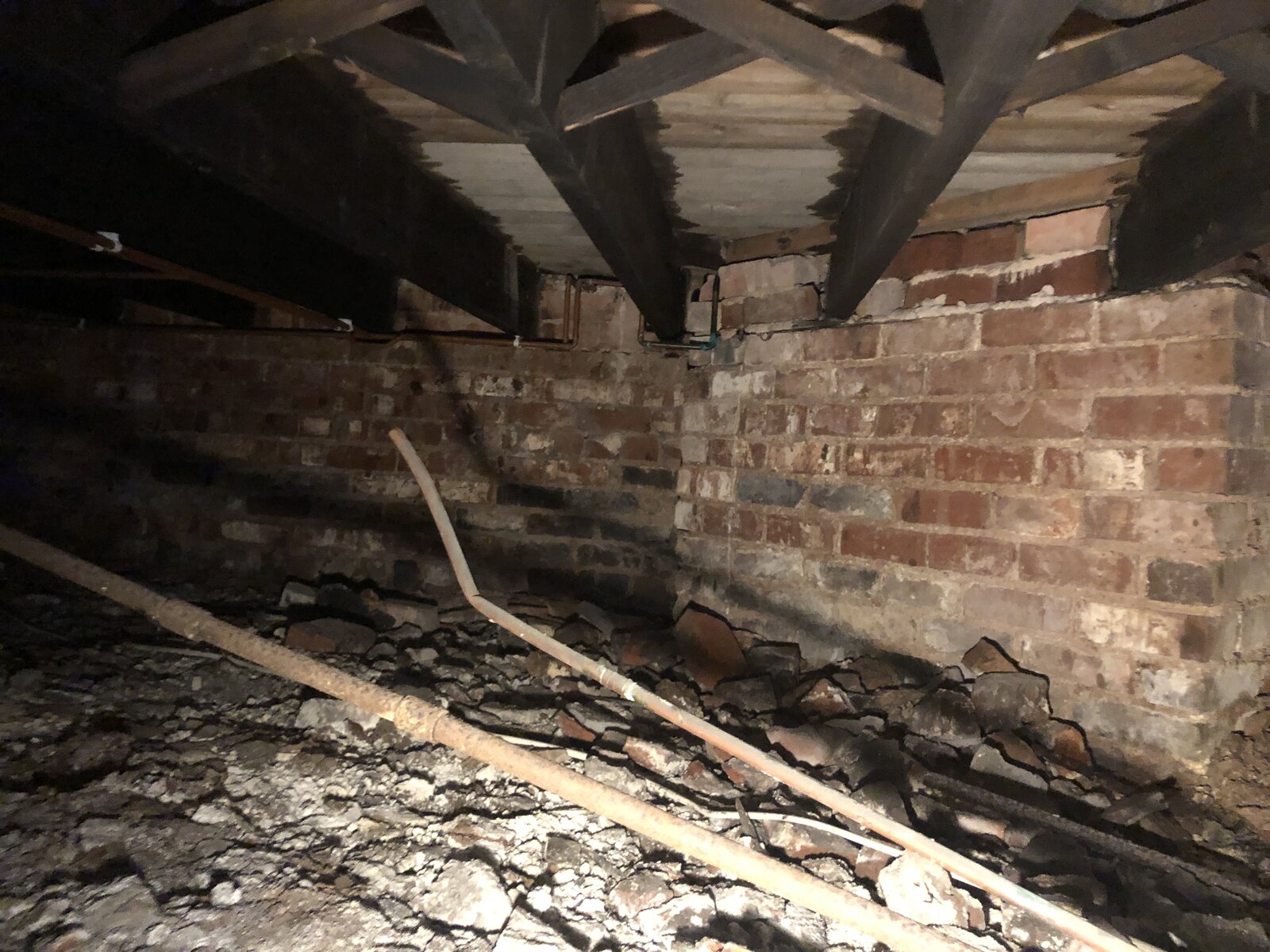

I have joists 43cm apart and 30cm deep (yes they are huge) do I use a 46cm insulation slap and squeeze it in?
Should I double the mineral wool insulation to have 200mm (2 x 100mm doubled up) and just staple my membrane/support 10cm up from the bottom of the joist? Or fill the entire 30cm joist up?
Question 3 - I have lots of breathable roof membrane left over which I was planning on using to support the insulation, will this be ok?
