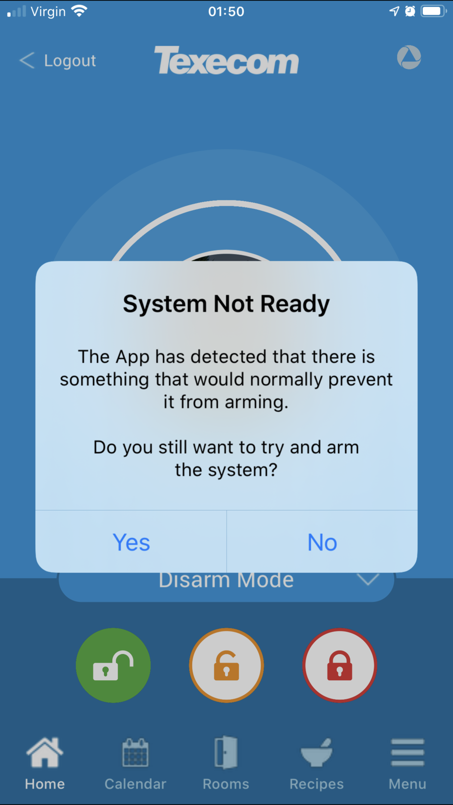

If you can set it from the keypad then there are no system faults to address.
Is there anything in the event log?
If you wish to re install the app, generate an app code from the manage users in the app, then you can clear the cache for the app, then use the app code generated within 60 minutes to re install the site.
