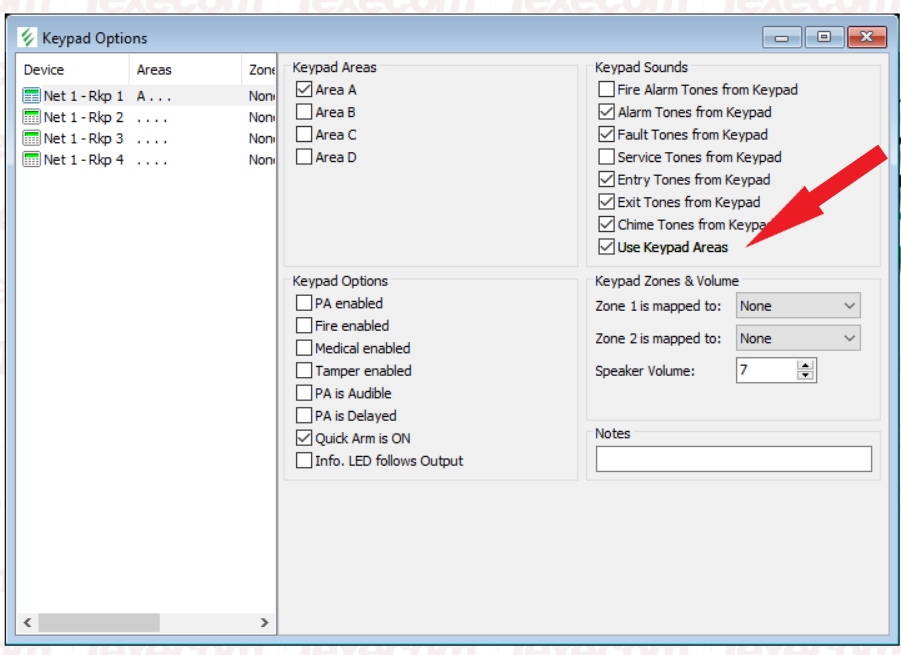

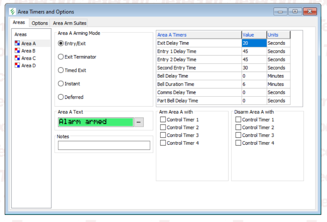

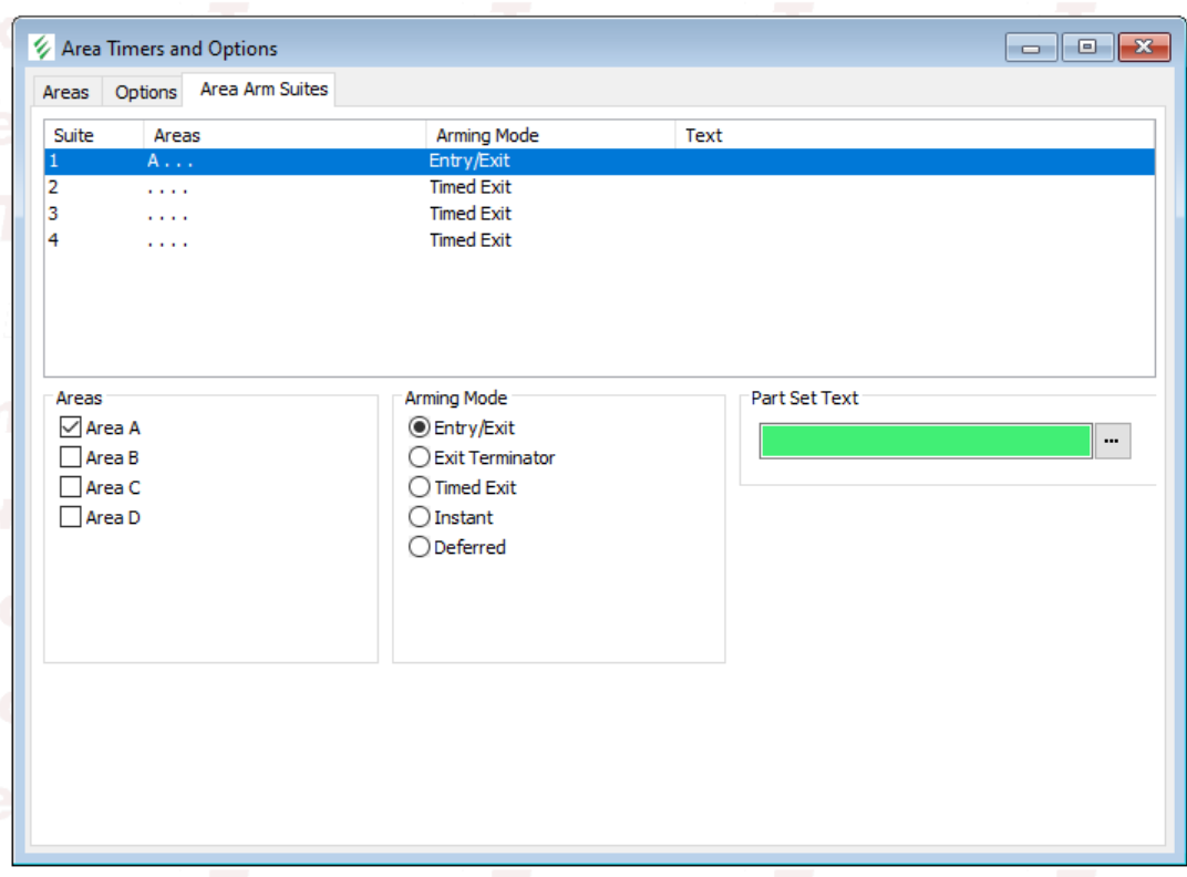

I have a Texecom elite 48 (V6.02) with Smartcom (V4.01). Its been fine for the last couple of years, but now my little granddaughter has started to stay over some nights with us I decided to use the part alarm function to disable most of the PIR's downstairs in case she goes for a wander at night !
The Full Alarm button works fine as a way to Quick Arm as we leave the house - no issues there.
I'm using Wintex to monitor and program via IPcom. I have ticked the "Part 1 Omit" in all of the zones I want to disable. I am only using area A.
But when I push the Part Alarm button all I get is a message saying "Suite01 ArmArea / A..." After 10 seconds this goes off and alarm is still disarmed.
I'm struggling to see what I've missed in the setup !
Can anyone give me some pointers ?
Tony
