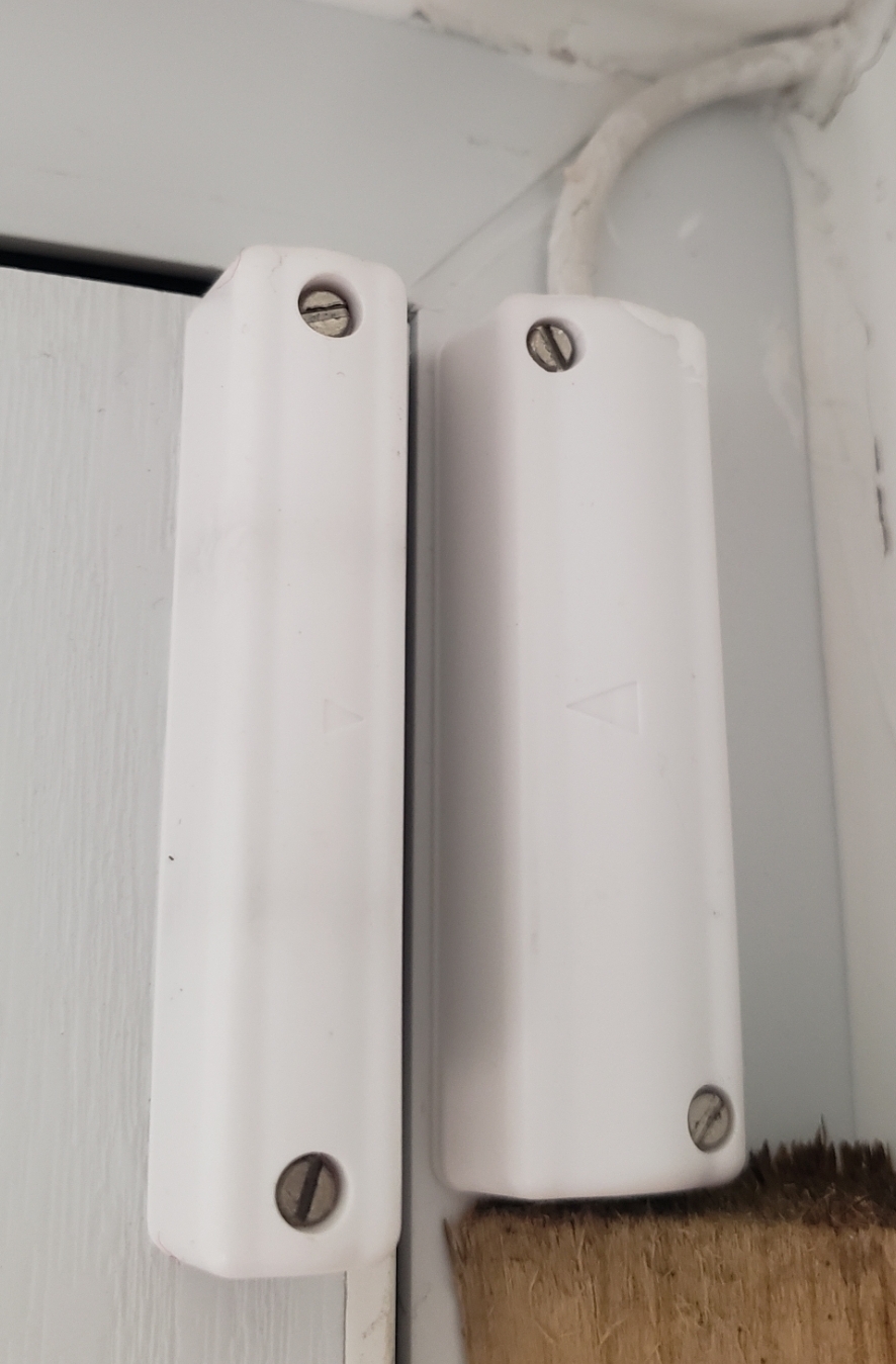

Hi all, I am hoping for some help with a family member's alarm system that was installed at the same time the house was built. It is a Texecom Premier alarm and the main door sensor seems to be faulty. I have armed the sytem with the door shut and the exit beep is still intermittent rather than one continuous tone.
I tried gently tapping the sensor on the frame with a screwdriver but this still did not rectify the contact sensor. Can I buy any wired door sensor to replace what is there? Do I need to put the alarm in maintenance mode before I swap the sensor?

Depends on how it is wired,but could possible resolve with photo of wiring unless cable has been damaged.
CQR SC570 I believe from image I have just seen, but don't know which one as not seen the inside.
Here's an image of the door sensor:
Need to see wiring inside contact.
This could cause a tamper alarm when cover removed off contact. Code number should stop alarm.Tamper alarm may require engineer reset.
If the door has been heavily banged then the reed could be fractured. Have had problems with CQR contacts with the reed not soldered correctly and the reed comes away from the contact terminals and then needs to be 're soldered back to sort.

It turned out to be a SC570/WH/MULTI that the fantastic people at CQR sourced for me. I can't recommend them highly enough!
Also big thanks to @secureiam who talked me through the process of replacing the door sensor.
