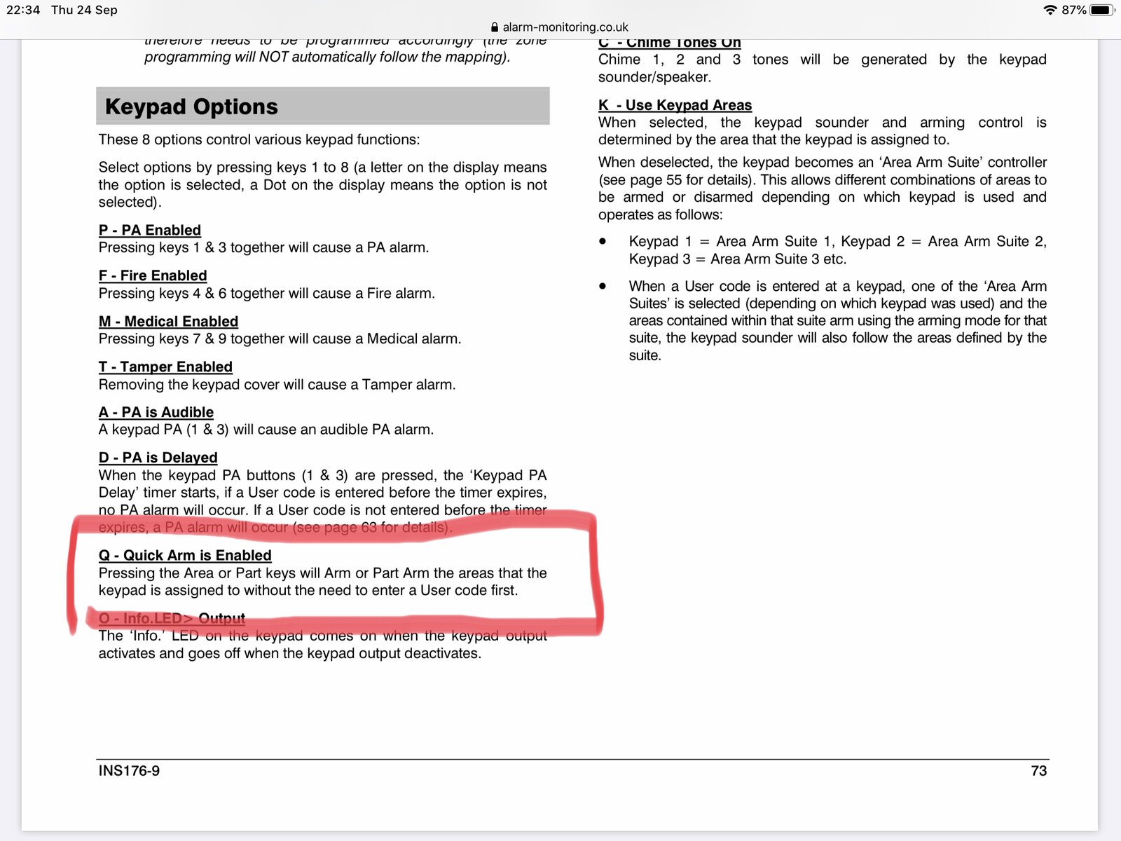

Hi everyone
Recently installed a Texecom Premier Elite Ricochet system, previously always fitted Galaxy panels where you can quick set by pressing A)
Is there a way of enabling this on the premier panel so the user doesn’t have to enter their code to set the panel?
Many thanks in advance
Matt
Enable it on the keypad settings, area gives full, part gives part 1 or area scroll up / down for the 3 part arms and yes
