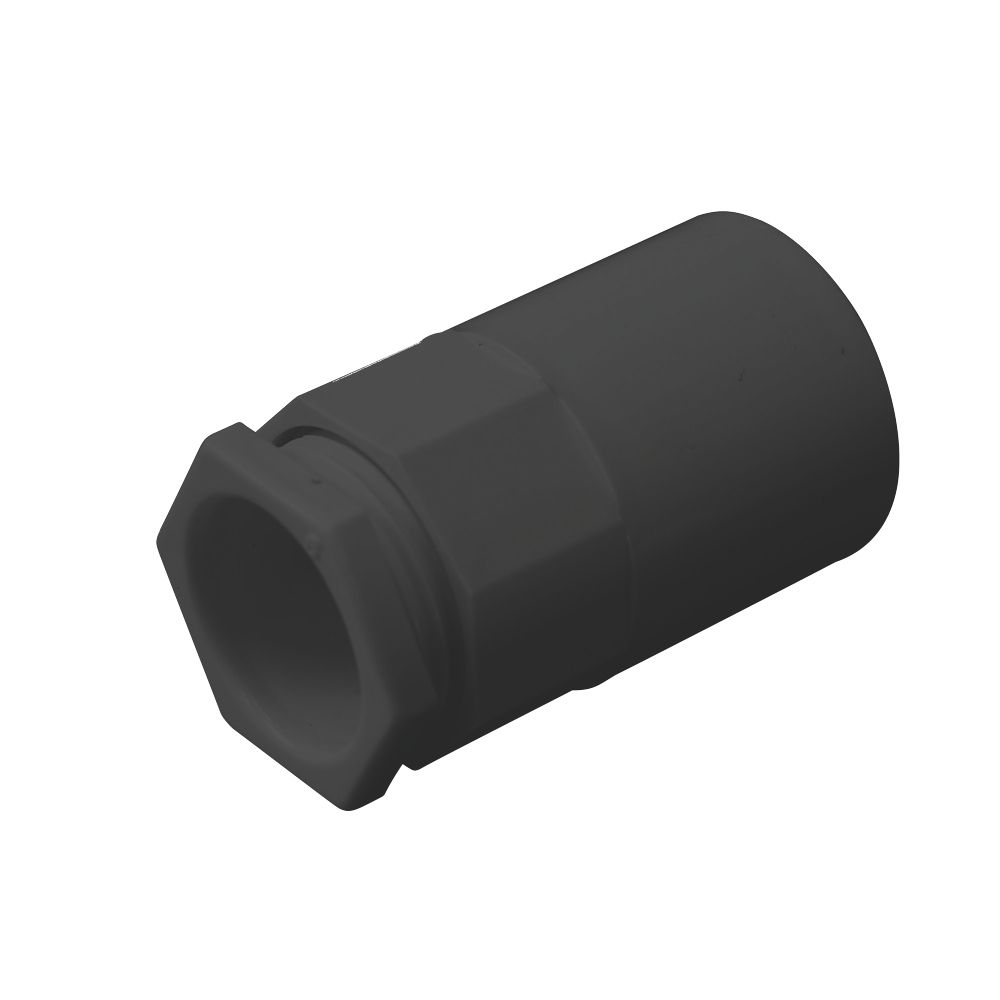

your unlikely to get a conduit to fit into them glands, standard pipe is 20mm and usually you fit End adapter, either male or Female
https://www.screwfix.com/p/tower-female-adaptors-20mm-black-pack-of-2/77225
https://www.screwfix.com/p/tower-male-adaptors-20mm-black-pack-of-2/64512
