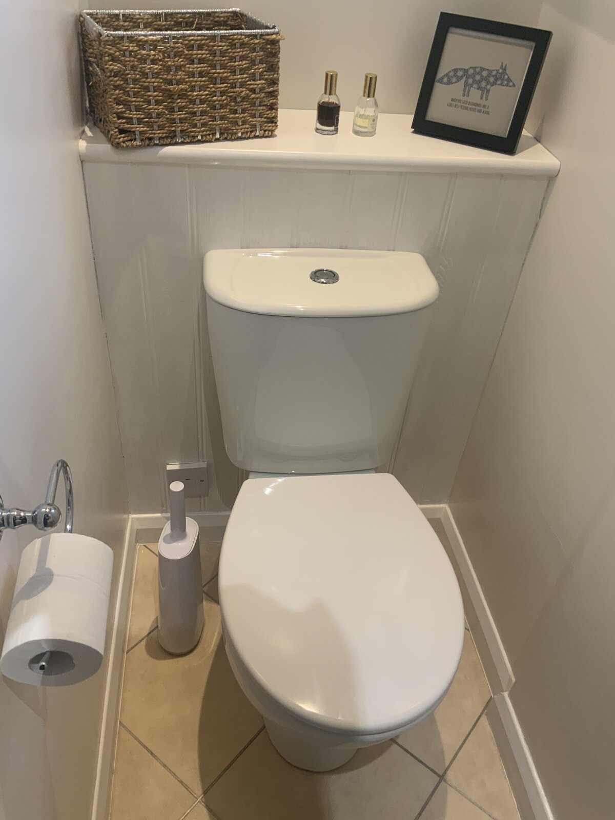

Our one in our downstairs loo worked fine for about 10 years until I stupidly threw a wodge of Kleenex tissues down it. They jammed it up and burnt it out because they don’t break up in water like toilet tissue. I fitted a replacement and that has lasted longer. I have the SaniSlim and that can take a WC and a basin (which we have) but it can also take a shower if required. It worked out a lot cheaper and easier to install than digging up my drive and breaking into the drain. Noise is negligible too as I boxed it in and added some insulation. Sound is less than our washing machine emptying. As said, for occasional use and if used properly, no problem.

we have a saniflo as an emergency understairs additional loo, because I otherwise couldn't keep the waste pipe in the ground because of a slope. It's been absolutely fine for 4-5 years. We do try not to use it for No2's but not sure what visitors do.....I did have to go in to it recently to retrieve a piece of toilet seat bracket I accidentally knocked in the bowl and flushed! no harm done and it was remarkably clean inside.
I wouldn't hesitate to use one again for personal use if I couldn't get a main drain in. Not sure I would ever want to be a plumber repairing them for joe public though........
