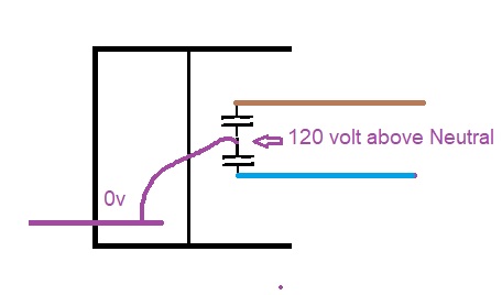

One possibility is something connected to the TV is "broken" ( maybe exporting higher voltages toward the TV ) and is damaging any TV that it connects.
a decent amount of ESD and other protection on an HDMI input:
Some equipment that does not have an Earth connection and a poorly designed power supply can capacitively couple a high voltage on the 0 volt of the electronic circuitry.
Since the Neutral is connected to Ground some where then the 0v from this item is 120v above the Ground of anything it is connected to.
This voltage is the cause of the weak tingle you can feel on some metal parts of laptops etc. There is very little current flow if the capacitance is small
Provided the other equipment's protection devices can safely sink this tingle current then things are normally OK.
But where the capacitance is larger ( poor design ) or there is a fault then the tingle current may be high enough the damage the equipment.
