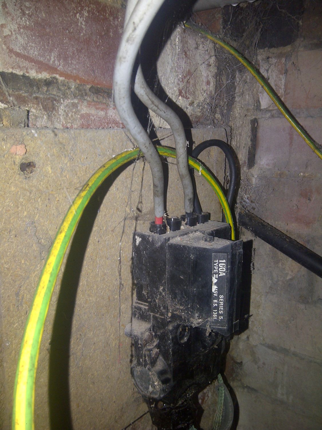

Are you sure your supply is 100A?
The service fuse cover may have 100A written on it, but that is the maximum fuse. Inside it may be 80 or 60A. Ask your DNO.
100A is the max for a single phase domestic supply. To go larger, you would need to ask for perhaps a 3-phase supply, but that’s several thousands of pounds to install.

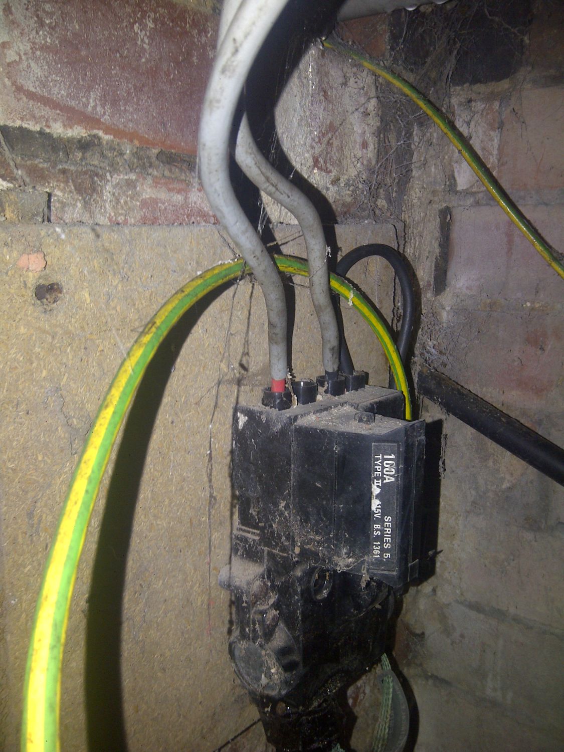

This is the power inlet. Does the 100A here refer to the fuse or max current for the unit?
