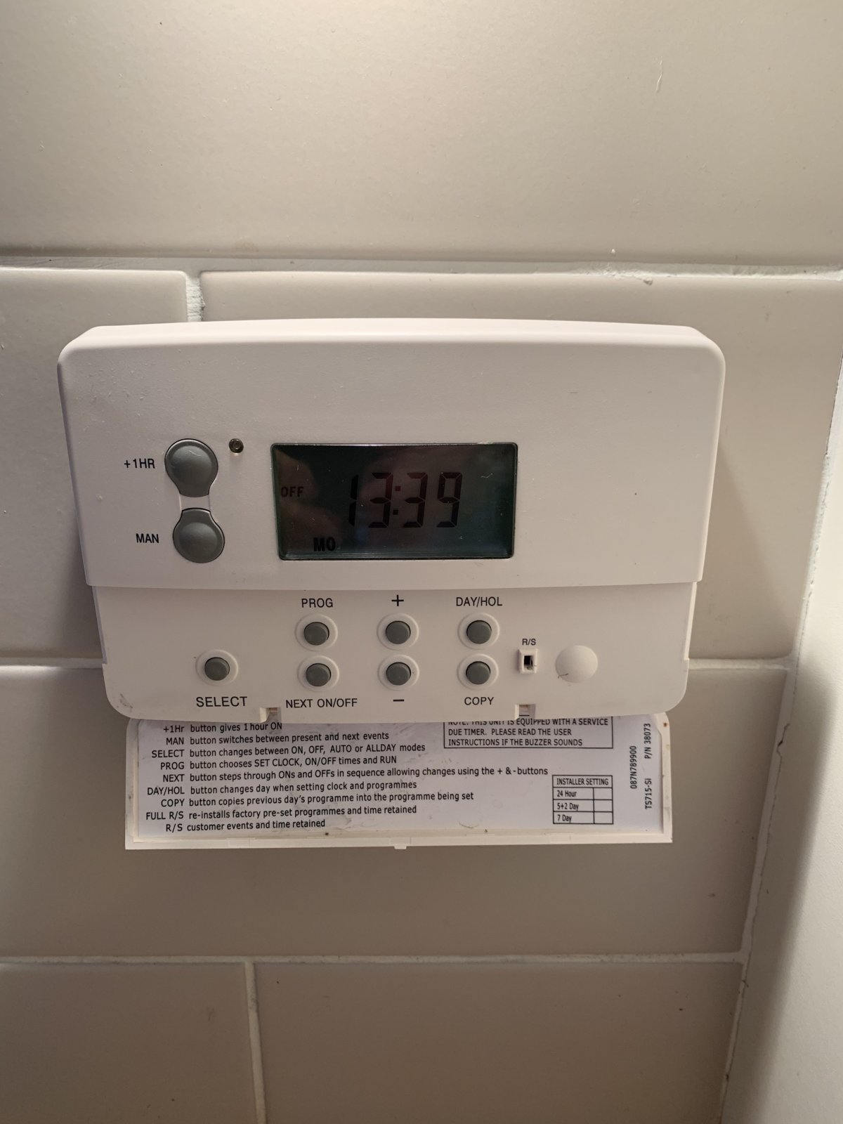

Danfoss ts715si

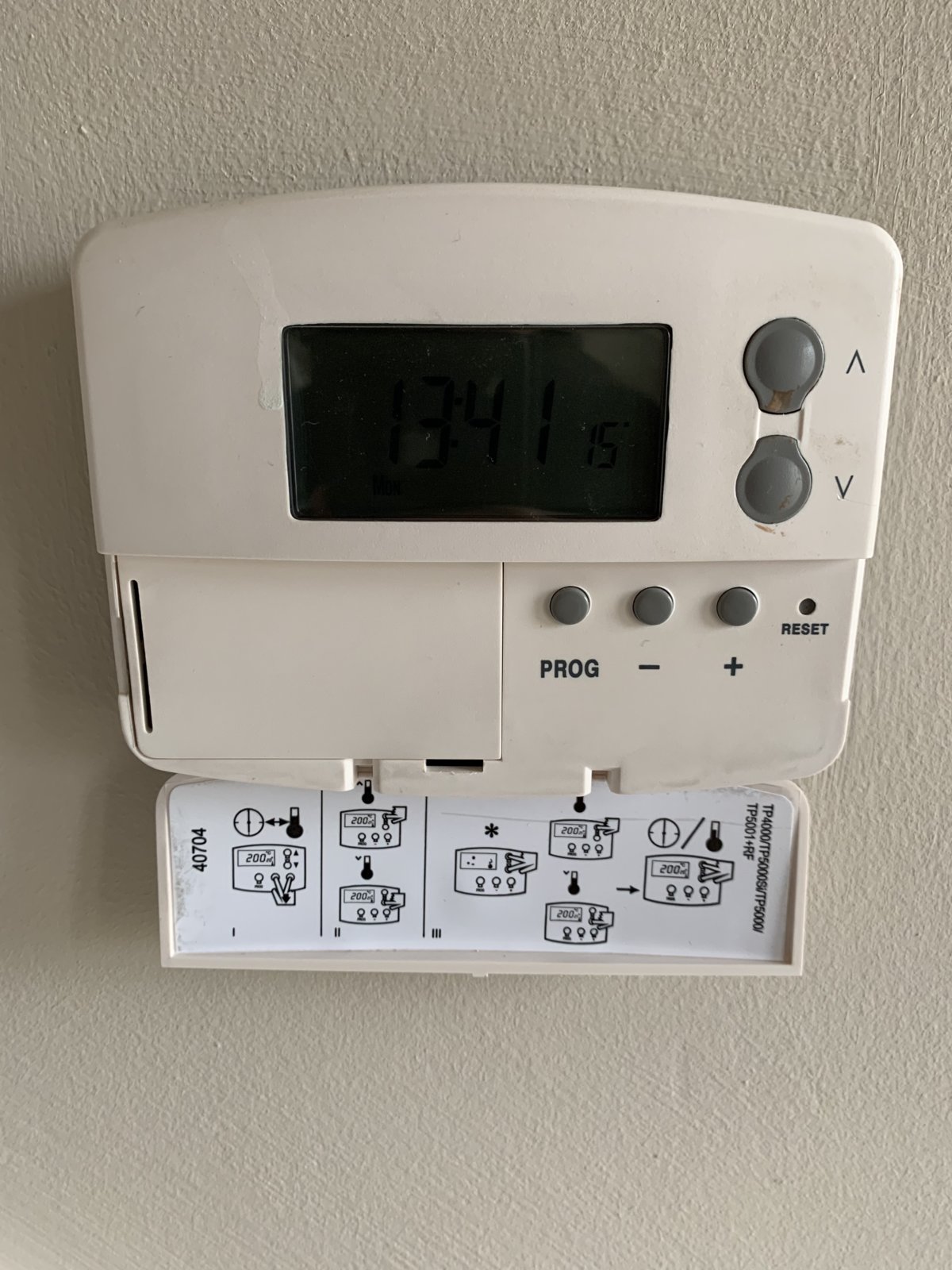

Danfoss TP5000 (x2 - One upstairs, one downstairs)
I'm looking to upgrade to the Nest Learning Thermostat 3rd gen, ideally the downstairs thermostat now and the upstairs later if that's possible.

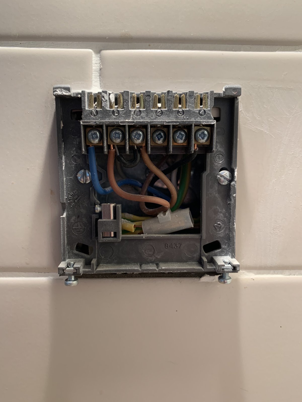

This is the Danfoss ts725, located in the kitchen by the boiler:

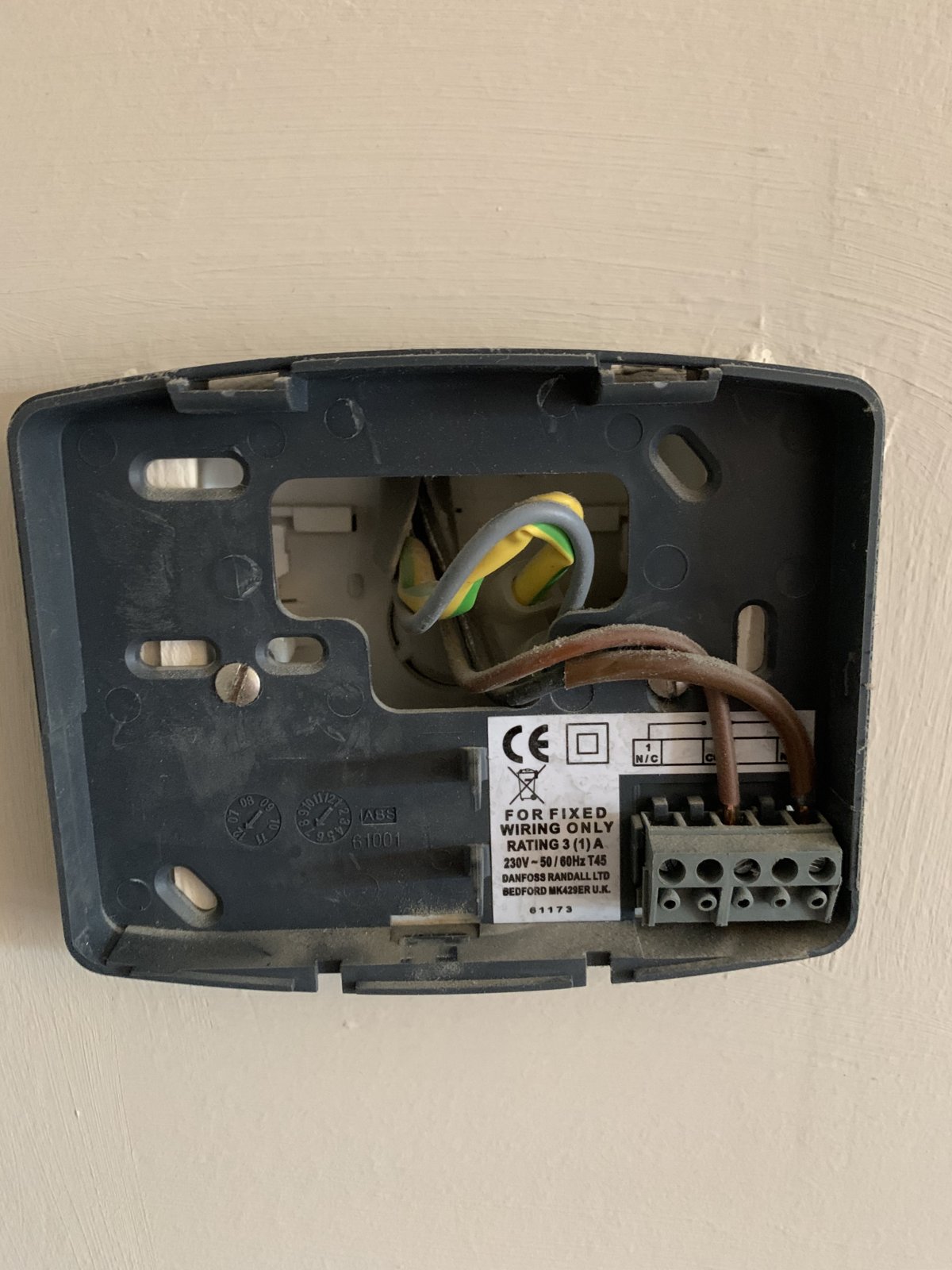

And this is the downstairs thermostat:

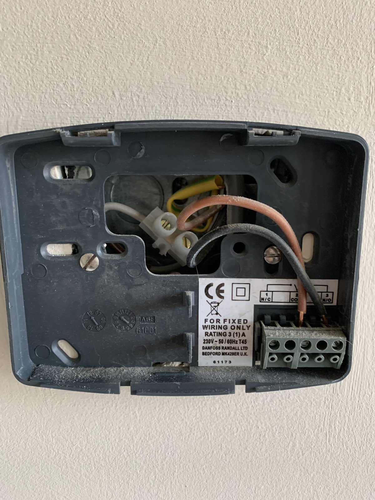

And this is the upstairs thermostat wiring:

So the TS715i is a timeswitch for controlling the hot water, and the two Danfoss TP5000's will be controlling the two heating zones.
You will need two Nest thermostats and two Heat links, one for one heating zone and the hot water, and the other for the second heating zone. (yes, you can do this one later). Then some modifications to the wiring will be required to bring the first heating zone and the hot water control together at the first Heat link. It's not just a matter of moving a wire from one place to another. You will need to be electrically competent and understand how all of your system's components work and relate to each other fully in order to do this. So, unless you are really skilled, because this will be pretty difficult to explain over a forum it's probably best left to a professional to install.

Whilst travelling home, I gave it some more thought and actually yours isn't too difficult after all :)
Locate the Heat link where the Danfoss ts715si controlling the hot water on/off times is (I'm assuming that is what it's for. If not, please advise what it does do) and move:
The blue wire in the 715 (N) to the Heat link (N)
The brown wire in the 715 (L) to the Heat link (L)
The brown wire in the 715 (1) to the Heat link 'Hot water common' (5)
The black wire in the 715 (4) to the Heat link 'Hot water call for heat' (6)
Insert a link between Heat link terminals (L) and 'Hot water common' (5)
Then transfer the cable from the downstairs Danfoss TP5000 to the Heat link. Connect the brown wire to 'Heating common' (2) and the black wire to 'Heating call for heat' (3)
You can wire the Nest thermostat to T1 & T2 to get the 12v to power it, or use a separate plug in power supply.
The upstairs Danfoss TP5000, can remain as it is for now.
