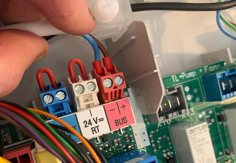

Looks like this on the circuit board. Just remove it if you have non-Vaillant controls.

To let you understand what the 24v link is, your boiler can use 230v switching from the external controls, or it can use 24v switching, whichever one you use when installing the other link has to be removed or the boiler always thinks an external control is calling for the boiler to come on, it is a simple job to remove the link , you may have read posts on here saying about having to be a registered gas engineer to remove the cover , in your case you dont as you are only removing the decorative case and not the combustion cover, but if you are not comfortable with that then that is fine leave it till your installer can get to you

yes you can remove the plug , but better if you just remove the wire and leave the plug in place in case you decide to go for different controls in the future, it is a ten min job
