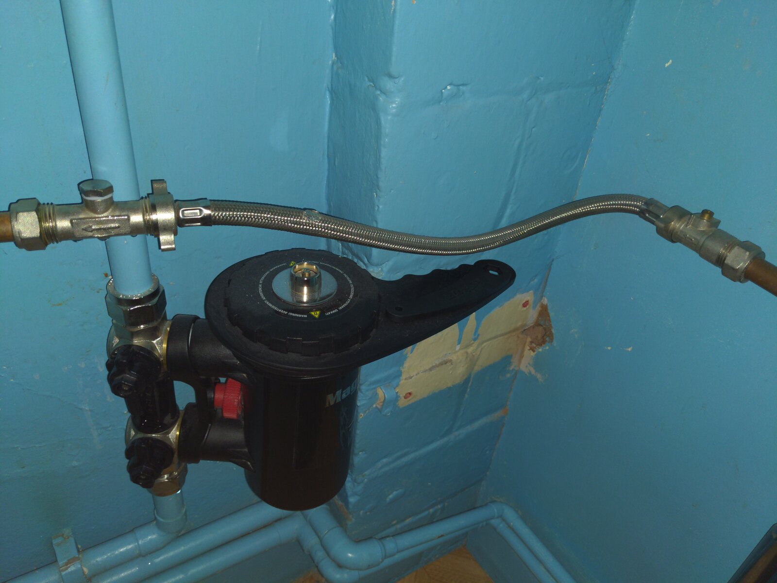

Denean Joined 13 Jan 2021 Messages 2 Reaction score 0 Country 13 Jan 2021 #1 My boiler screen is showing an f22 error and the pressure is low. Could the two things below be the bits that I need to turn? Attachments 16105389353355235322702638289987.jpg 180.8 KB · Views: 233
T terryplumb Joined 8 May 2017 Messages 9,538 Reaction score 2,396 Country 13 Jan 2021 #2 On the far right of your pic is the valve that you need to turn on. You need a spanner to turn it 1/4 turn. Usually has a plastic handle ,but your has been removed !
Denean Joined 13 Jan 2021 Messages 2 Reaction score 0 Country 13 Jan 2021 #3 All sorted now! Thank you so much!!
C cross thread Joined 8 Sep 2005 Messages 2,601 Reaction score 692 Location worlds end Country 13 Jan 2021 #4 No links showing, it’s the two grey handles
