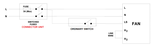

Hi all,
I am wiring a Vent axia pozidry fan, and am I right in assuming if the spur I am using has it's own switch, I can just link the L to the LS at the fan?
Many thanks in advance.

What are you trying to achieve?
The device is a Switched Fused Connector Unit; the cable is the spur.

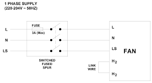

Hi thanks for your reply,
I basically want to take from the normal (ring main) wall plug to the switched fused spur and then to the fan. 3A switched fused spur is required, so device can be turned off with the spur. So I have supply of L N (E) that go into the switched fused spur that then goes into the FAN which requires L N LS (E).

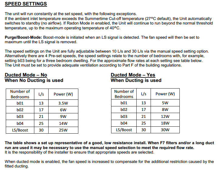

LS on fans normally refers to the timer connection but as far as I can see on this fan it is a speed boost function. Is that correct?
Therefore if you connect L & LS it will be on high speed all the time.
Also the diagram does not show the correct Switched Fused Connector Unit (the cable is the spur) as the fuse only protects one of the line(live) wires.
You will need to do this:
Thanks much appreciated, yes the instructions are very vauge, the speed boost is controlled internally, and there is no timer, so I'm not sure what the LS is for, apart from jsut been an additional way to turn the device off.
I have only read the instructions.
It looks like the internal settings are to set the permanent speed and the LS when switched on boosts it until switched off?
Either way my diagram is the correct way to wire it.
