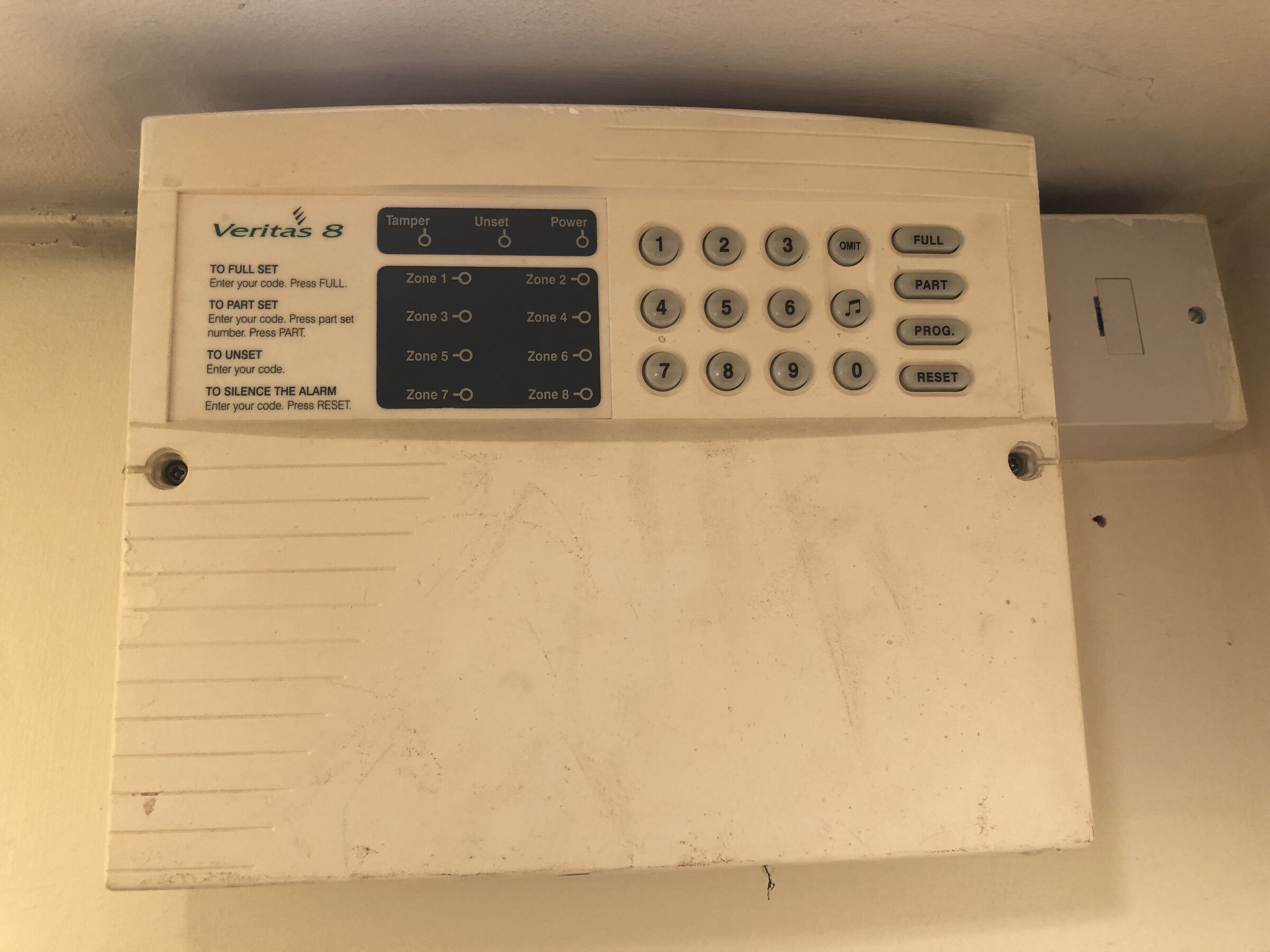

Hi all,
I had to open the veritas 8 main panel to check which battery was needed, having noticed there wasn’t any battery in the unit and is probably connected via the mains. I switched the power back on.
now the unit has gone into tamper mode and always bleeping.
I’ve entered my 4 digit code but it still doesn’t stop.
Any suggestions on how to fix this?
thanks
Default user code is 4321
Battery wise 12V, 7Ah if no keypad built into the main panel.
if the unit has a keypad built in then it should say veritas 8c (2.1Ah)
Veritas 8 12V 7Ah max battery sizes that will fit
These are the picture of the units
