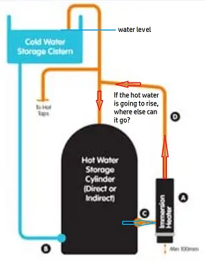

In Ulster they have another method, the Irish are very clever, they fit the immersion outside the main tank and it is arranged to heat water from the top down, so the longer it is left on, the more hot water you get, called the Willis system, the big question is if a main land plumber has the skill to set this up? However with the Willis system having a timer on the immersion will control how much hot water you have rather than how hot the water is.

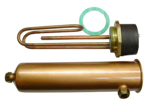

This shows B and C the two immersion heater positions so one can select how much is heated, and this 1711270020795.png shows the Willis system, with external immersion heater 1711270113936.pngbut the big question is if it's all worth it? I paid a lot for my solar panels and battery, and I am not sure it they will ever pay for them selves, my electric payments have gone down from £119.70 to £81.35 a month direct debit, that may not be the real change in how much I use, but £460.20 a year it will take 26 years to pay back, that will make me 99 years old before it pays for its self.

I must admit that I`ve never heard of the Willis System. Dare I envisage that it is, in effect, a very small cylinder feeding a larger (say standard cylinder) with it`s own on board immersion heater and therefore in addition to or alongside (thermally) whatever method is heating the main cylinder?.
What are the advantages/disadvantages?
The first that comes to mind is heat venting loss via the cylinder overflow into the cold tank area - obviously if the water level remains as should be it will not send hot water into the tankdirectly but that warmer water into the tank area will heat the air above it to the tank area which may be uninsulated too. Only a minimal effect anyway but I see the whole concept as heat loss prevention both to the mini-cylinder and that overflow pipe.
Not nit picking just interested
Can't see how a Willis system is any different than an immersion heater installed directly in the tank at the same height the Willis system takes out from the main tank

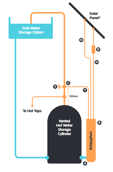

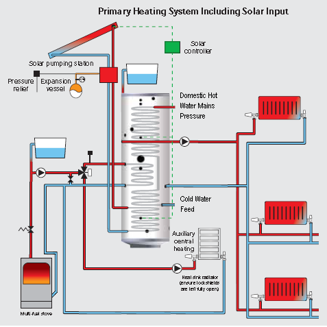

I have also been looking back at old thread and also looking at the solar variant 1711360327008.pngit seems there are two controls, here is a valve looking like a gate valve at the base 'A' (¾ inch regulating valve), and 'E' at top is called a temperature sensor, I was looking at the idea of using it with the iboost+ but I have failed to find a plumber in mid Wales who knows how to set one up.

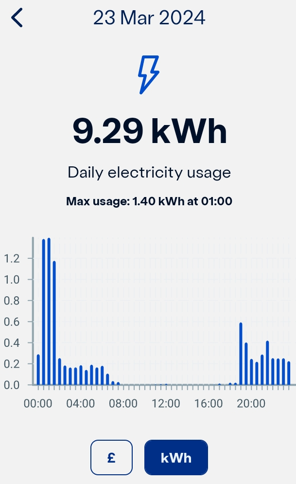

The problem does not end there however, what we need to work out, is will it have a short enough pay back time to be worth all the effort? Today at long last my app showing electric used has up dated. 1711360924185.png However clicking on £ and it says not available, and since 0 to 8 is a different tariff to 8 to 24 rather useless. The 0 to 8 is higher than 8 to 24 so if I look at ½ at each rate I get £2.50 also adding the standing charge, it will be less than that, but the point is £1.91 for actually electric used, removing standard charge is the maximum I can save in a day by reducing electric use. OK that's £700 a year, but realistically if one can save £200 a year that would be rather good going. One is looking at £57 just for the immersion heater, by time fitted it will be well over that, likely it would take a decade to pay for its self, and by then there will be a whole new load of energy saving items on the market.
So start point is what is used now in electric over a typical day, less or more than me, and what's the split during the day? There is no point looking in isolation, if a light bulb for example produces 40 watt hours of heat, but you heat the house with electric, then selecting a light bulb which does not produce that heat, is no saving, as the heating system will need to produce 40 watt hours more. The same applies to any other heat source. If you use an airing cupboard to dry clothes lagging the tank will mean clothes do not dry as well. Block up a vent and house gets more humid, fit a heat recovery unit and one retains more heat without an increase in humidity.
