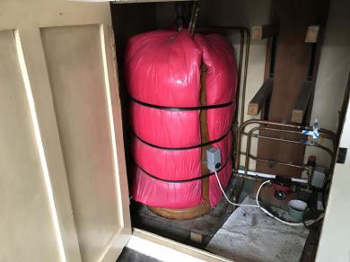

I'm renovating an 1880s semi-terraced 5BR house. Much of it is still original, with some rooms lacking power outlets. One thing which has been "updated" has been the installation of radiators, and a combi-boiler (located in a back stairwell on the ground floor, see photo).

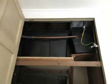

However, there are still a hot water tank and cold water basin which are in a cabinet in the corner of one of the bedrooms and happen to be taking up quite a lot of real estate on the first floor (roughly in the middle of the house).
Ideally, I'd like to remove these two tanks and demo the structure so I can use the whole room they're in, but this is new territory for me, so I'm a bit unsure about what my goal should be here in terms of renovation. Is there an option to replace the boiler so that hot water can be "tankless" and relocate the cold water basin to the attic? Should I try to relocate both? Am I stuck with this configuration? Usage will not be terribly high - we will have 4-5 taps in the house and two toilets but only one bath/shower combo, so potentially will not be using that much water at a time. All tips welcome!
