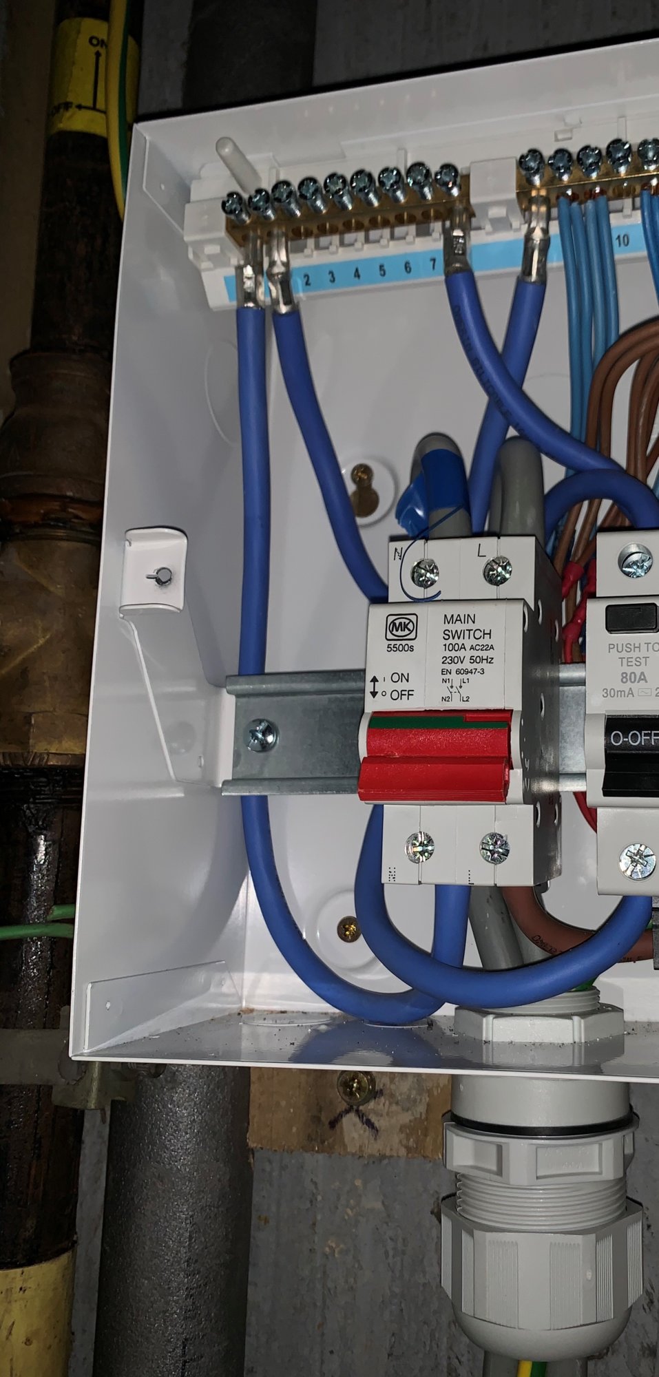

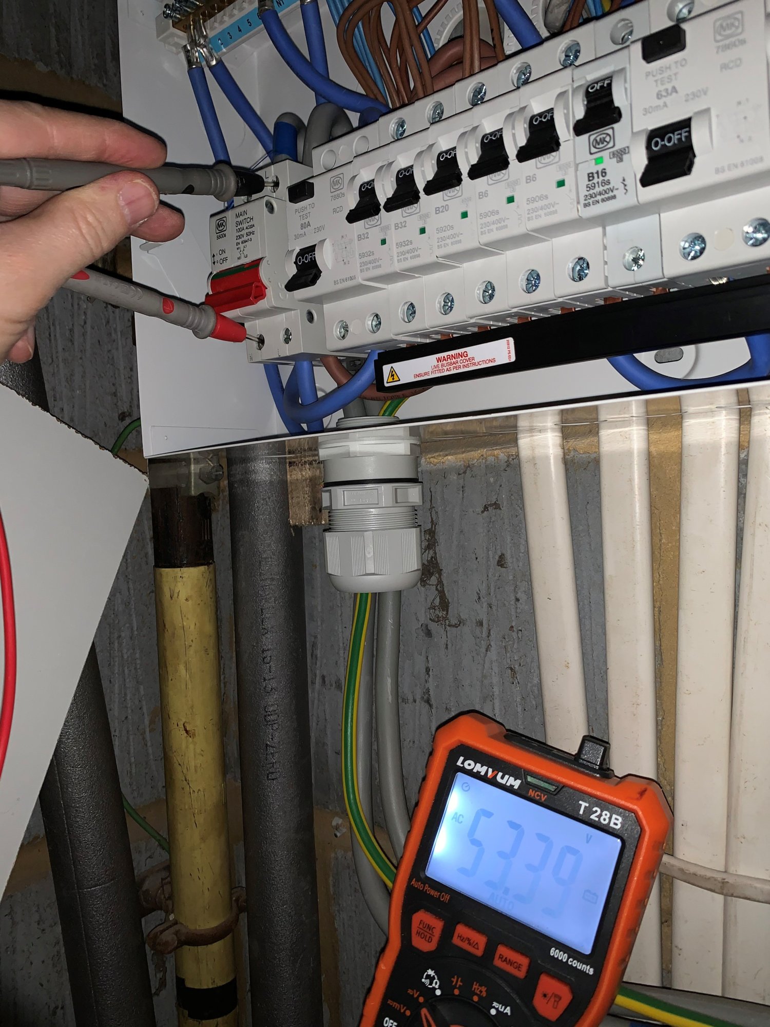

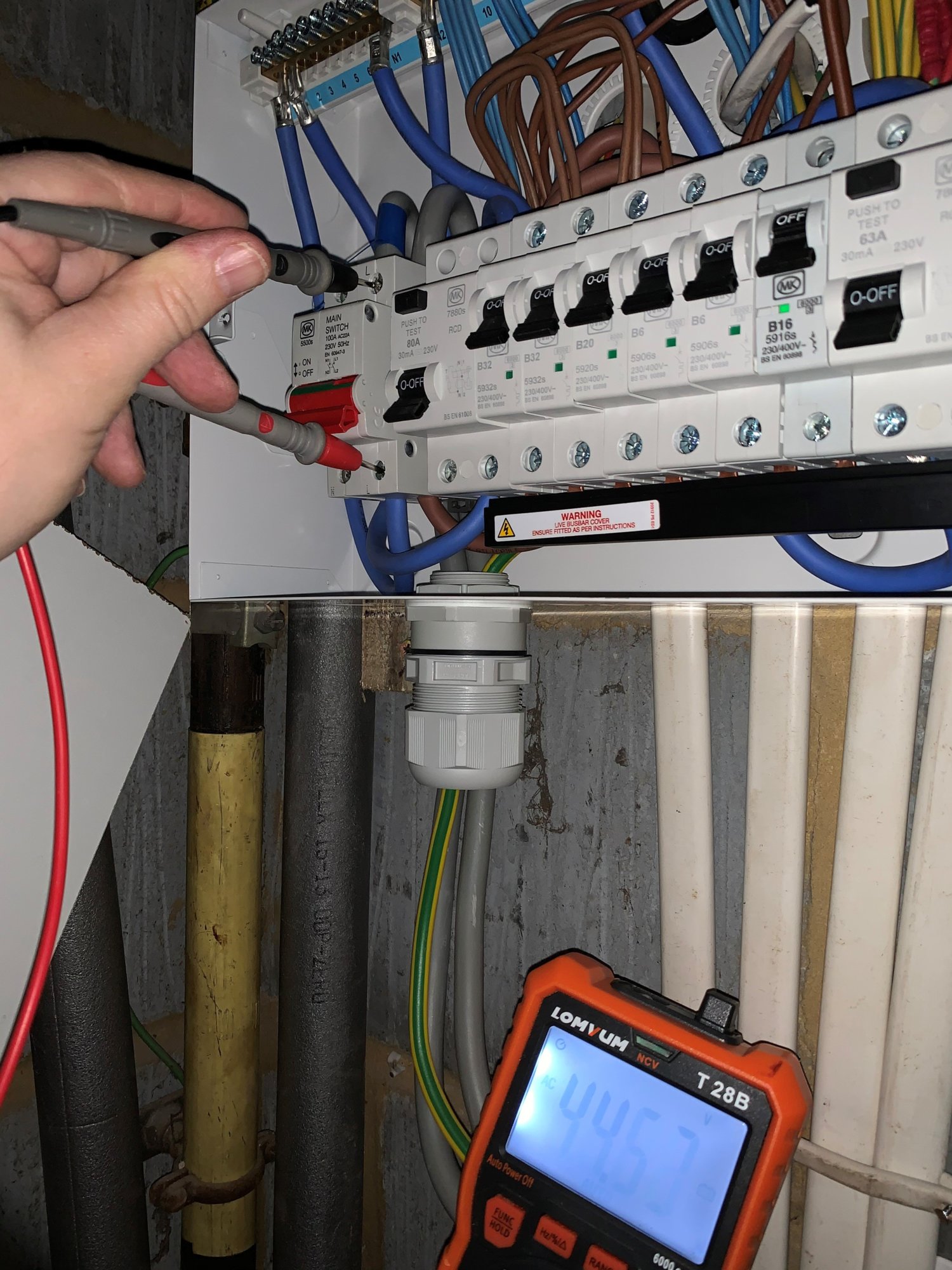

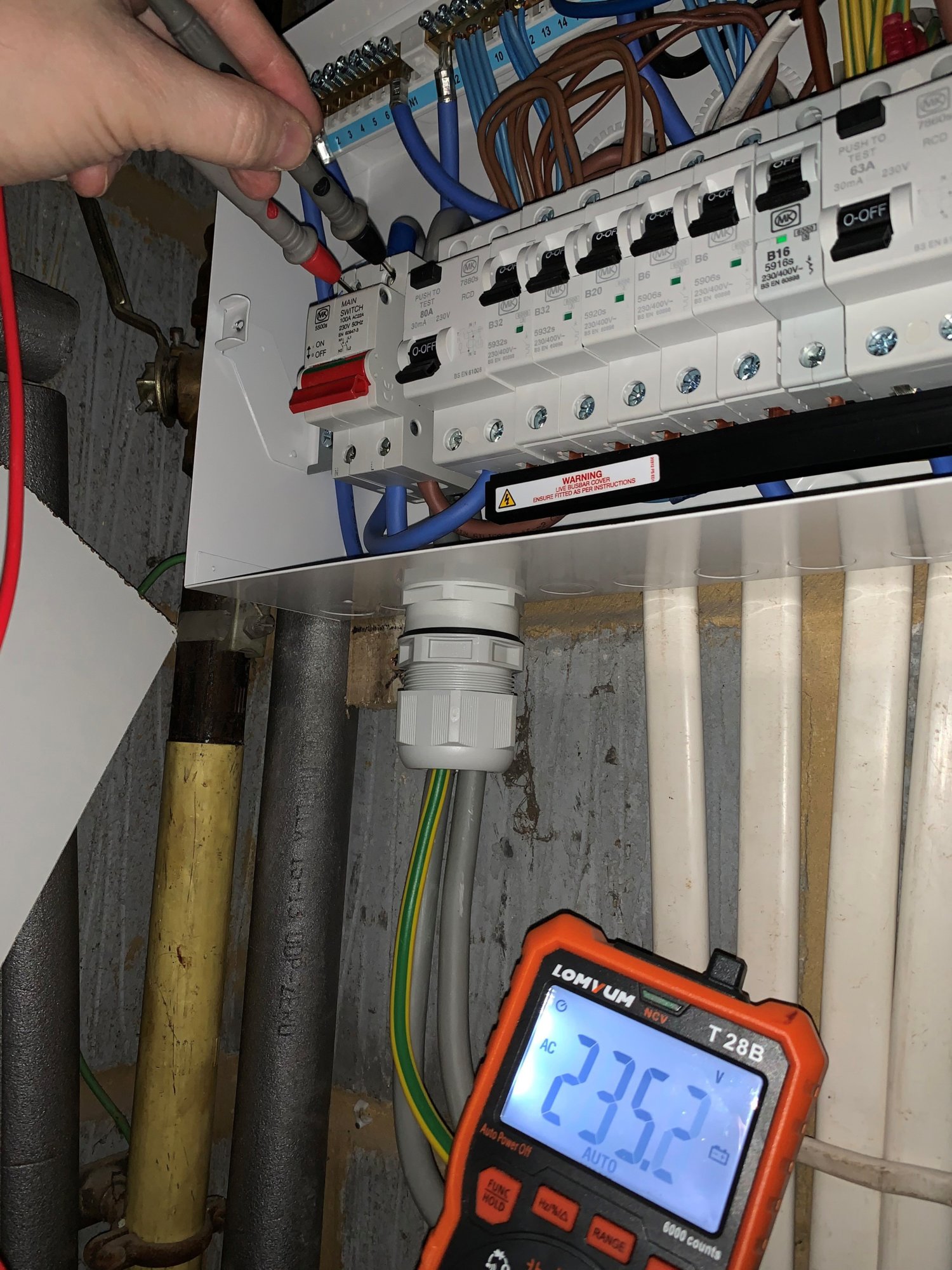

Hi
In my (new) consumer unit, there are 3V across the Neutral bar and the earth bar, when the mains is off. There is also 53V across the mains switch from L to N when it's off and 44V between the line supply and line out. Is this normal when the mains switch is off? Isn't N and Earth connected together at some point therefore should be 0 volts difference?
Could this explain why my LED bulbs never switch off but only go dim when switched off via a wall switch?
See pics for actual readings - does anyone know what the readings should be in a good installation?
Thanks in advance...
[GALLERY=media, 103741]235 by Xerxel posted 3 Jan 2020 at 11:21 PM[/GALLERY]
[GALLERY=media, 103740]53 by Xerxel posted 3 Jan 2020 at 11:21 PM[/GALLERY]
[GALLERY=media, 103739]44 by Xerxel posted 3 Jan 2020 at 11:21 PM[/GALLERY]

[GALLERY=media, 103743]MainsSwitch by Xerxel posted 3 Jan 2020 at 11:21 PM[/GALLERY]
[GALLERY=media, 103742]ConsumerUnit by Xerxel posted 3 Jan 2020 at 11:21 PM[/GALLERY]

When you put your meter across the open contacts of the L side of the main switch, your meter forms part of a potential divider between the 240V mains and "earth". the circuit basically goes "L - meter - live cores in the installation plus N cores via any loads that are turned on - various capacitances between L&N cores and earth cores (correctly, Circuit Protective Conductors (CPCs)) & any earthed metalwork (eg pipework) - earth. As these capacitances are small, the voltage you see will be significantly lower than teh 240V mains supply.
When you measure across the N side of the switch, you are again measuring a complex system - but there should only be capacitive coupling between the L meter tail and any cabling that runs close to it (should be negligible).
And as above, when you measure between your N & E bars, the N is disconnected from the supply neutral, and hence from the upstream point (typically in the service head) where the supplier's PEN (Protective Earth & Neutral) conductor is split to separate E & N conductors.
TL;DR: As already said, the readings you have got are meaningless and of no relevance to your other problems.
