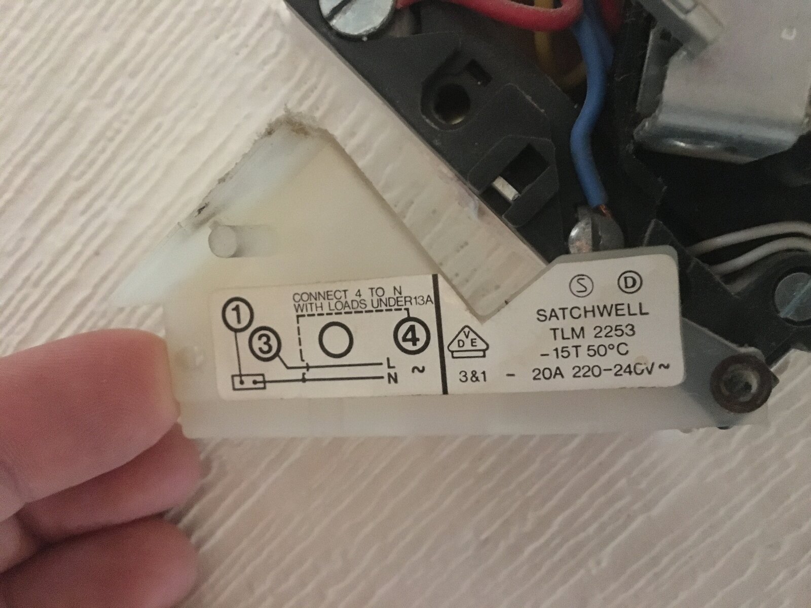

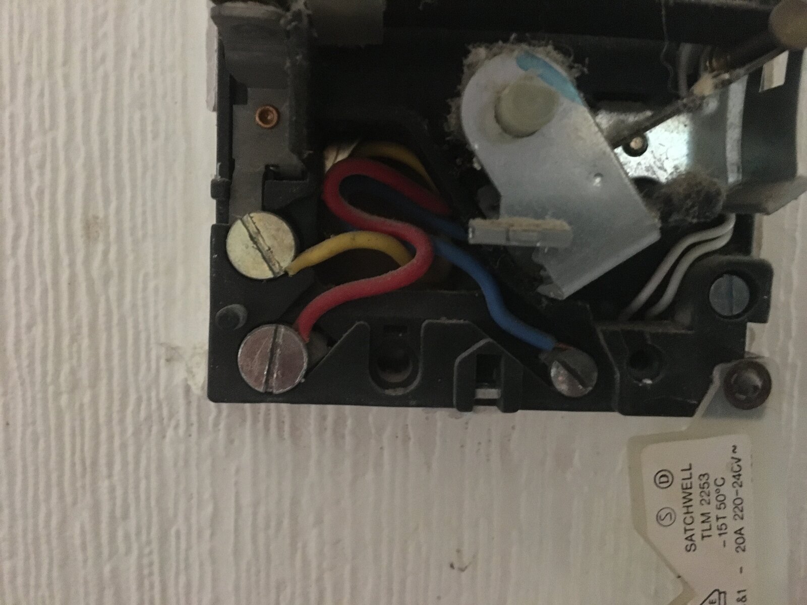

Looking to upgrade our 30 year old+ room stat with something digital and programmable. Here is the current wiring set up.
Is this just switchable with any programmable 3 wire stat? Any recommendations of which models are good and reasonably priced would be welcome. Looking for something with 7 day programmable with the ability to reduce heat overnight etc.
Yes, live, neutral and switched, so quite a lot on the market. I haven’t worked with that many, but I know to steer clear of Salus. You can even go for a 2 wire battery operated as well, ditching the neutral wire should you wish (just terminate it safely if you do this).
