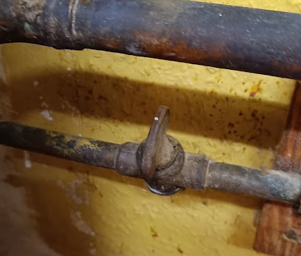

M munrobasher Joined 7 Dec 2023 Messages 3 Reaction score 0 Country 7 Dec 2023 #1 Isolating a central heating boiler but the gas is already off. If you were a betting person, is this tap off or on? It rotates 90 degrees.
C cross thread Joined 8 Sep 2005 Messages 2,601 Reaction score 692 Location worlds end Country 7 Dec 2023 #2 Off

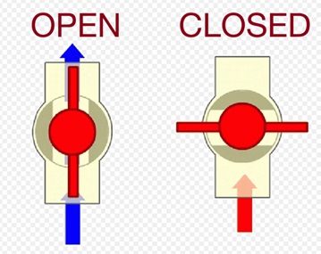

stem Joined 20 Jul 2005 Messages 7,963 Reaction score 2,376 Location Nottinghamshire Country 7 Dec 2023 #3 They are off when the tap is at right angles to the pipe as yours is. When on, they are parallel to the pipe.
